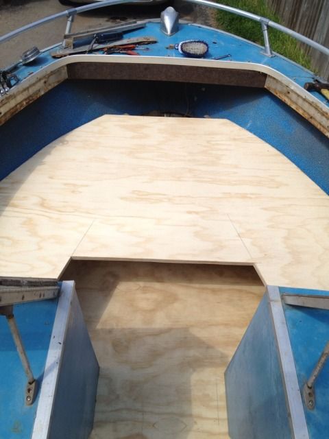

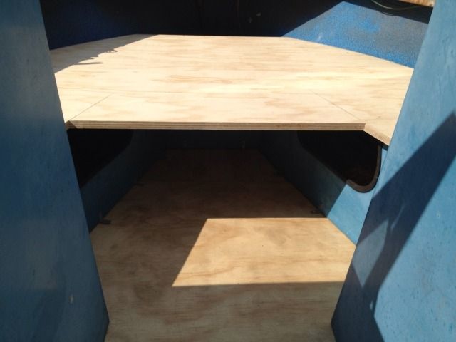

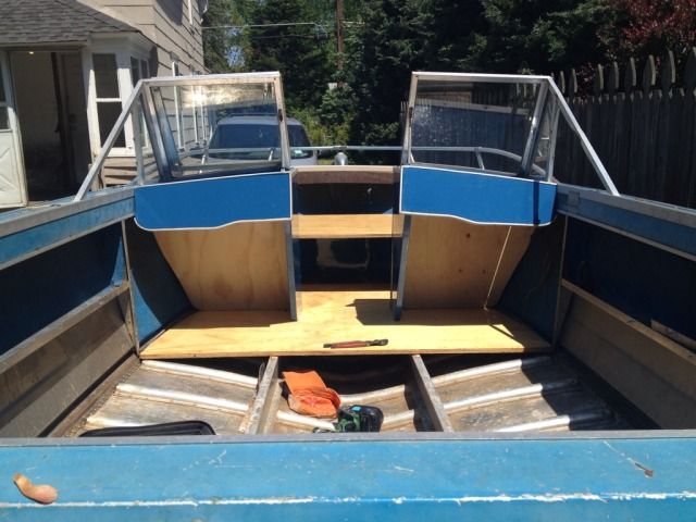

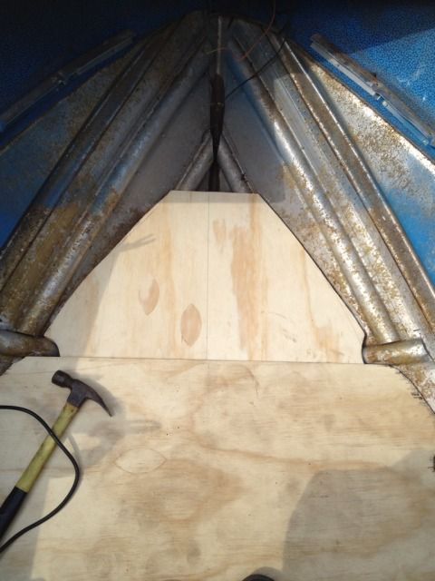

Last piece of floor cut
Dry fitting the casting deck
I put the oem bow supports under the casting deck. It won't allow me to mount the trolling battery in the front of the bow, so I'm going to have to make new supports.

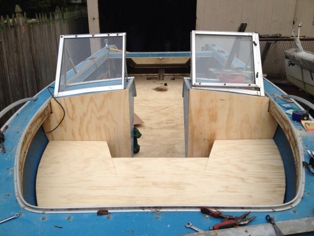

Just finished the back of the consoles and refitted the casting deck. Still need a couple supports under the casting deck(esp where the pedestal seat will be placed), but I'm pleased with my progress so far.

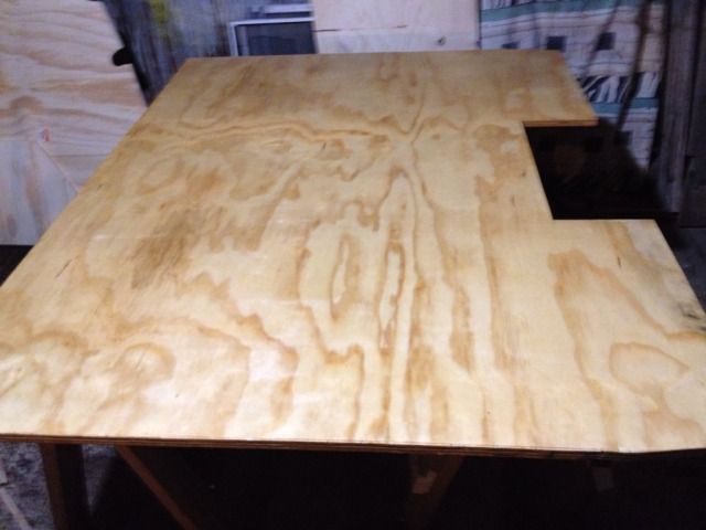

More progress today:
Had to do some more tweaking to the bow floor(squeaked). It's all good now.
I took out all floorboards and consoles so I could get started on applying the Spar varnish. The floor was a very tight fit, so removing them was a bear. I ended up taking a 1/4" off each edge to make the reinstall a bit easier.
Sanded all boards with 80 grit sandpaper to give the varnish something to grab.
I've got the first coat on all boards. The plywood sucked it up like a sponge! :eek: The ply was dry in 15 minutes.

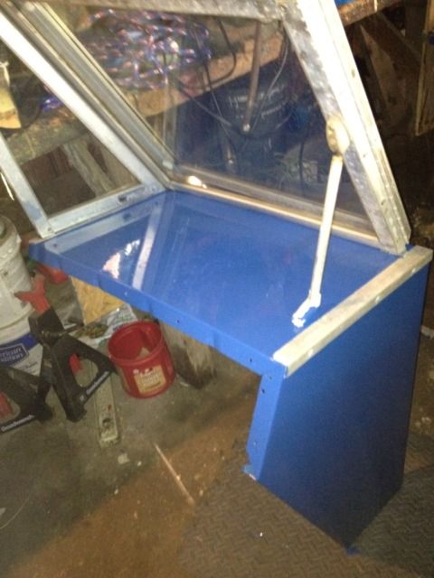

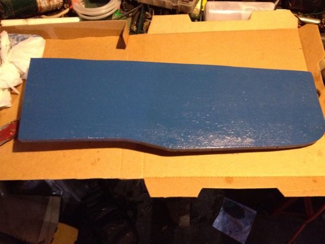

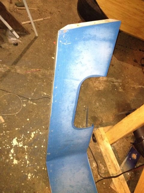

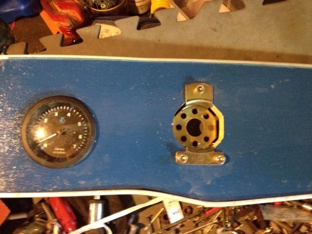

Cleaned up the consoles and started painting the sheet metal. Got a coat of paint on the dash panels too.

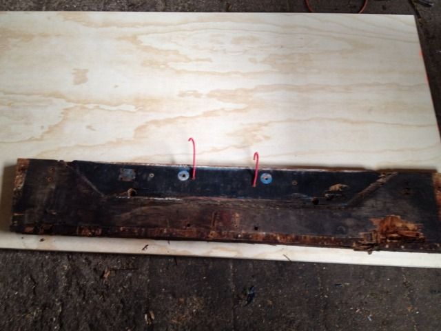

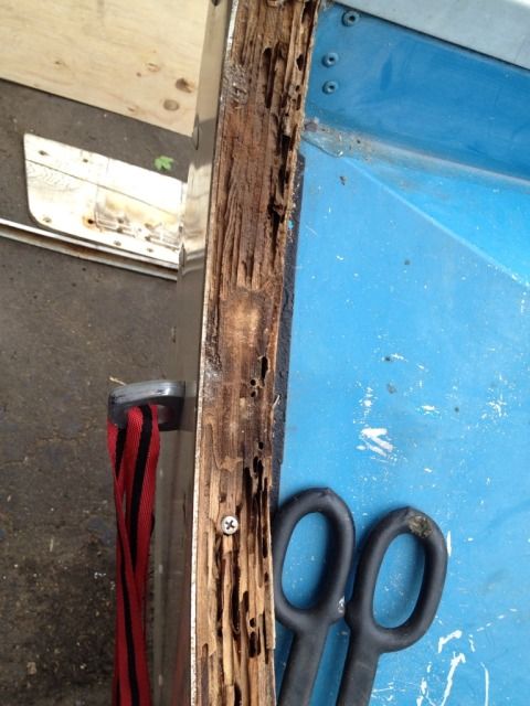

THE TRANSOM IS OUT !!!!!

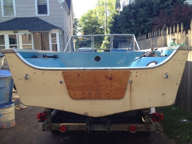

After poking around the transom...it was obvious that it needed to be pulled. The center was still strong, but the sides were turning to mush.
Last night, I sprayed any rusty bolts with PB Blaster so I wouldn't have to fight with them today.

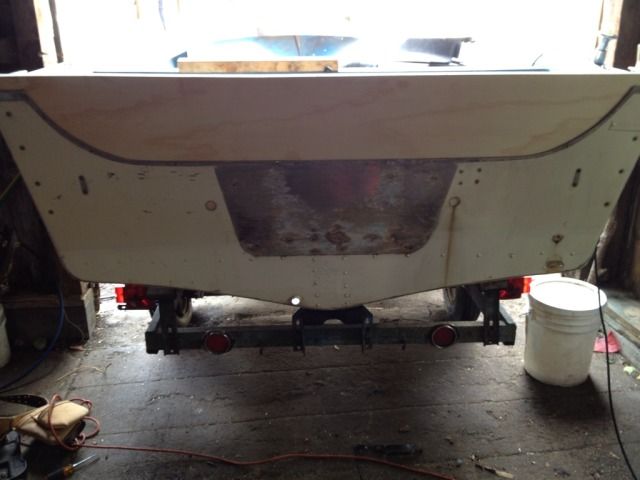

Drilled out the corner caps and used a dremel tool with cutoff wheel to cut the aluminum back
All of the screws, bolts, etc came with incredible ease. There were a handful of screws under the splashwell that just spun and wouldn't back-out because the wood behind them was too soft.
My first attempt at lifting the transom out failed because I forgot to take the drain holes out. :facepalm:
I ended getting my son and his friend pull the transom up(from behind the boat) while I levered it out from inside the boat. It came out in 3 pieces

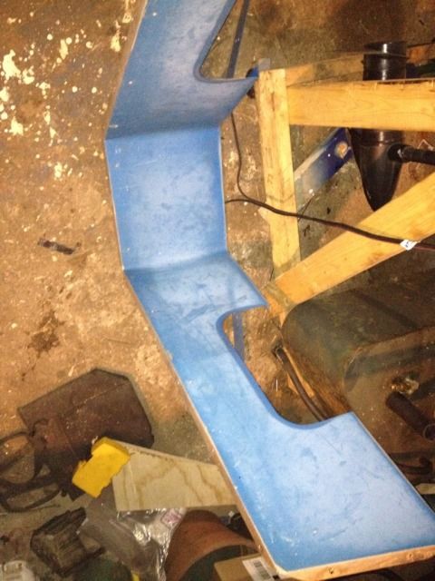

I put the pieces together and used it for a template. I cut the basic transom shape out and put the wood back in the transom and traced the final shape
Finally got the pieces cut and glued. Will start varnishing it tomorrow. Probably 4-5 coats.

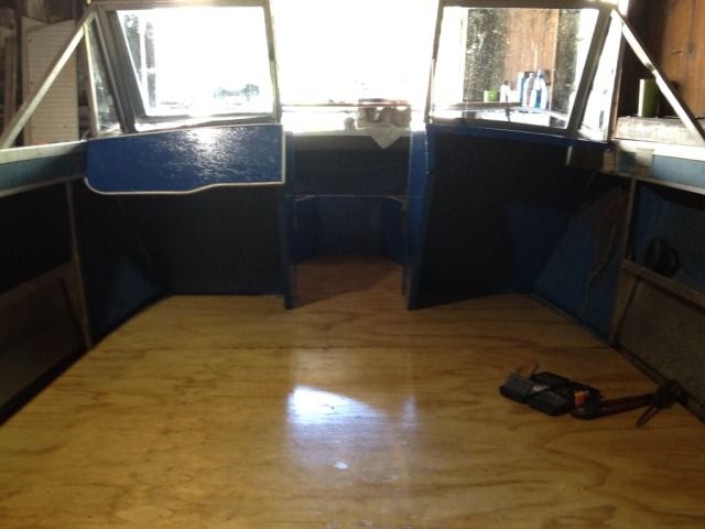

I cut down all the floor panels. They now land on the end of the ribs(right where they're supposed to). I put the last coat of spar varnish on the backside of all the floor panels. Tomorrow, I'll finish the last coat on the top of the panels.
Put a second(and last) coat on the dash panels.
I also cleaned up the bow framework(I've decided to use it, instead of making something else) and painted it. I'm using the roll and tip method....it's very easy and the finish comes out very nice.

Consoles are done.

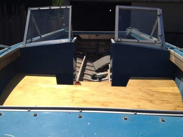

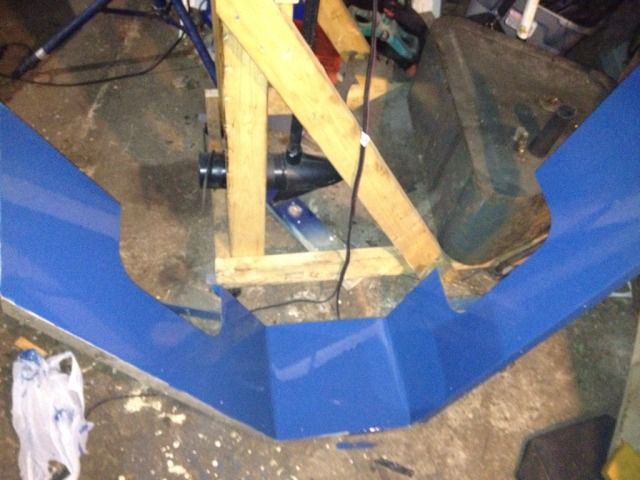

Most of the painting done.
Test fitting the consoles and bow pieces...

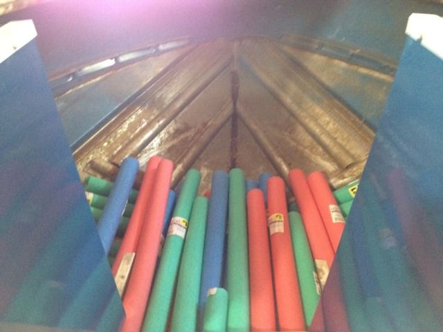

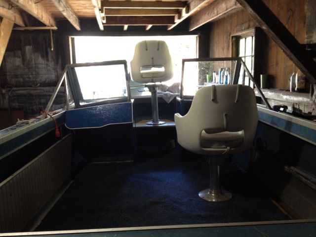

Noodles! I've used 35 noodles from the console to the bow. Got to search for more noodles tomorrow.
Consoles and bow pieces are all bolted/screwed in now. Main deck and floor under splashwell won't be screwed down til I get the rest of the noodles. Probably going to need 40-50 more.
Temporary seats(until I can afford better ones)
The carpet is the stuff that came with the boat. It's temporary also.
