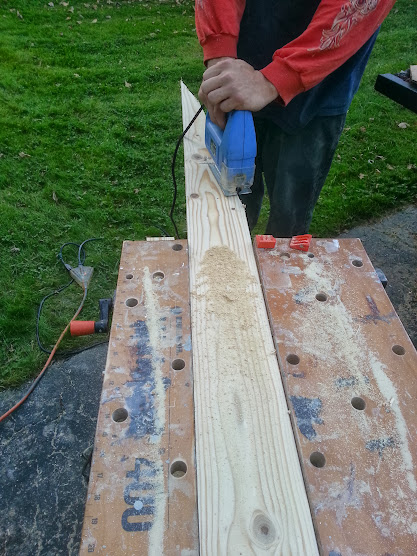

After some lawn mowing, gwpjr and I began to lay out the forward stringers:
He was scribing the profile of the hull in the pic above. Then they got cut and smoothed with the disk sander:
And rounded over the top edge with the router:
These stringers are over 7 feet long. The forward three feet of them curve inward, so we created kerfs nearly half the thickness of the material every 3" along the curved portion.

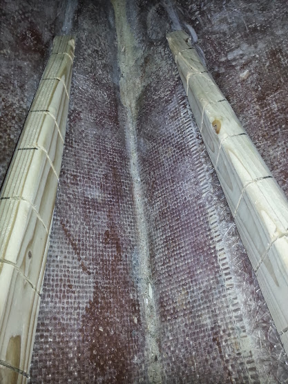

Good lookin' wood work GW, you gonna fill those kerfs with PB after you bed the stringers in and before you lay them up?

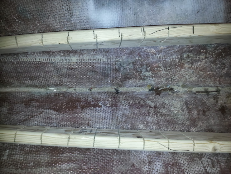

Before committing them to a coat of epoxy, we clamped them around a couple of pieces of lumber cut to size to hold them in place and test the curve:
I've coated them now with a liberal coat of epoxy and we'll try to bed them tomorrow.
Thanks. Absolutely.
Wait til you see the rest of the stringers. This thing had two 3" tall 2" wide stringers originally in this area. Needless to say, it'll be beefier afterward.

Re: 1981 Bayliner Victoria 2750 - Restore or Bust
Kerfs were a good idea..nice saturdays worth of progress....
