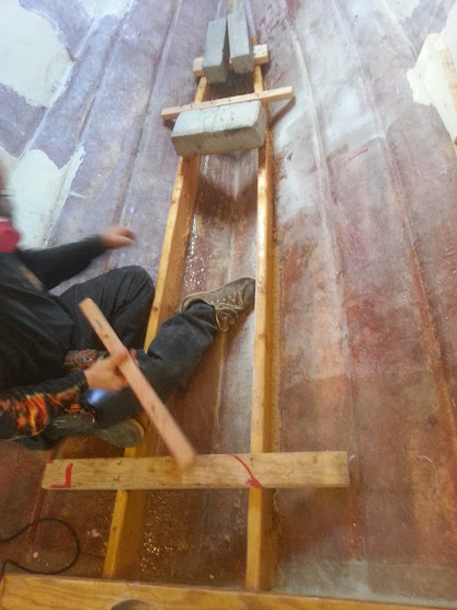

Then I glued the plywood core into the hatch skin, and rigged up the worlds ugliest clamping rig to bring it flat. I got enough ooze to go all the way around the edges and fill the gaps and all hardware mounting holes.
