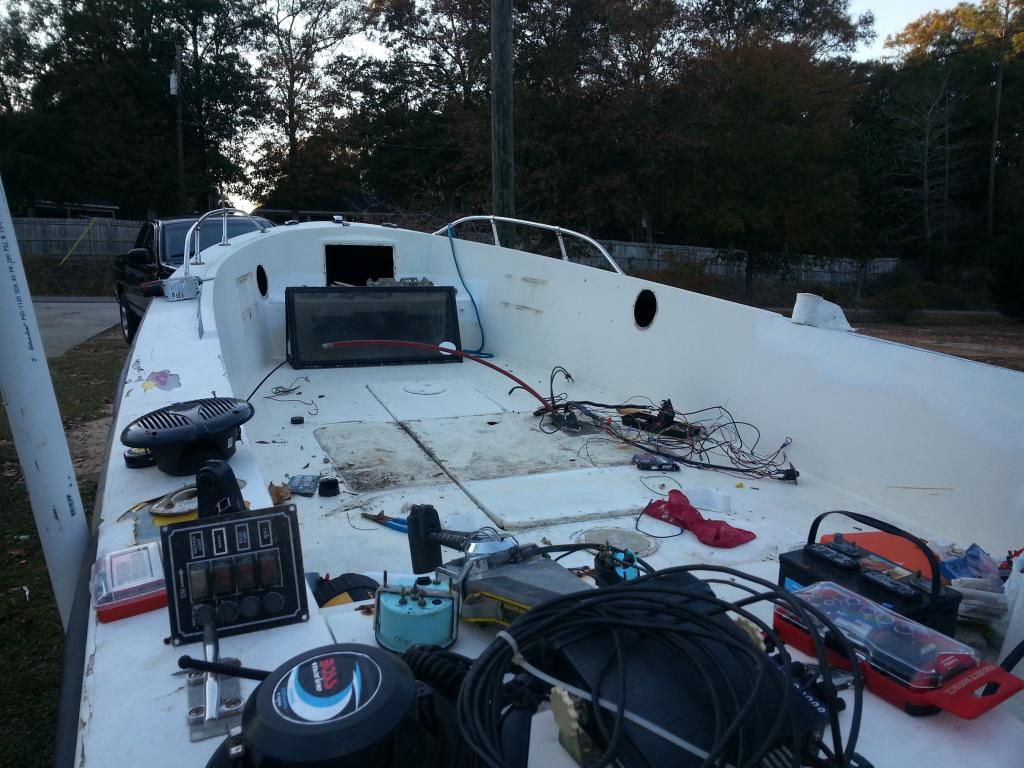

so I have decided that I am going to roll the inside of the boat. Have no experience spraying and really no means to. Any advice before I start this. I stripped everything out today going to get ready to start filling holes and patching a couple of places on the gel coat. do I need to thin paint to roll it on? and if so what do I need to use?
Woodonglass
Dec 29, 2009
25,929
Nope no thinning required. Just wipe everything down with Acetone prior to applying the paint. What paint did you decide to go with?

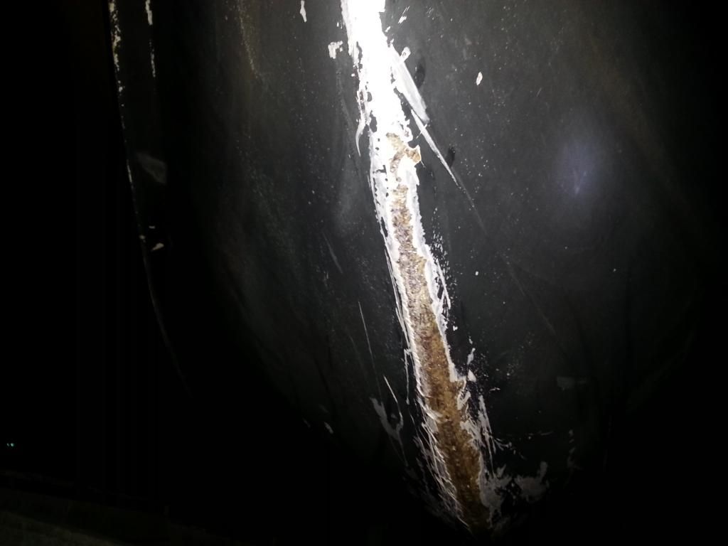

Ok i got you. How hard it's it to paint over old bottom paint someone had black bottom paint on it. It's worn now and you can see the white coming through in places. Second. .. i noticed today on the keel that you can see raw fiberglass. Say out is like bondo but flexes where bondo won't. Can i use something called poly coat on that. I had a friend recommend it for patching a couple places on my cap where the gel coat had busted. i will try and get a picture of the keel tomorrow.
Woodonglass
Dec 29, 2009
25,929
Pics will help but...for patchin a worn keel that's down to bare glass, I'd highly recommend making your own repair mix. Mix up some poly resin and cabosil to thicken it and then add cut up pieces of Chopped Stand Mat. Make it the consistency of creamy Peanut Butter and putty knife it out smooth. Once it sets up you can sand this stuff out and it will wear like Armor!!! Bottom Paint is NOT easy to remove and It's HIGHLY Toxic sooo. if you decide to sand or grind it off you MUST wear a VERY GOOD Respirator to protect your self. Dust collection as best you can is a must as well.

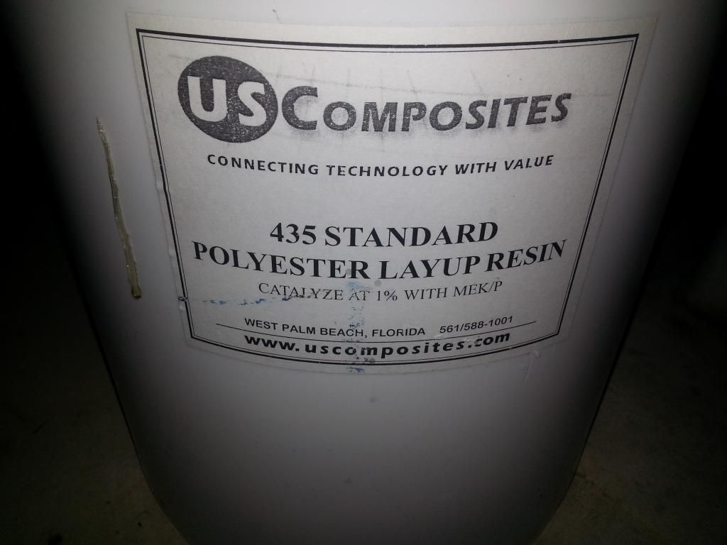

ok I have some mat how small does it need to be cut up and is the pic below the correct resin and do I need to add hardener to it. My father in law had this he just got done with his boat so he had it and some mat left over.

here's a pic of the keel not the best but its dark when I leave and get home
Woodonglass
Dec 29, 2009
25,929
Yep that's the right stuff!! Here's what you should do to fix that keel. Grind it all down and feather it out about 3" on each side to good fresh glass. Any major gouges should be filled with the filler I spoke of earlier. Then cut strips of CSM to overlay the keel and glass them in place. If you have any 1708 Biaxial Cloth, a layer of it wouldn't hurt too!!! Then 2 more layers of CSM and some final fairing and sanding and she'll be good as new.
