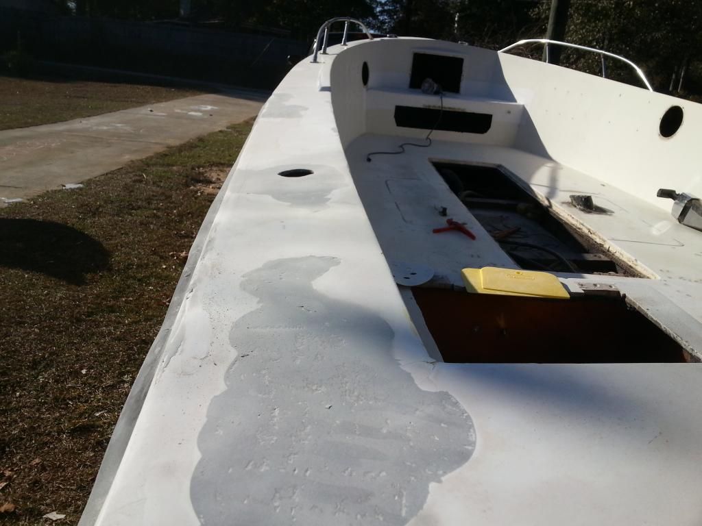

That's what I'm thinking too! If it's gelcoat then i'd remove all the loose gelcoat that I could then clean the areas well with acetone and then I'd mix up some gelcoat paste (gelcoat thickened with cabosil and fill the areas with it.) If you're going to be painting then trying to match the color is not important. Sand and fair and you're ready to paint.

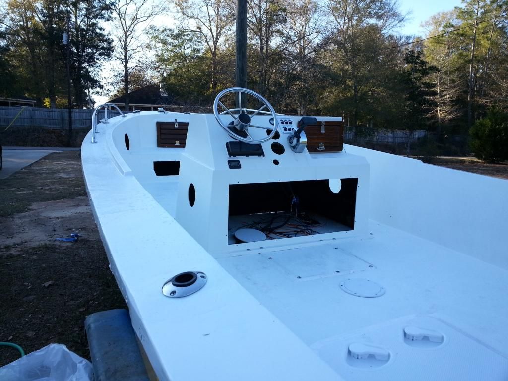

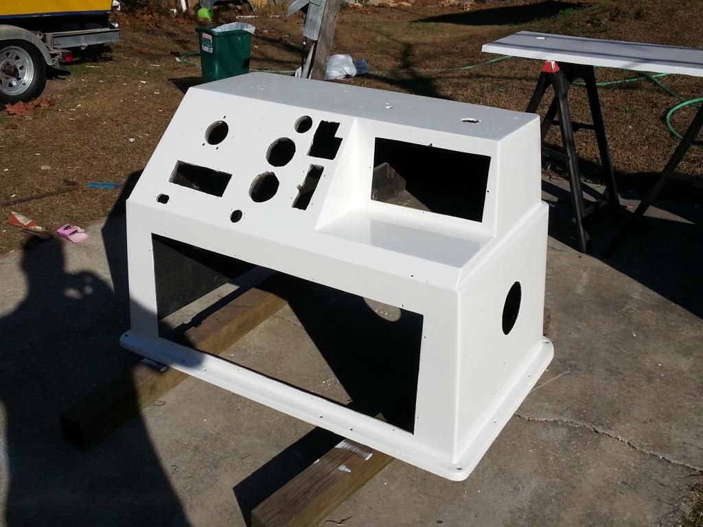

First coat of white went on today. Starting to shape up a little now.

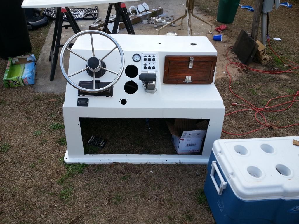

Thanks still got a ways to go but ill get there. may be awhile though got to put in some extra hours at work for the next month or so but at least she will be closed up and ill be able to start on the outside then.
