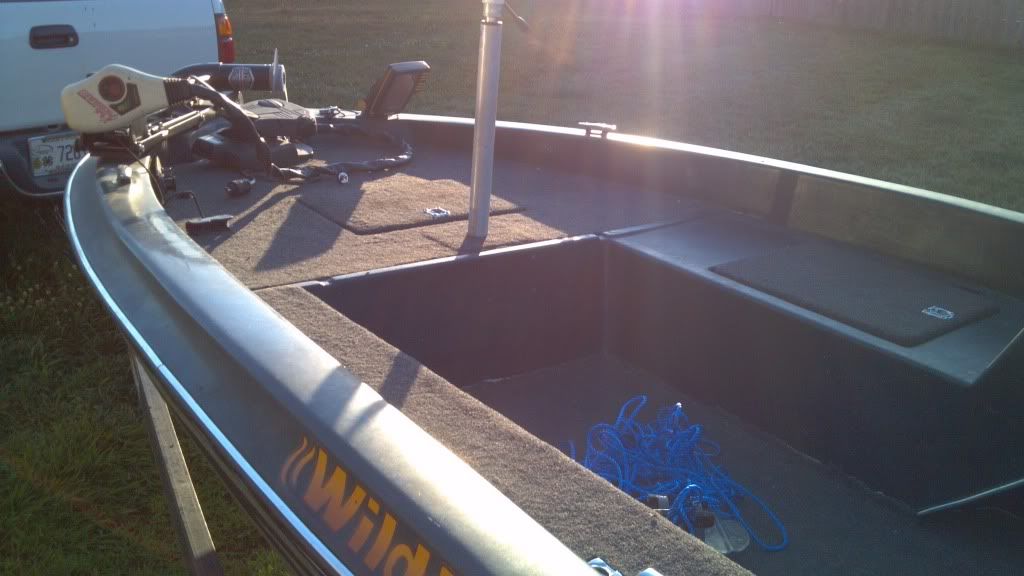

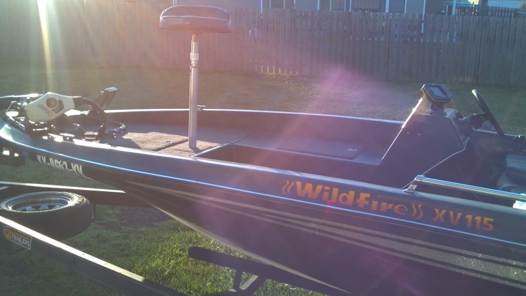

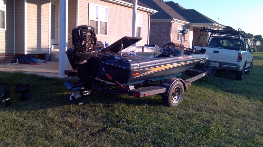

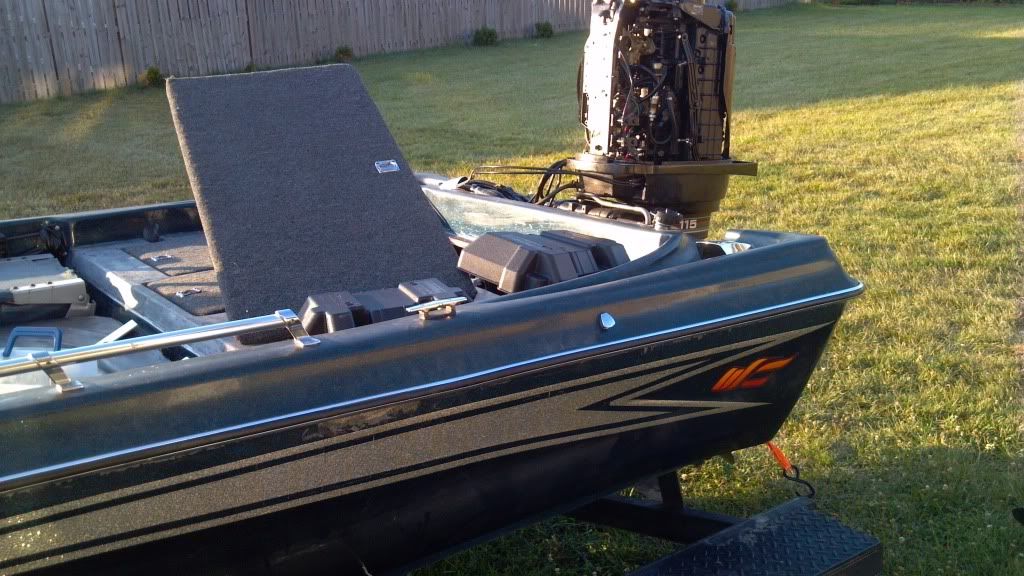

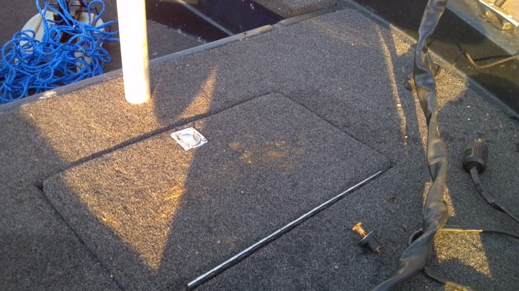

Well, I hate to take these pics and put em up cause there is so much more to do. Still have carpet to put on the back... had to order more. I was a bit short. And a couple of the compartments i have not hinged down. I still have yet to get the seats. I think I'm gonna make my own seats. Also I'm gonna make a new dash panel. And i still need to trim the edges of the carpet a bit. Engine is running good besides a few adjustments i gotta do. I believe the rectifier is bad cause its not charging and the rpm gauge is not working. Also i need a new trim tab. I also have yet to rubbing compound the whole boat and wax it so it is still oxidized. Im sure there is more but here are some pics for everyone who has followed me thru this and helped me. If anyone has experience with these mercury inline 6 engines let me know. I have a few questions.

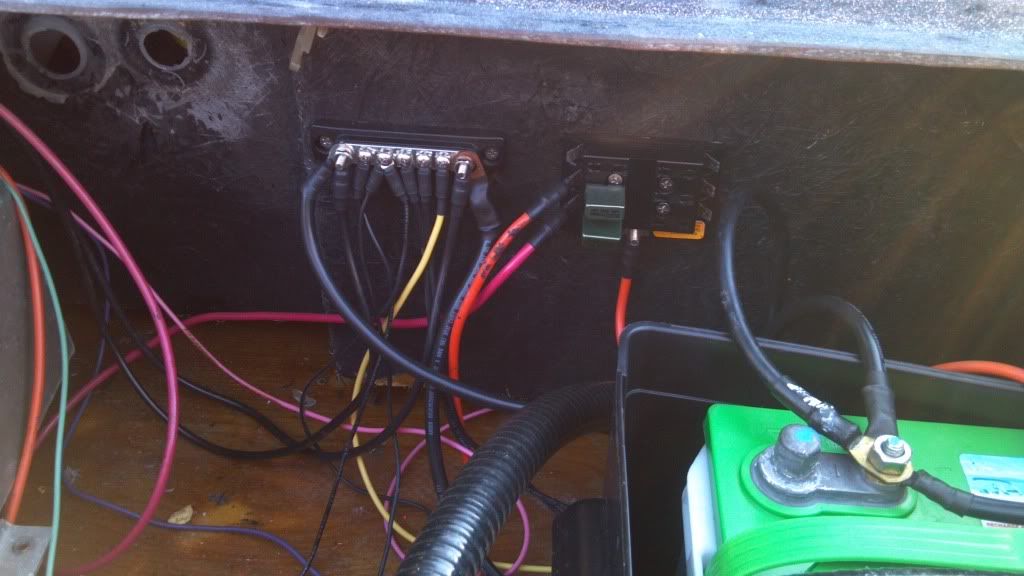

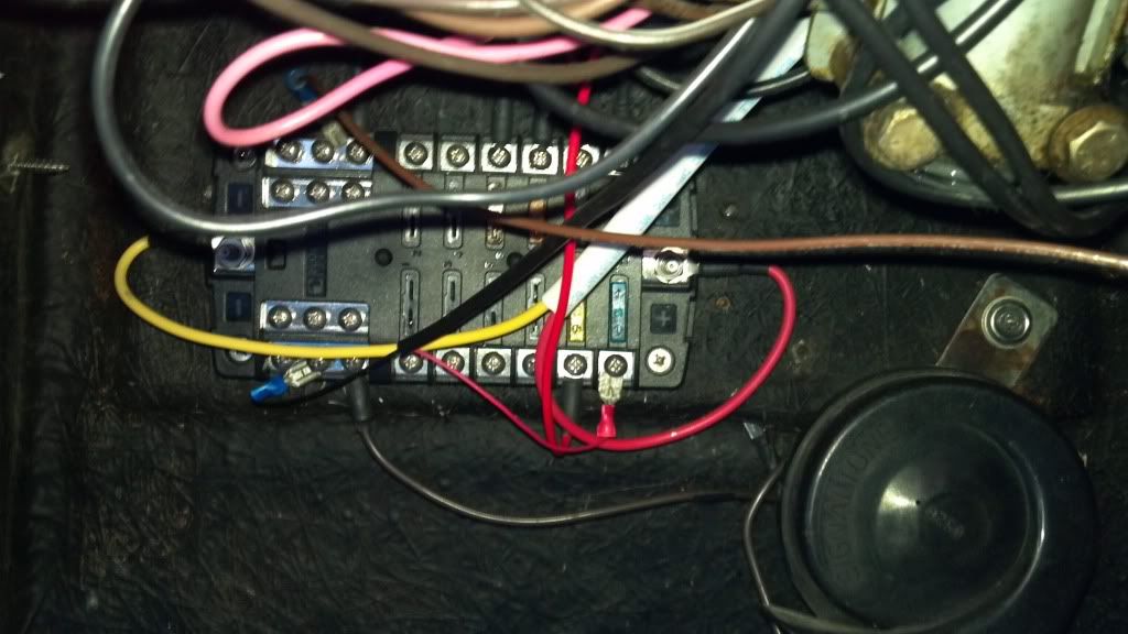

my new fuse panel I put in. Still have lots of things to hook up to it and a cover goes over it with all labeled.
I put a ground bar in and i apparently need a bigger one cause i had to double up on a few things. I rewired all of everything and heat shrink on everything. The wiring was a mess of coarse before. They had all the ground wires spliced together and taped up with one wire going to battery. I ran a 8 gauge to the battery to the ground bar and attach everything to that. Also I have the thing right beside the ground bar I found I'm not sure how good they work but it is a auto reset fuse for the trolling motor. Any input on that would be awesome.

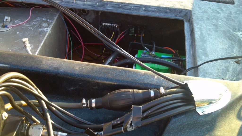

Well everyone, Back on the working on the wildfire hard. I had a few spots under the boat that I had to gelcoat in white. Got those all done. I really have to figure out a good battery situation. If anyone has any suggestions please do tell. I got a cranking battery and a deep cell for the trolling motor. This is what I am trying to figure out..... Is there some relay or some sort of deal that I can hook up to where I can have the motor charge both batteries while the boat is running? Or will the motor not put out enough juice to charge em both? I figure there is a way... Like maybe how in a car u can get a beefy alternator. If anyone has any help in this dept I would love ya forever! :> Well... I love ya all forever anyways!! You have all been awesome in helping me! No way I would have been able to do it without y'all helping me! And it just makes it more exciting when you have a bunch of boat pros watching your restore and telling u your doing a great job! :> Nothing better than being on the water on the boat and knowing all the fiberglass i inhaled to get it water ready! Very satisfying!!
