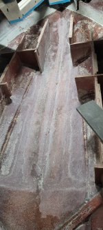

Question... I have this "stringer" running along the keel starting from the ski locker to nearly the bow. I've seen other similar boats that don't appear to have this. The floor of the ski locker was resting on top of this "stringer" but the front part was just there by itself. Is this a structural thing to strengthen the hull? Reason I'm asking is the back half is rotted out where the ski locker was and I'm wondering if I need to replace it or just remove it. It was there to start with so my default answer is to replace it but I'm wondering if that is really necessary.

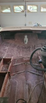

More progress... Removed the rotted piece running along the bottom (which I will replace) and cut out the lip of decking. Still need to finishing grinding some of the bottom to make sure I have a good surface for the new glass. Then will grind out the deck lip and sides.

Safest bet is put it back as it was only better. Mine had a "keel stringer" but it really was only under the fuel tank and I assume for support of the weight. (Triangle for strength) I extended it a foot or so in either direction because my fuel tank was larger and I figured it would tie in the areas outside the bulk heads.
It looks it was only done with chop strand on yours (hard to tell) so it may not be providing the same structure that you would get by using a traditional layup like your main stringers are.

Definitely a structural piece. To prevent the bottom hull from flexing in rough water or sitting on a trailer. Or even a couple of boat stands. Do it. It is the keel of the boat.

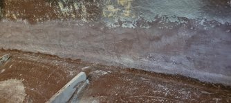

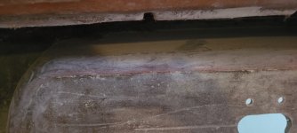

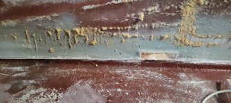

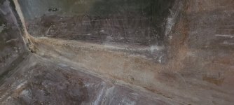

Saturday is grinding day so more progress today. Finished with 95% of the floor. Just a few places that I couldn't see when it was covered in dust. Also got the deck lip ground away and up the sidewall. Ground down around the transom lip well. At the top of the transom, I can only get a few inches ground due to the interference of the top cap. Any suggestions on how grind with only a few inches of clearance?
Top of transom. About 3.5" off clearance on the top surface.
Side of transom
Deck lip and sidewall.

Question about the sidewall. The original setup for this boat had a layer of spongy foam glued to the sidewalls which were covered by a sheet of vinyl which was stapled to a wooden piece that went along the side of the boat just about where the top cap attaches to the hull (out of site with the side piece installed). The vinyl was attracting mold which seems inevitable in a boat environment. I'm thinking about putting something like deck foam on the sides instead. I was thinking about just smoothing the walls and doing a gel coat but I'd prefer to have the foam to help with sound dampening. So my question is.... is deck foam (i.e. Seadek) actually waterproof? or will it absorb moisture and therefore, end up with a mold problem. The issue is once the side pieces are install in the boat, there is limited access to these areas so cleaning them is a problem. I really want something that can just be wiped down without worrying about mold getting starting in some hidden areas.

I recently did a transom job with a clearence issue like that. My supervisor has an extended shaft straight die grinder that helped a lot, along with a few carbide bits and a stone ball. Later, I had closed the gap even more with glass, and had to come up with something else. I taped a stir stick to a sawzall blade, and cut a piece of psa 36 grit sand paper to fit it. It was a bit slow, but worked well. Longer blades will let you put some pressure on and flex them.
As for the sidewalls, just gel would probably be best. If you use the foam, could you set up a blower on a timer somehow to dry it out? Even just a tiny box fan left in overnight would work.

I'll look into the die grinder. Looks like a workable solution.
