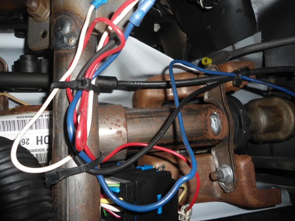

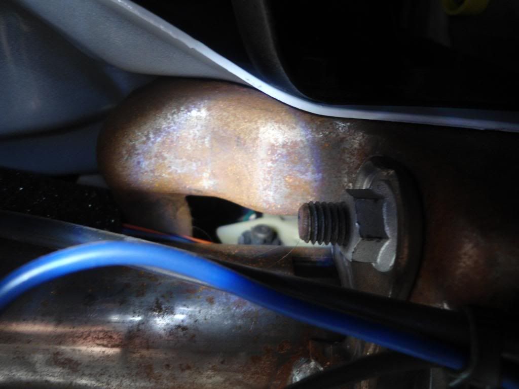

Just getting to the switch to test looks near impossible . :facepalm:
In this pic you can just make out the retaining nut that holds the switch in place..
I just don,t see getting to it without pulling the steering column up out of the way . :facepalm:
That will take I think dealing with the air bag unless I can just pull the column up a bit without messing with the wheel ..
Uhhhhhgggg!!!
