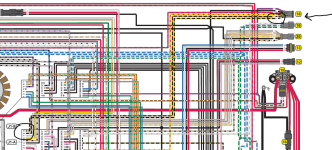

testing for ground is the easy part
could be just a dirty contact in the #18 in diagram... or reseating the connector on the EMM work carefully on the EMM $$$$$

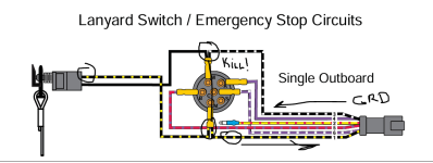

don't forget key posts must have 0 ohm (short) M to M when OFF !! if grounds and wiring is ok
same goes for laynyard switch... to kill it must short out M wires
unlikely both functions would be bad but....murphy lurks.
