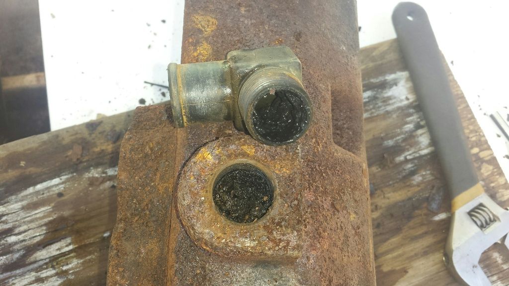

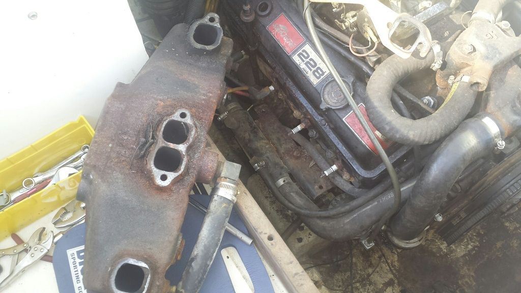

Yup, your right! Had nothing to fear but fear itself! Pull off the exhaust manifold and everything was plugged up solid. Gonna need at least one exhaust manifold. Gonna wait for the other to fail before spending the extra money for two. Maybe another bad decision but "dumb is as dumb does!" (Who said that? LoL) I post a couple of pics in a few minutes.

My money is with Bondo that the thermostat housing isn't right for the application. Manifolds obviously plugged, but prob not the only issue . Marineengine dot com has parts breakdowns by engine serial number will show correct thermostat housing part number

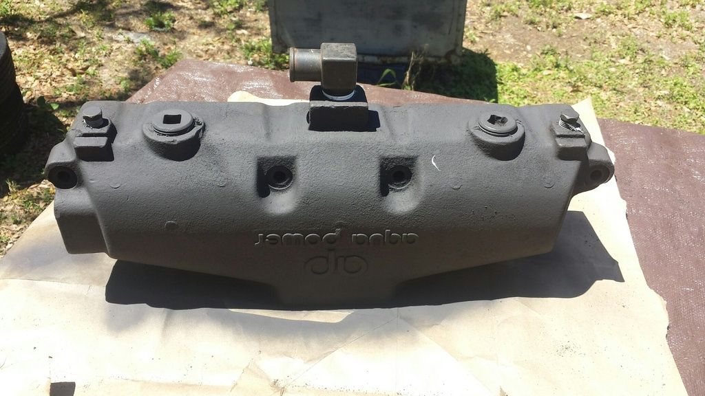

Well after removing all the plugs and poking, scraping, high pressure water and using some spring wire on a drill, I was able to open all the various passages to were all are flowing water very nicely! I teflon taped all the plugs, painted and waiting to order some new gaskets will put it back in. While I've got it opened up I'm going to change the spark plugs. Monday I'll do the other side even though it seems to be flowing alright.
