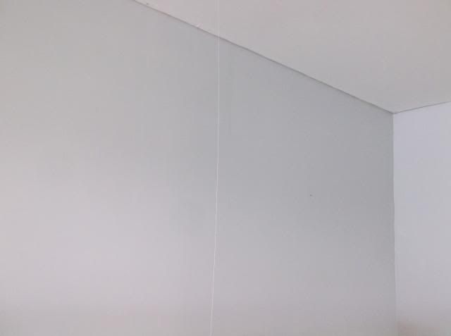

I found spider webs about 8' from the boat that looked like this....
So I pulled out the 1/3 sheet sander and got some soapy water...if I would have started out with that combination I'd have had everything sanded in a couple days easy...oh well live and learn....and the water cut the dust down to nil....

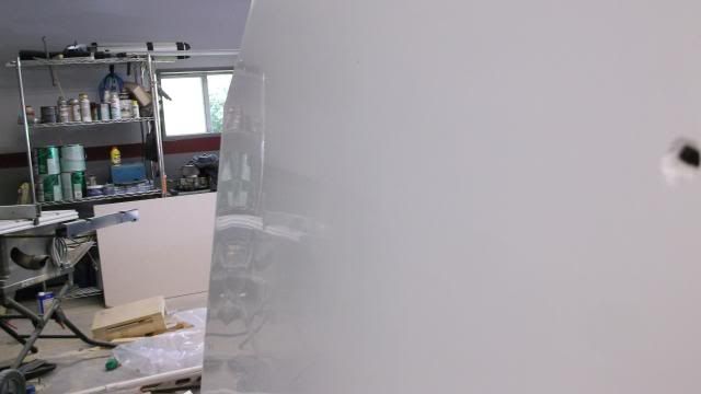

went from 120 to 220..then 320...400..600
Have some spots that are thin...some places I didn't get good enough with the courser grits..was afraid of burning through...
I can see where the 3M black dust stuff will be needed to get things right...
600 grit..
you can see the burn thru on right side of pic...along with some places I need to go back and do with heavy grit again..
But...
not enough sleep and I got to working...
needed a nail..4 washers...a rag...variable speed drill...and some finish compound...
and got this...
Was good experience...I'll have to get the right compounds and a buffer and accessories eventually...but I don't think it came out too bad for using hill billy ingenuity...
