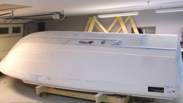

Had another Dover, DE trip last week, so no more sanding till last night and this weekend.
I've decided to sand it to a finish and see what I have, almost finished with the one side and only 3 low spots so far.
I figure I can scuff and spray each of those then refinish. Heck the Admiral didn't even see them and she inspected paint for 10 yrs., but she was looking for things like fisheyes back then....

Some progress...spent too long trying to find a replacement sander today...30 miles to the nearest store that should have had what I was looking for...but they didnt, nor did their competition...
80 grit by hand is doing a quick job of knocking the highspots down...I just keep hitting the areas with more blue than white...then when there is more white than blue I trade off to something like 220 on the 1/3rd sheet sander till the blue spots feel close to same height as the white..then it is 400 grit..back half of sides here is getting close...as is the first area up to the first strake..getting late and I need to leave the windows and doors open to get a little air to carry the finer dust out..so only hand sanding now, so back to crawling on top with the 80 grit...

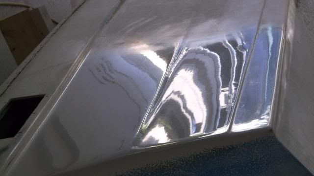

Not perfect by a long shot...but good enough....needed some inspiration for all this sanding...
besides this is just for fishing, no one is paying me for all this work, I am not a PRO...good enough for me :)

Looks better than "good enough" from here... In fact, it looks great. Keep in mind its the bottom of the boat and it will get scratched from use - In fact, I almost hit a log yesterday that was floating in the middle of the main lake channel... (Good thing my motor was dead and I was "trolling" on speed "5" or I might have hit it... :facepalm:
Even brand new cars from the factory are not 'perfect'...Trust me, I work on them everyday...:facepalm:
We as humans are far from it...
And a past boss used to like to say, "Perfect is the enemy of Good Enough!"
BTW, from this distance it looks...
"Freaking AWESOME!!!:D
