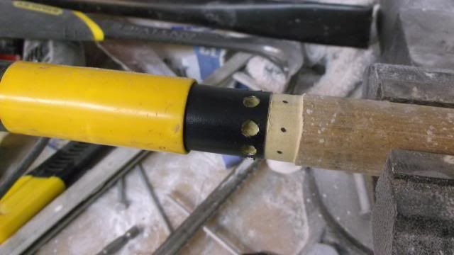

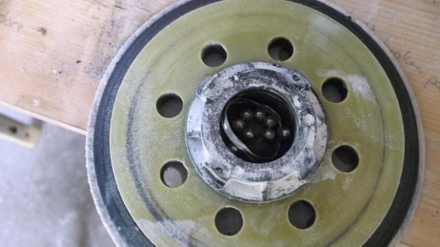

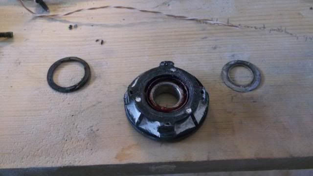

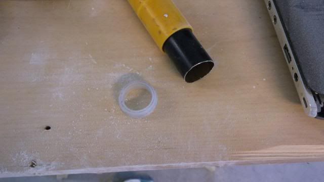

ok, just so I could liit the amount of time sitting up on the hull, I chose to use my random orbit sander...the bearing is shot so wasn't sure how long it would last...about 15 minutes...the little nylon cage that holds the bearings in place was gone...mostly...decided to make a replacement. Easiest way I could come up with was a piece of copper wire...that lasted about two uses of the sander. So I neeed something else..saw an empty bottle of MEKP and though, hey that is about the right diameter...Cut it off...shaped the bearing traps using the dremel...this lasted for about three uses...and kaboom..pieces and parts flying everywhere...gsthered them all up and decided to remake it a little better. Found an old metel broom handle about the right diameter...fit it to a wooden dowel to hold it while I worked on it. Center punched 9 equally spaced spots and drilled them out with the little drill press. Cut and ground the new cage to length while still on the dowel. Had to put the bearing back together. A little grease to hold the bearings in the outer race. Angle the inner race and flip it in place. Pushed in the new cage...marvelous! it works fairly well. Not too bad for a fix it your self job on a Sunday afternoon. filled with grease and am going to town with the sanding...

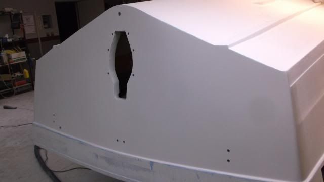

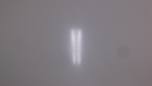

So the long weekend was good, made some decent progress on the sanding....
Paid for it in mighty sore arms though...so tonight I took it easy and finished the transom skin...and I am pretty happy with it this time around...
I notice however that the shine when looking directly into the surface is rather lacking...kinda blotchy even...

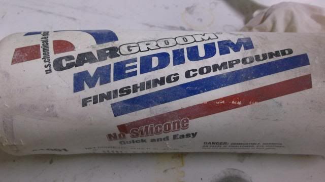

Could it be the compound I am using? This is what I am using... the stuff is probably 10 years old...I got medium fine and Black Cherry Glaze...I tried the glaze before and did not like the black greasy look it left behind. The medium and fine is a sort of wax base...I use small amounts and it takes awhile before it is finished cutting..or sticking which ever it is doing. the el cheapo bonnet I got from HF is almost toast...
So my question...is copmound just compound or is there different types for paint vs. gelcoat?

Re: '78 Ebko Lebaron - Therapy
Old compound could be part of the problem as the liquid type ingredients used in making the stuff may have evaporated...
Good quality bonnets do make a big difference as to the quality of the "cut"
I don't mean this to sound like a paid advertisement for 3M products, but at the shop, we use them on Brand new $80K+ vehicles from the dealer and they constantly compliment us that when they get cars back from us, they look better than from the factory...
Yes, a lot of it has to do with the detailer's experience, but both he and the painter swear by these products and both have tried several different brands...
That is not to say that there aren't other brands that are equal to or even better, but these are tried and true at the shop...
Check this out... Compounds, Polishes, Glazes, Perfect-it, Compounding, Polishing, Glazing, Paint Finishing, Rubbing Compound, Buffing Compound
No matter what, you are getting it to look pretty amazing, nice job!:)
