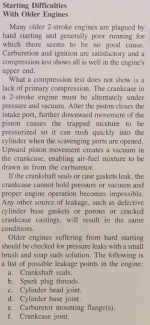

Cool. Scratch that off the list. I also found this gem in the shop manual, not sure where half those things are:
