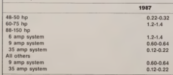

It looks like I have another part to pull and examine this weekend. The stator tested bad. Going to borrow another meter from a friend to confirm. It doesn't look like something that is likely to be broken, but if it is I have a ton of questions I will need help with. I can see voltage on my fish finder, the highest I've ever seen was 13 volts.
Yellow -> yellow/grey -> 1 ohm
Yellow -> yellow/blue -> .8 ohm
Crosbyman
Nov 5, 2006
5,977
Don't assume problems some meters are not overly accurate trying to read such small values. Especially digital meters you can't set meter and probes to 0 ohms with the side dial before actually measuring the suspects.
Yeah I made a mistake testing the charge coil and replaced that when I did not need to a few months ago. I need to get a simple analog tester that a guy like me can understand.

Yeah but , Im thinkin of all the guys I have seen that just dont know how to drive a meter to its best advantage , and all the good (ish ) looking meters that turned out to be crap.
Those cheap digital meters will do most home work shop stuff but you have to know how to work around their short comings.......like doing a bit of basic maths if the thing dont zero .
I can recomend a Fluke 179 .

actually to be correct it is a x1 scale but you should be able to estimate a low resistance close enough

get yourself an antique like this one with a 1 ohm full scale with thumwheel adjustment to dead )
it needs an old 30V battery but I wired mine up with 3x 9v ones in series and it fits inside the case, works perfectly.
Yes, everyone on here has these....in fact I have the original 30 volt battery. Tried to recondition it but some goo drip on my finger and now my face is gone!
Yes, Jaques (The Cros) has all the neat stuff.
