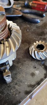

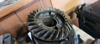

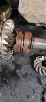

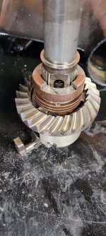

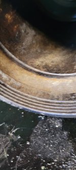

Hi all, I posted this on the OMC forum but wanted to add it to my rebuild thread so sorry about duplication 😊.
Well....
I disassembled the lower gear case and everything looks good other than it was way past time for seals.
I did this because I had horizontal play to an 1/8" maybe 3/16" and the prop could be rotated a good third of a turn when in gear.
I also had it jump out and back into gear once when on the lake.
I did come to find out that the shift rod is adjustable which I didn't think it was because there isn't a nut under the fork like some other models I have seen pictures of.
I did notice that the prop bearing housing may not have been seated all the way in by a paint line still visible before the embossed area on the prop housing.
Does anyone have any thoughts on any of this? I'm all ears! .

Best to track that thru the OMC forum, and avoid duplication here
