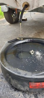

I wanted to share the oil drain I had mentioned long ago. It's draining slow because it's cold but even so I can have a couple of beers in the meantime., I also decided that along with the valve I will just install a plug on the valve then no worries.

I sure wish I had installed one of those when I had my engine out. It was stupid to not have done so.

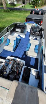

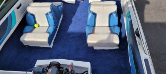

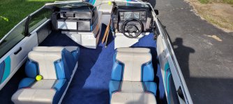

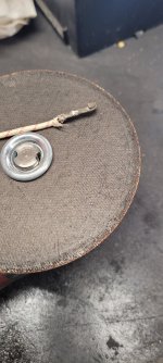

I needed a break from the mechanicals so I decided to work on the cosmetics, not glued but allowing overlap.
Looks like a stick figure murder scene lol.

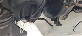

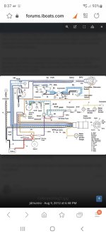

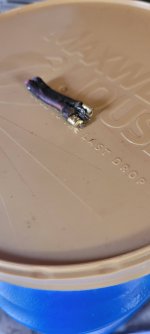

am converting back to the original setup with the resistance wire and upon receiving it there is a totally different connection on the non-coil side. The original had a connection to both alternator wires, did this get changed as years went by? Per the diagram they are spliced but look separate. I posted in the electrical section also.
