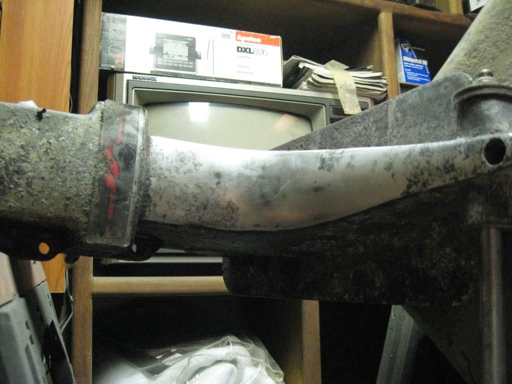

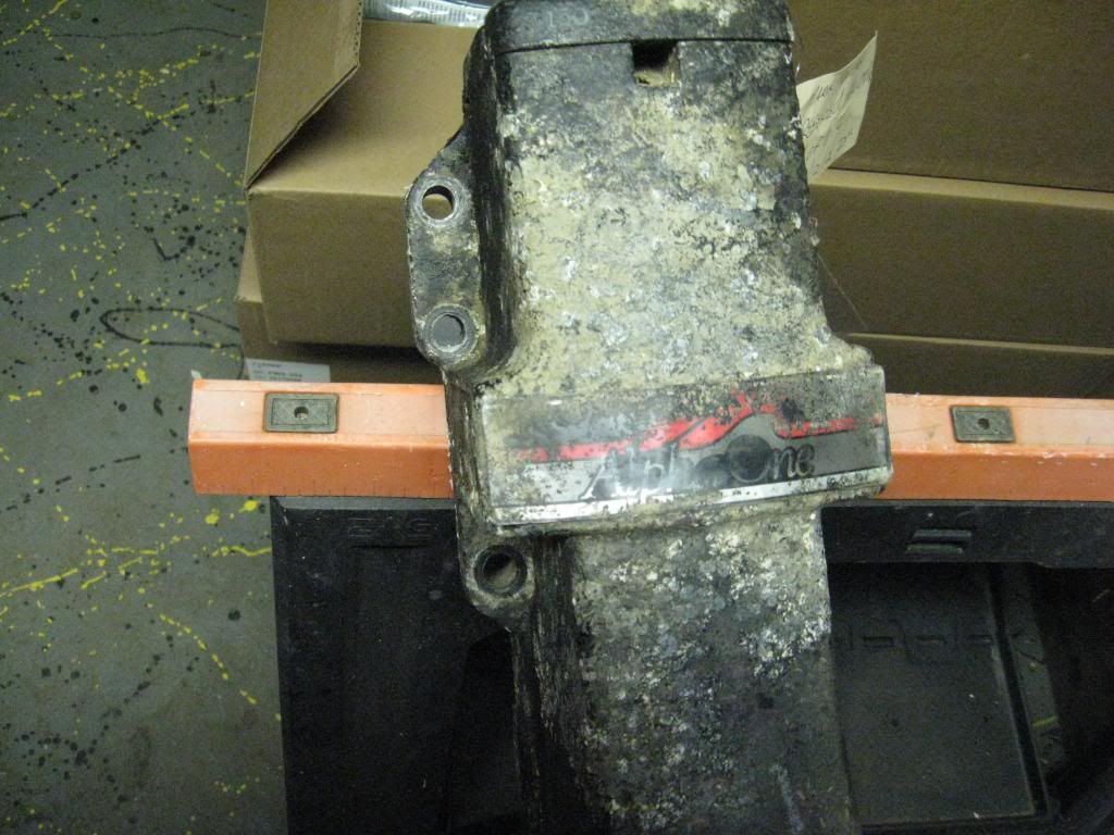

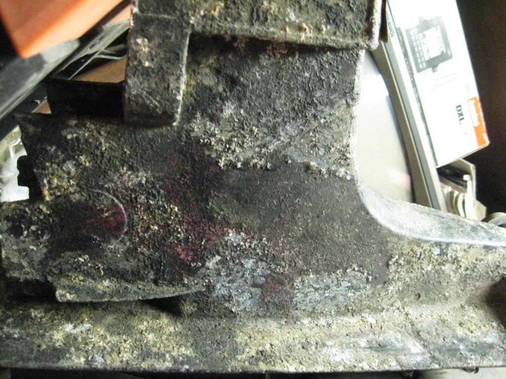

next job is to clean up the newly mated outdrive, the upper is all pitted and pinged up, the lower is just a little ruff around the edges
the lower isnt too bad, the red hue in the pic is the reflection of my shirt:facepalm: not primer showing thru

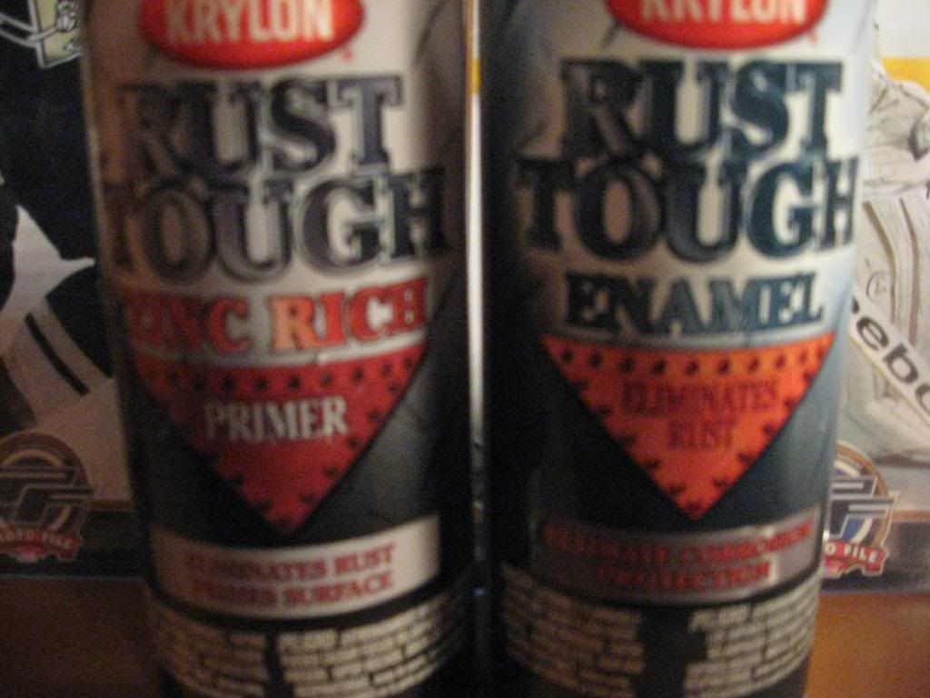

the plan is to sand it down to remove all the pitting then prime with krylon zink rich primer in rattlecan
then coat with krylon rust tough enamel in black
i spent about an hour sanding with 80 grit non orbital sander and its almost good (6"x6" midsection) shish lots to go
i'll post pics of progress when i give it up for the night

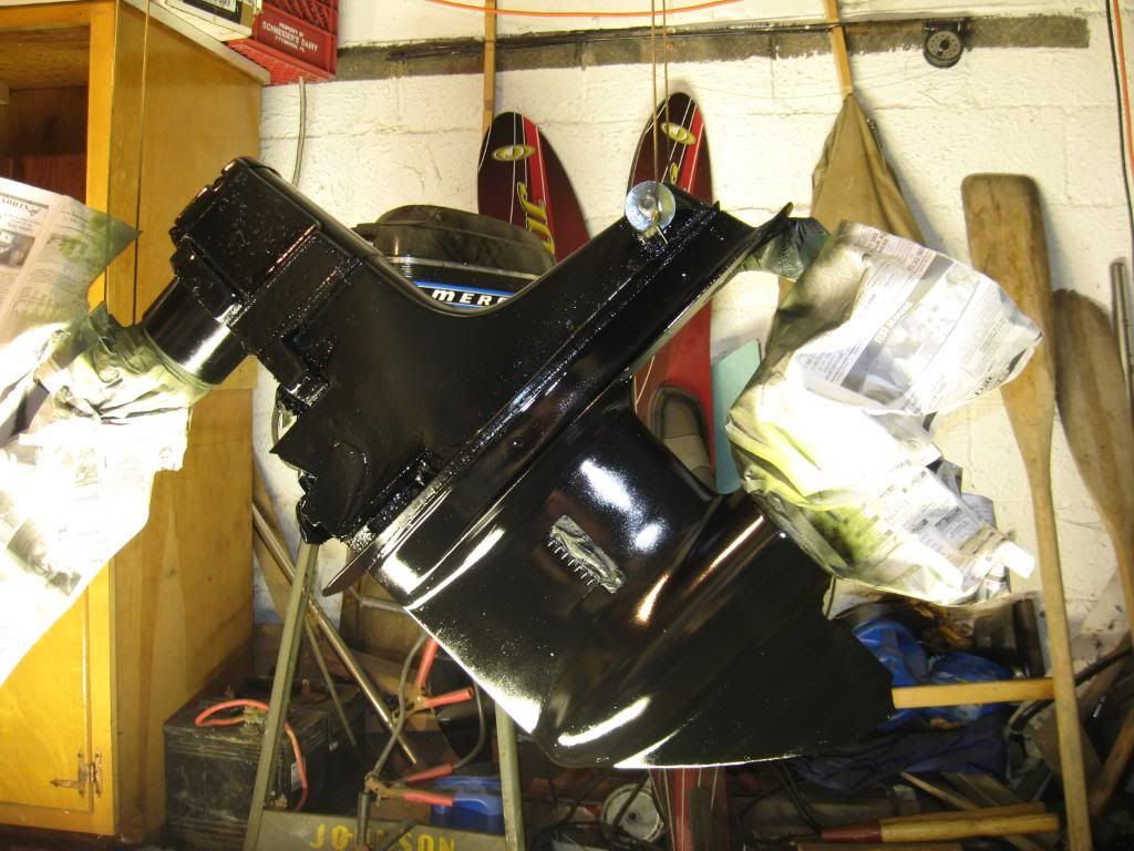

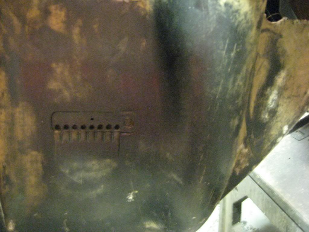

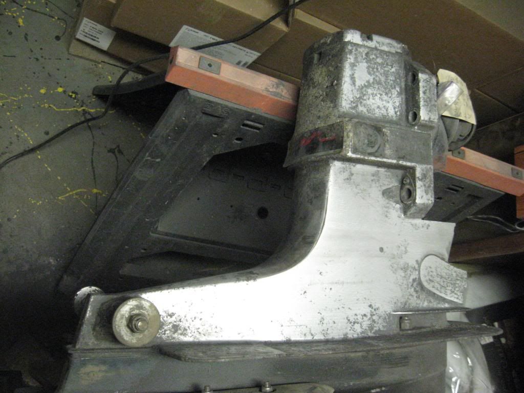

after too many hours than i'm willing to admit!:eek: theres gotta be a faster way,,, 80 grit,,, but it sure was nasty
1/2 closer to being done heres the results
still some pitting but i've had it for the night,,, glad i dont gotta work till 1 tomorrow
i got some shoppin to do,,, need some alpha one stickers and some better sandpaper:facepalm:

When i repainted my drive I used a dremel with a wire wheel on it, it worked great and got into all the nooks and crannies. Then finished off by hand with 80grit and she was ready for some primer.
A word of advice, LET THE PAINT DRY FOR SEVERAL DAYS/WEEKS BEFORE PUTTING HER IN THE WATER. Ask me how i know...:mad: I painted mine with rustoleum aluminum primer and paint in the rattlecan, it dried for about five days and I thought was cured. Put her in the water for the weekend and when i pulled her out, my newly painted drive was all "wrinkled". The paint didn't come off, it just wrinkled up over most of the drive! Grrrrrrrr

Might ask some other people, but some say not to use zinc primer on an outdrive because the outdrive is aluminum. Dissimilar metals?

thanks, i started a thread on this topic http://forums.iboats.com/showthread.php?t=537134&p=3674672#post3674672 so i dont make the wrong choice:facepalm:
zink chromate was suggested. but i had a heavy hitter tell me not to sand at all, which i realized after several hours of doing just that.
even tho i am discussing on both threads, my worry is that if i sand too far the case will be thin, and if i dont sand enough the electrolosis will have an easy target. note; when i bought the boat it didn't have an annode or most of the anti cavitation plate either aswell as the stainless cables weren't attatched to the outdrive from the gimball,
and for that matter, now that i'm using the old upper pinged outdrive as well as the gimbal ring(pinged also) i am a little worried:(

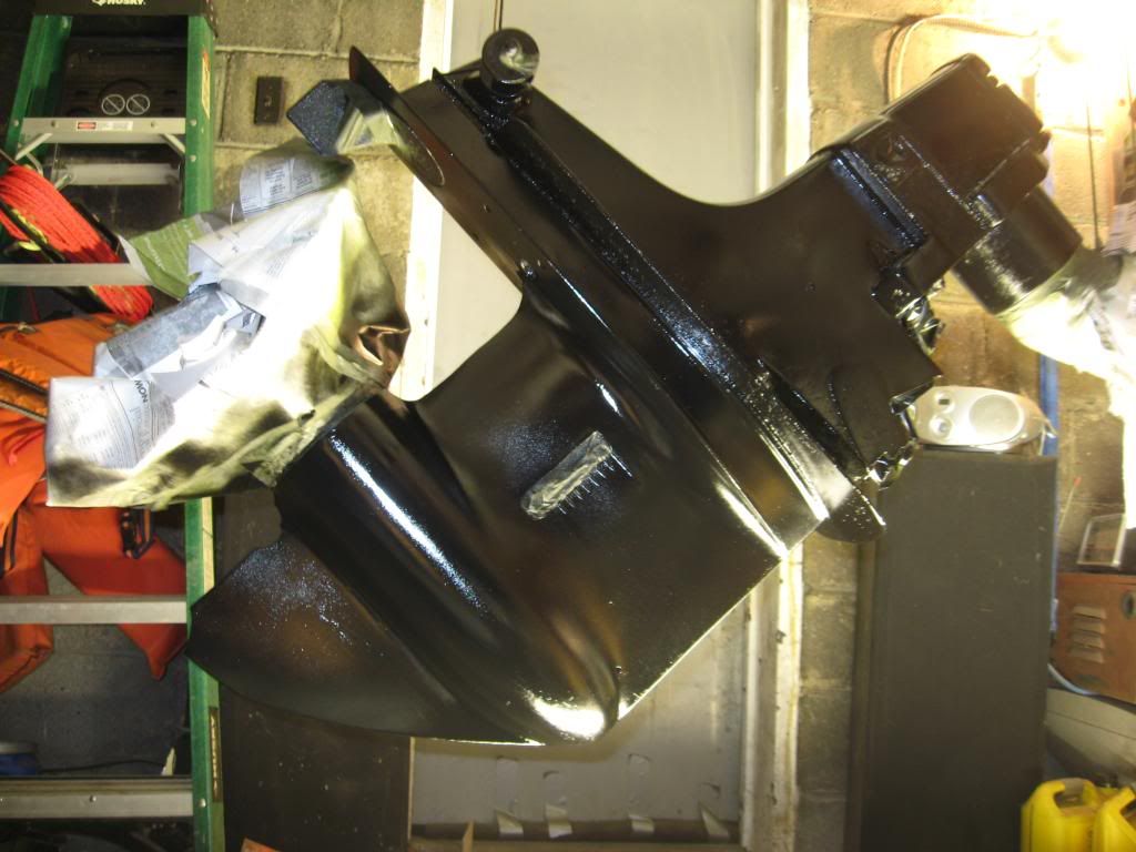

i also got a can of the zink chromide primer. my mechanic is ready to reinstall my engine,,,sweet:D however he wants my drive back right away,,, so i dropped my sammich and got it done today,,,lol.
anyway to recap 1st side almost sanded good enough,,, for a rush job
although i did go over it with my new toy in my haste i broke the rules and didn't take pics
this is the zink chromate i used as the primer. note; the lil metal piece on the can my plastic saw horse broke and down went frazier ouch (murphy appeared) lookin at the newspaper now, shish he had is eye on my drive the whole time,,,, creepy lookin at that lil piece too omg!!!
lil buggy
Sep 24, 2011
766
Re: 89 Fiesta Vee 250 setbacks, projects, and upgrades!
here it is after the primer notice the missing chunk,, the old lower outdrive was in way worse condition even with the (murphy addition)
and with the first coat of rust tuff(krylon)
i really wanted to sand it all the way down past all the pitting but it should be fine with another coat for a year or so. still gotta get the mercruiser alpha one stickers.

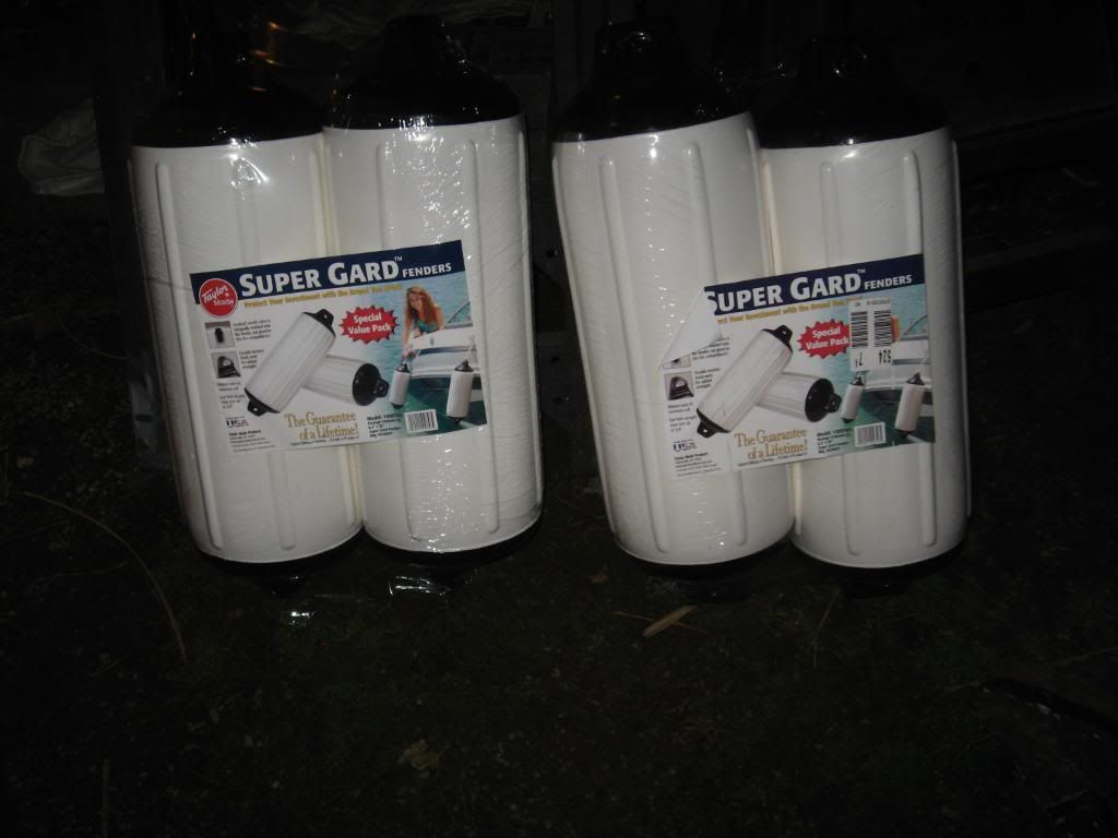

shoppin today, the admiral gave the nod for a few pricy purchases:D i was happy when i got that sander i was drollin over.
i always call her my enabler:facepalm:. the truth is i been watchin a set of fenders at west marine, 2 pack big dogs , anyway when she saw me lookin at em she asked if they were gonna go an sale, when the clerk said they were now, prolly as low as they would go.
the admiral said get em, all i said was we got 4 ss holders she said get 2 packs then and proceeded to the checkout. i didn't wana fork out the cash but with the approval:D whadami supposed to say,,, thanks. anyway i am excited,, we had like 5 smaller walleyworld ones
but raftin we had to be careful:eek: cause they were so skinny. upgrade wooo sweet. here they are
