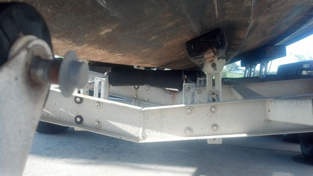

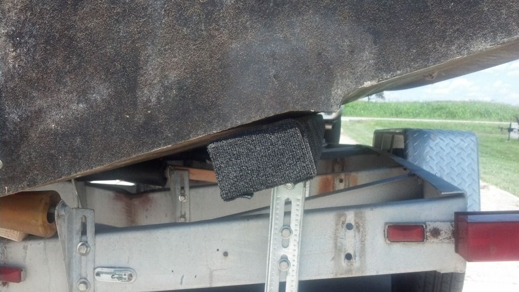

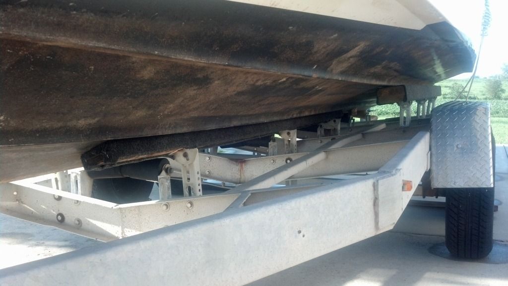

ok not a great pic but - as you can hopefully see the bracket is kicked to the left. The toher side (currently completely dropped) could go about the same. Should i keep them with that little amount hitting the boat or driill new top holes and kick in to the right to get the full 5.5" on the hull? I would keep the bottom holes as is, just kick over and drill new tops.

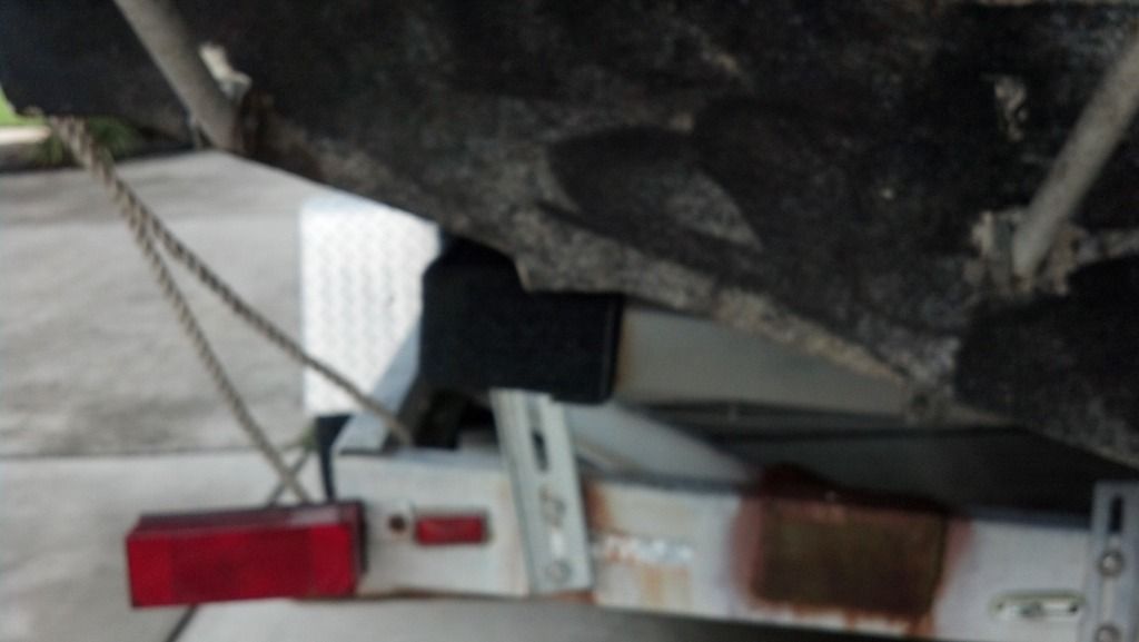

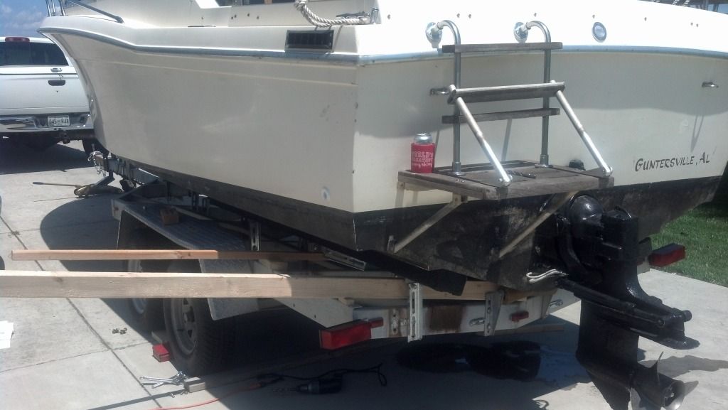

ok - first the dumbass picture. I needed to move the *** end of the boat to the starboard. Guess what side i forgot to drop the bunk out of the way? Shawn and i even talked about it when he stopped by...

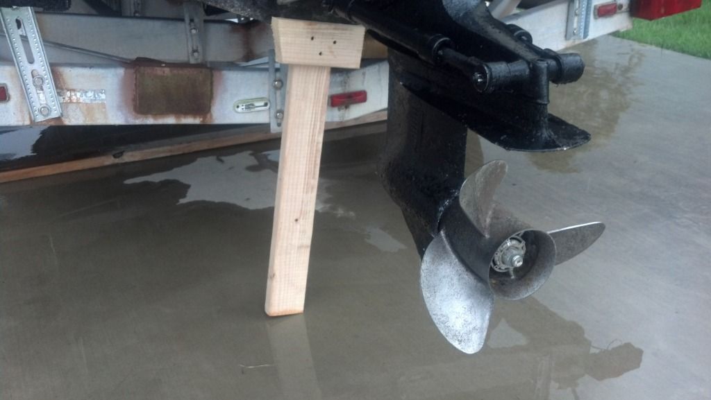

here is how i bent the tounge jack - trying mellos suggestion which would have worked had i not been a dumbass per the previous pic. I ended cutting that peice about 8' shorter to use my floor jack before i relized and rectified my dumbassedness so in the end mellos theory with a floor jack was the solution.

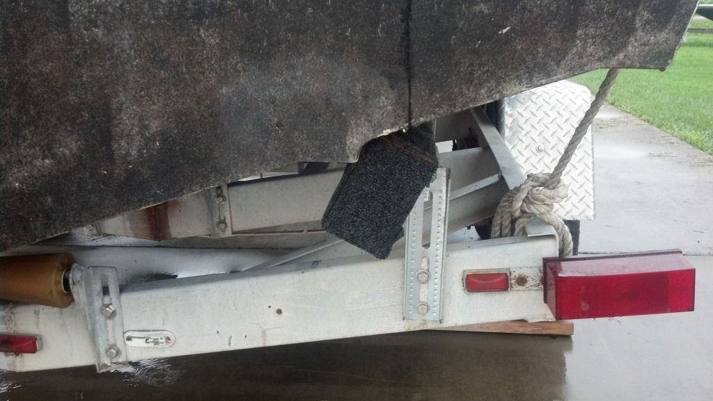

so drop that bunk and get some wood to leverage.
then do the other side (note the beer; a must for any semi dangerous boating project)

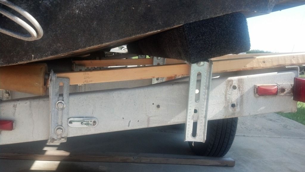

then come back and fine tune the first side when the other side dropped an inch after removing the bunk
then call it good

i wish it was as easy as it sounded.
ok, second guess me, tell me what i did wrong, and :-[
