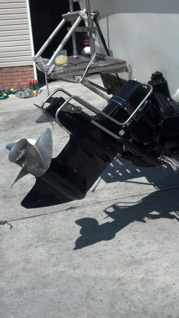

ordered a new sterndrive and trim rams today with all the sh** needed to install. Everything behind the transom will be brand new with a 3 year warranty
ordered:
stern drive
Drive shower
Transom seal kit
Shift cable
trim cylinders
Anode kit
stern drive install kit
trim cyl install kit
Trim Sensors (hockey pucks)
paint
Zinc Chromate for primer
3M 5200
3M 4200
portapotty
marine tex
redneck joe
Mar 18, 2009
14,976
Re: Carver 2357 Montego
my new unit:
