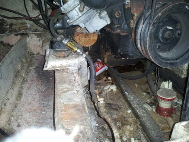

Enclosed are a few photos showing how my motor was mounted originally. In the photo where I have the old pieces propped back up I have the rearmost sections on the wrong sides of the mock up, but you get the picture. Under the motor the main two stringers just had three more pieces of ply lammed to the outsides, but not even extending to the hull. So it was like a block of wood attached to the stringer sitting an inch or so off the hull.
As you can see I made mine 4 pieces wide of 3/4 instead of 1/2, and that is full height all the way to the hull.
Then, originally, the floor went on top of the stringer, then the L shaped motor mount went on top of the floor. The lag bolts go through the mount, deck, and into the 4 ply stringer.
What I want to know is, what part of this do I double up the layup on (4 layers of 1708 instead of two)? The entire 4 plied stringer section, or just the L shaped motor mount?( I wanna make sure I have my terminology right and make sure its not that whole piece that's considered the motor mount)

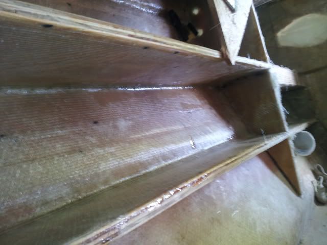

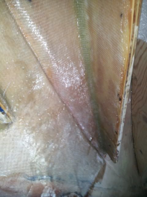

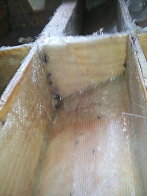

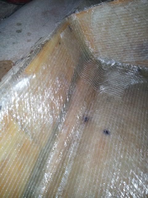

So this is the approximate cost of glassing materials for my 18' bow rider, provided this all is enough. It was a big question of mine, so maybe this will answer it for others. Keep in mind there is plenty of other expense. Wood isn't cheap, grinding accessories, ppe, etc.I've bought all that other stuff a little at a time as I needed it though.

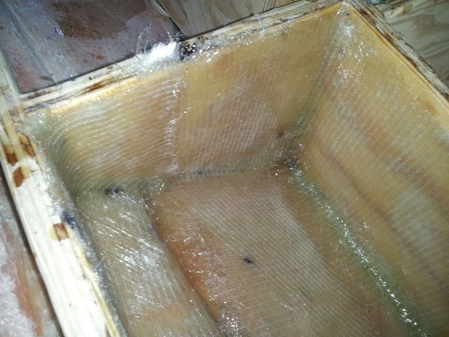

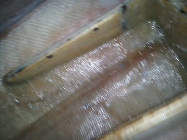

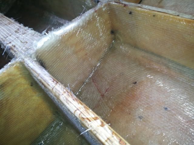

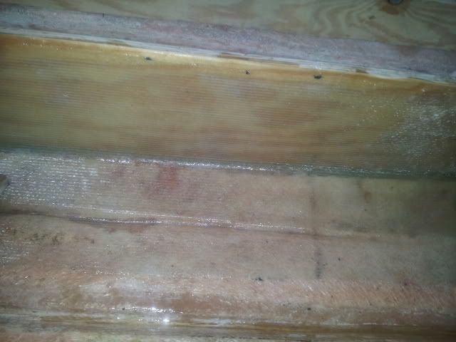

I ran out of cabosil and 1708 today. Placed another order of about 100$ for 10 more yards of 1708 and 5 qts cabosil.
Some pics of my glassing today. Turned out pretty well.
