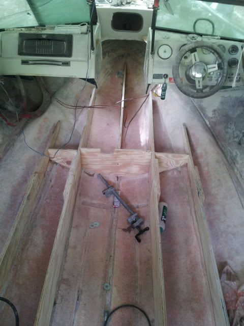

I appreciate it. It amazes me how much difference it makes. I can wiggle the stringers that aren't glassed, and even the ones that are only glassed on one side right now, a fair amount. But when I try to wiggle the ones that are fully glassed, it just shakes the boat. I can also really feel the hull stiffening up while I am moving around inside it.

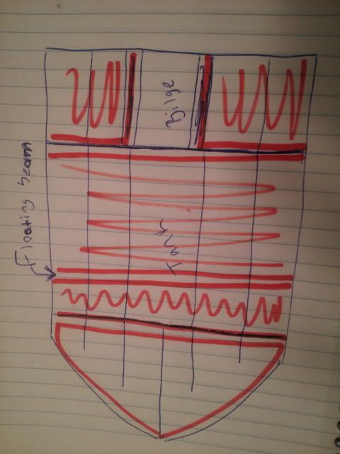

I have a question about cutting the pieces for my deck. I am sure that the strongest build will come from pieces that span the entire width of the hull. But, that is wider than 48", meaning I would have to cut the piece lengthwise across the hull, and have a floating joint after 48". I would most prefer to have all my joints on a stringer or bulkhead, if having the deck span the width of the hull in three sections isn't a large concern for strength. I have put together a couple crude drawings to show the two ways I see I can cut the deck.
The way I would like to do it, if it's okay for the main section to be in three pieces:
The other way I see I can do it, with two pieces spanning the hull, and the floating joint:
The sections are not to scale :p, so here's another picture to give you an idea of the sizes of each section.
Some 6 foot wide plywood would be nice! Oh well. Which way should I go with?
I would also go with two pieces wide I guess. One panel on the port side tank stringer to port side hull section, and another from port side tank stringer to starbord side of hull. Then I'm afraid I'll have one weak side if it's not all created evenly.

I didn't want any more floating seams than absolutely necessary. My layout was similar to your first drawing. I'd much rather have an extra seam, supported by a bulkhead or stringer, than have a floating seam (esp. if that seam was long).

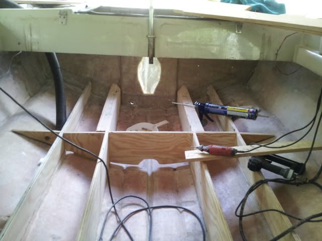

Decking installation and layout is supposed to be taken into consideration before or during stringer and bulkhead installation.
Drawing #1 on the notebook paper is unacceptable, never run the face grains parallel to the framing members... it always lays at a 90* angle to the framing. your decking will sag if you install it the wrong way.
Floating and cleated joints are also unacceptable (even in garden tool sheds and chicken coops).
For the strongest and longest lasting build, you only have one choice. Add bulkheads at your joints.
This will also help make your deck flatter and smoother, and it'll look that way too.

I did not know about the grain pattern mattering, good to know! As to the stringer layout, I only copied what was there.

There's no way to add a bulkhead across where my tank will sit, but maybe I can do it like drawing one with the grains going perpendicular.

Adding bulkheads won't hurt a thing and will make your boat stronger, and your deck joints more secure.

Alrighty. I have already expanded the bulkheads that were there to span across the boat, instead of being only in the center. The only area that is really of concern is the area over the tank. It is longer than 48". Would glassing in a 2" tall rip of plywood standing upright above the tank for the seam to fall on suffice in place of a bulkhead? If it is truly unacceptable for my decking's grain to run parallel to my stringers I will certainly run them perpendicular, though I was under the impression that plywood is non directional? Not trying to be argumentative. You all obviously know loads more about this than I.
The grain of the plywood at a 90* angle to the framing members is carpentry 101.
Plywood is built with an uneven number of plies per sheet. 3,5, and 7 are the most commom. The 2 face side have the most numbers of plies running in that direction therefore making it stronger when laid at a 90* angle to the framing.
If plywood had an equal amont of number of plies alternating (and there are some special types that do) it wouldn't matter... but 99% of all the plywood you'll ever buy will be built with an odd number of plies alternating.
