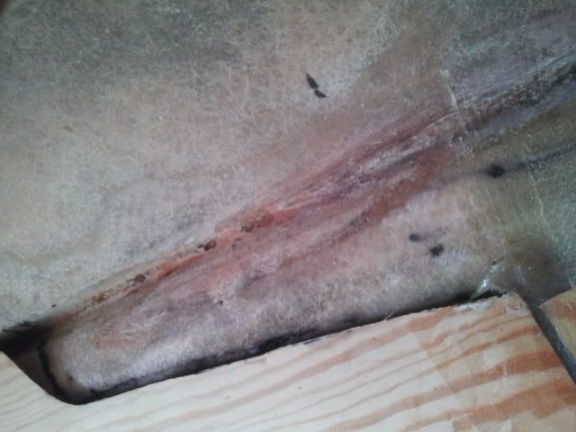

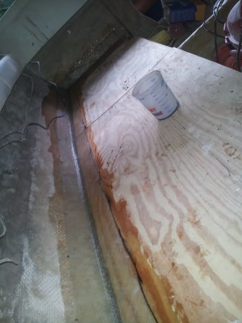

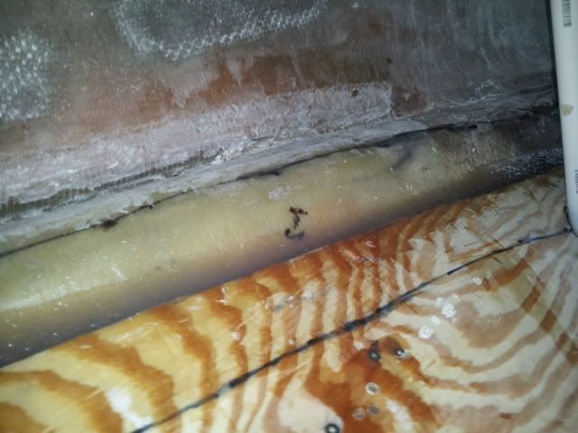

Filleting! Decided to stop for lunch. Ramen...yum! Bout all I can afford while I work on this thing lol!
I hoped to be tabbing by now, but of course there was the grinding and the sanding and the cleaning and the acetoning that I always underestimate...
Looks like I will use about a gallon of resin to fillet the deck. I have used 2 quarts for the bow section.
Woodonglass
Dec 29, 2009
25,930
Re: dixie hustler "deck job" (turned full rebuild)
FYI, you only need enuf to fill the gap and cove the joint a bit to help the glass go up the side. Less is more!!!!;) Make the cove as smooth as possible to cut down on any sanding needed before tabbing begins. Large plastic spoon dipped in Mineral Spirits really helps me keep the fillets smooth and a 6" plastic putty knife
mwe-maxxowner
Master Chief Petty Officer
Jun 20, 2012
825

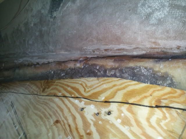

That last pic was before 'spooning' :D So far I haven't had to sand and fillets. I spoon it, then go back and wipe away the excess that mushes out top and bottom with a large putty knife. So far so good! Its taking forever to harden today. I used 12.5 ml to one quart, but I think maybe moisture in the air affects it?
Its only about 73? today, which is better for me than the 85 its been!
The fuel hoses shifted the bow piece on me as I started screwing it in place, so the gap was too large on one side, and I had to trim the edges with a flush cutting blade on my oscillating multi tool on the other side to prevent hard spots. I guess the large gap ate up some resin.

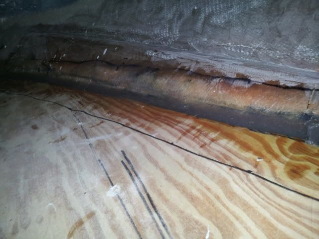

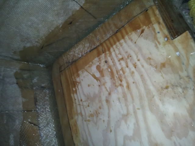

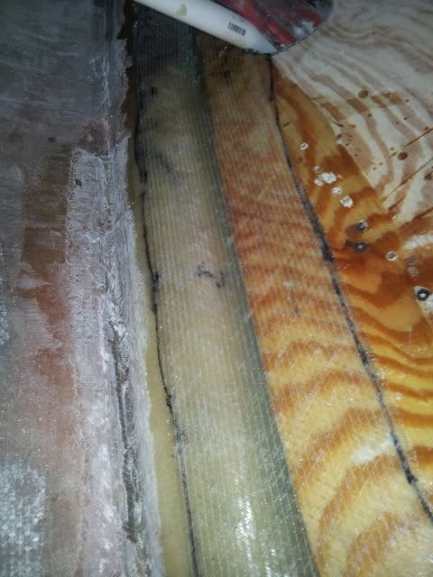

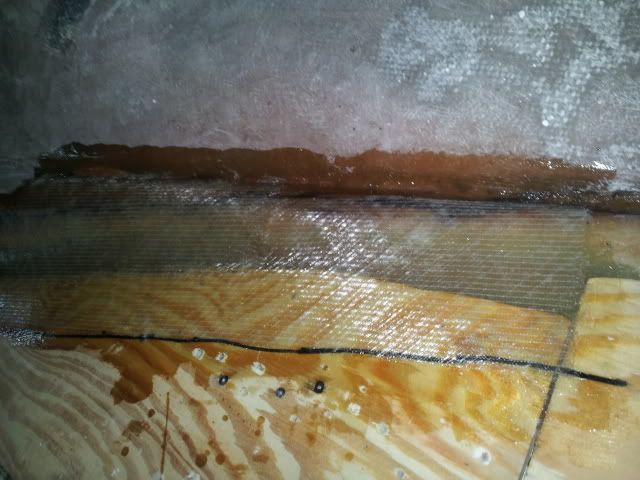

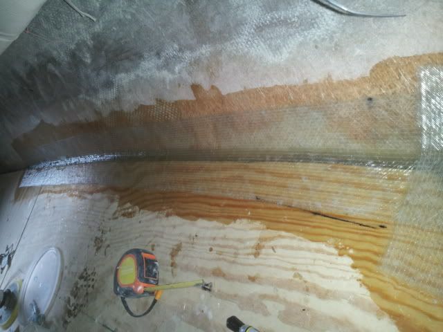

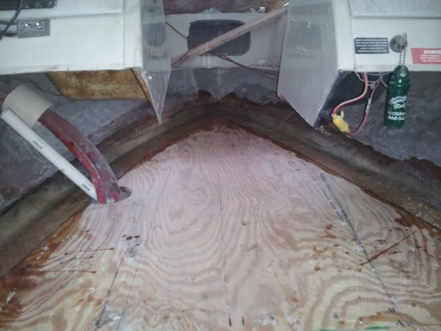

Bow section
Starboard side
Soda right under the drivers console
Port
From this...
To this
mwe-maxxowner
Jun 20, 2012
825

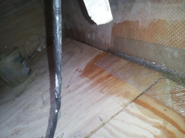

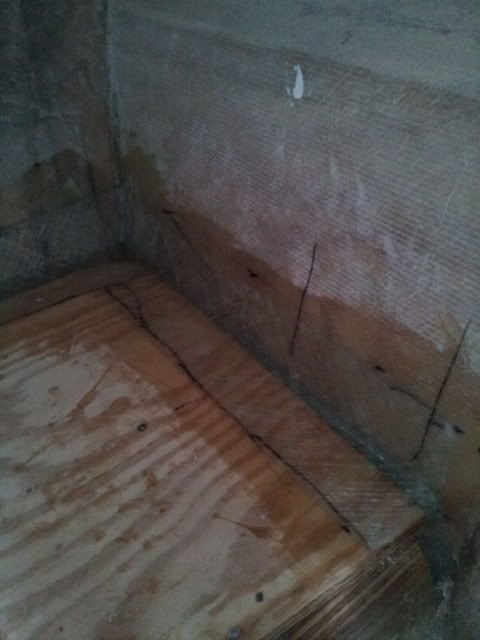

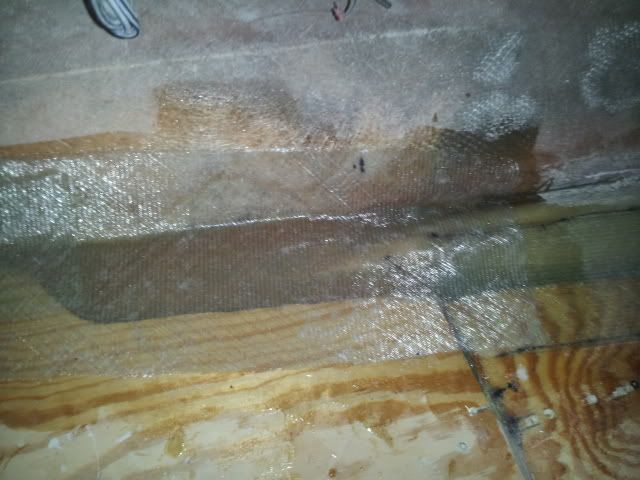

Starboard at the transom
I ran out of cabosil on this batch of peanut butter and had to use all purpose flour :p
Aaaand that's where I stopped since I had no more cabosil. I did do some other grinding and sanding too you don't see. All in all a decent day, as usual didn't get done as much as I wanted, but I took my time and I think I all turned out nice. I have no bubbles in the tabbing to contend with!
