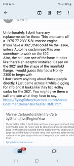

This is a reply from mikes carburetor wich from what I understand this carb doesn't belong. Any input on what he says

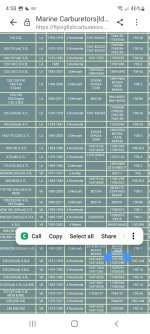

Also shows a holley 2 barrel

And you can buy a Holley Marine 2 bbl carb brand new; better than remanufactured which is what you’ll get from Flying Fish Carbs. Yeah new costs more….
0-80320-1 I believe is the # of the Holley 2 bbl calibrated for the 302 cu in Ford.

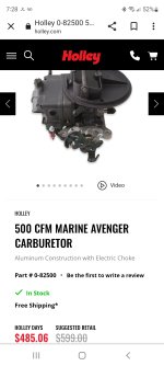

Correct?
