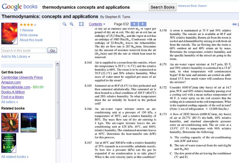

You really doubt tank condensation? Have you ever had a basic thermodynamics class? Can you solve problem 8.171? I'll do it at lunch, don't have time right now and it's been a while since I've had to do any tank calcs - have to dig up a psychrometric chart.
