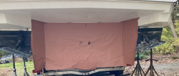

I got some detailed dimensions and patterns off of the transom. I used paper to create a template for making the shapes. It seemed to work out OK.
There are 4 pieces that will make up the contact area of the extension pod: 3 pieces on the transom and 1 piece on the underside of the swim deck. I figured it was best to template the transom-mating pieces and the 'upper' piece can be made from measurements.
After some marking, cutting and 'truing' up the shapes, here is what I have to outline the pieces on the Coosa board.
These are the sides that will mate to the transom. I got to bang the rust off my geometry skills and figure out the bevel angles on the cuts. . . basically 12Ëš and 60Ëš from my previous measurements.
I also have treated the transom contact areas with paint remover . . . probably going to need to soak in for a couple of days.
My plan is to get as exact enough fit to the transom that when the extension pod gets mated to the transom, the adhesive used to seal the extension can be uniform thickness, not having any excessive gaps to fill.

I have the 4 'transom mating' pieces secured to the transom with a about a 3/32" 'spacer' all around to mimic the fiberglass thickness. (Pics to follow in the AM.)
Temperatures barely hit 60ËšF today . . . more like 57ËšF. I am having to tent the work area after the glass layup and apply heat. Much of the fabrication/glassing will be done in the garage, which can be heated to about 68ËšF. For the stuff that has to be done outside, I'll have to figure out a better method of tent + heat. Right now, I'm using 2% MEKP and kicking the resin with a heat gun in some cases.
