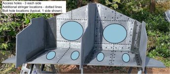

Thinking about next steps . . .
At some point (soon), I'll need to cut some access holes in the mating surfaces of the Ext-Pod. These holes (obviously) would be needed for installation and maintenance . . . and probably fabrication. I'll be making a matching set of holes in the transom and underside of the swim deck cavity.
My thoughts are smaller is better . . . and round is better than square. :unsure:
There will be a stringer running in between the 2 smaller holes on each side, and crossing stringers above & below the large access holes . . .
The smaller holes need to be large enough for access to fastener (bolt) locations.
The large access holes will need to be big enough to fit my fat torso into the Ext.Pod to do the fastening, etc.
Sort of like this . . . bolt holes shown 1 side for illustration purpose.
The transom modifications in the boat will match those additional stringer locations (dotted lines), so there is something substantial to bolt through.
Thoughts/comments welcome . . .
