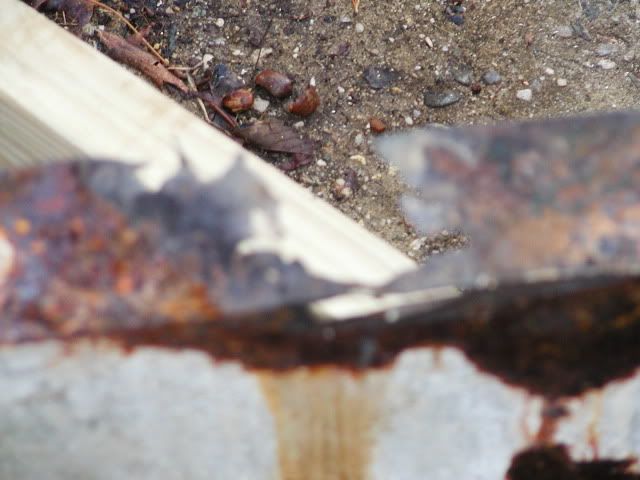

It was a bit hard to tell if the 'black' area was rot or if it was just the resin layer of the wood, because when I pried the FG skin, the plywood tended to fracture in some of the areas. Here is one of the pieces that I 'skinned' . . .
You can see it separated at the resin layer, which looks dark. The wood in both areas was very wet, but still solid. So, with the two other areas that I plan on opening up next weekend, I'll be applying heat and letting everything dry out for a while.
