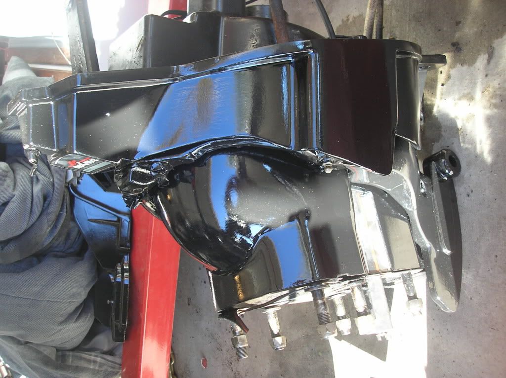

Btw,....That black motors lookin' pretty Mundane,...
No Lime Green, eh,..??
I'm a pretty simple guy but the green would have been a nice touch.
I did find this at the iboats store but theirs no pics.
Gimbal Housing Bolt Headnut (2) for Mercruiser # 55989T 9 (maybe)
Ayuh,... I would think so, as the rest of 'em are Studs, 'n nuts...

Did some more research and I think they are called anode bolts. They seem to be only avalible in a kit that runs about 50$.

damn.. is there a marina near you that you can confirm that with.. before you pay the 50 for it..

Anode Kits
These anode kits are complete with fasteners and gaskets where required.
Use Aluminum Anodes in salt water.
Use Magnesium Anodes in fresh water.
Zinc is no longer used.
You can also view our Anode Selection Chart.

That's a good ideal. Wish I would of thought of that before I ordered them. We will see what shows up.

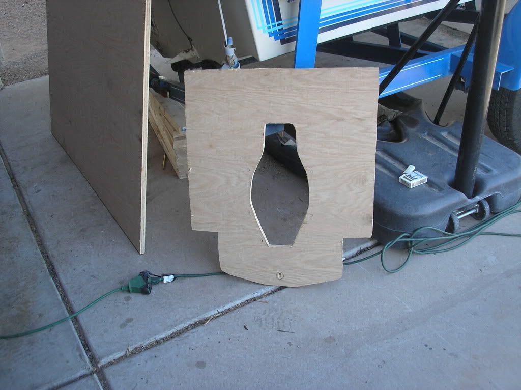

Got a day off work, so I played a little.
produceguy
Sep 30, 2010
1,243
Re: Replaceing deck on 88 Mack 1
I,ll let her dry for a couple days then glass it in.
