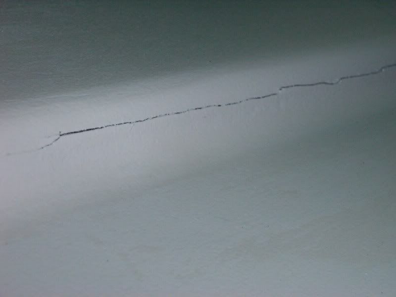

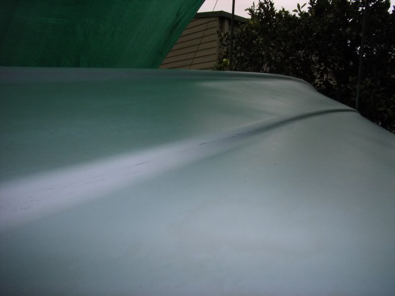

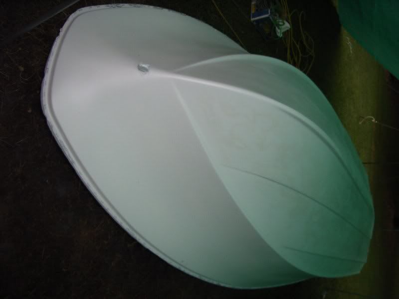

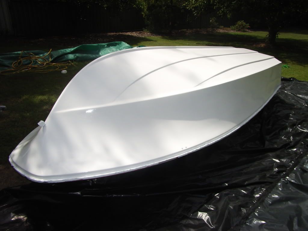

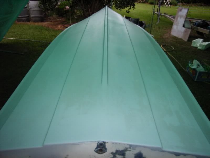

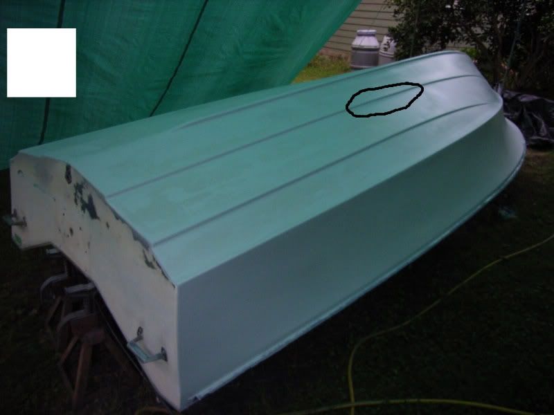

Managed to get some high fill primer on the hull today. Ended up just giving it a quick sand with 180, blew it off and wiped over with tack cloth. Then put first coat on.
Went on pretty nice, but showed up a few hairline cracks. Not sure if i should just fill these with gelcoat filler or what. The worst crack is pictured first.
This crack is at the left hand side where the floor meets the hull. Circled in 2nd picture.
I noticed the primer was going a bit patchy after an hour or so, as you can see in the last pic. Im hoping its not the thinners eating the old paint underneath. Will probably find out tommorow.

HI dcr42t.
That crack, looking at your photo. Looks more than cosmetic.
You might need to do a repair from the inside of the hull.
If as you say, this is a meeting point for floor and hull, I would remove the floor to find more information.
An external patch. IS NOT A REPAIR.
Paul.

That crack DEFINITELY needs repaired. Grind it out, fill it, glass it, fair it and then prime and paint it. Not sure about needing to go on the inside but for sure needs the above, NOT just gel coat filler.

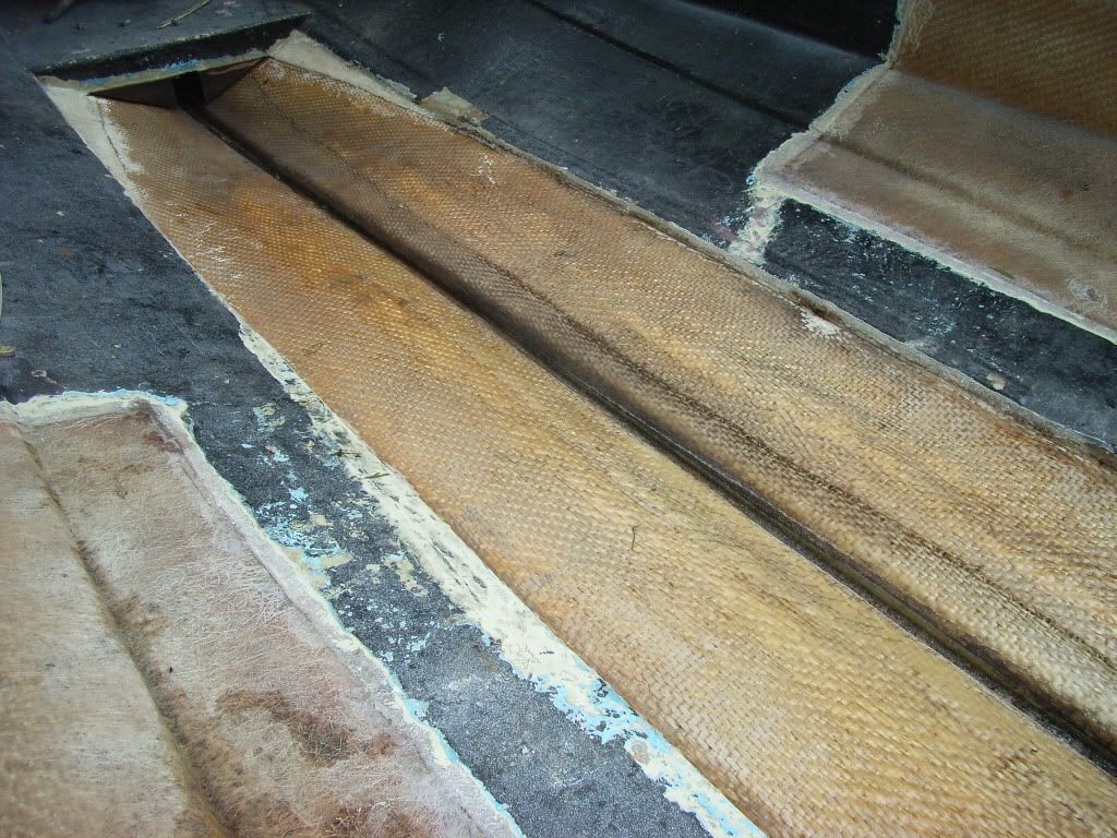

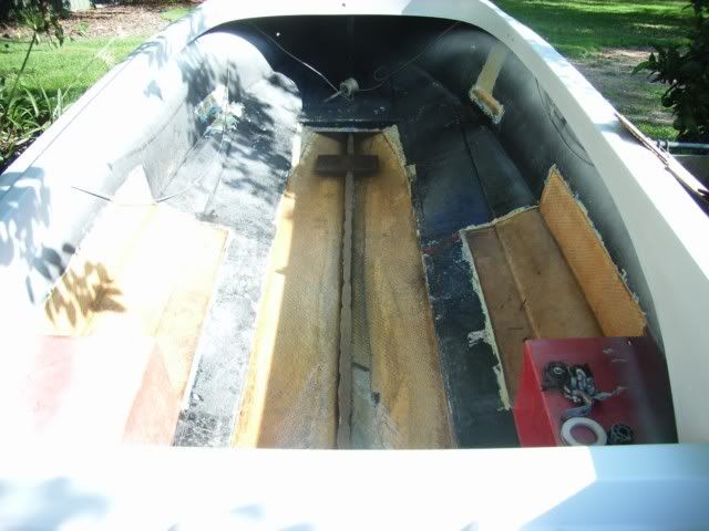

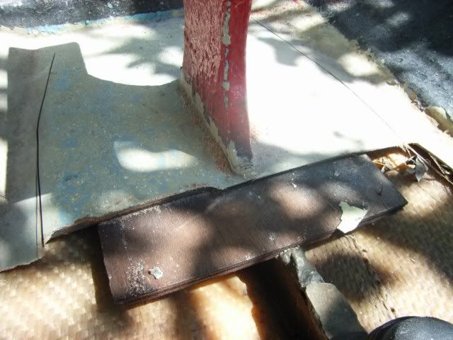

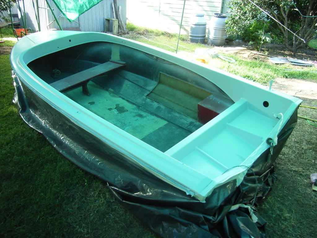

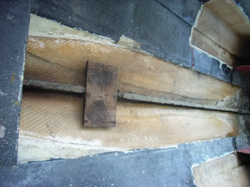

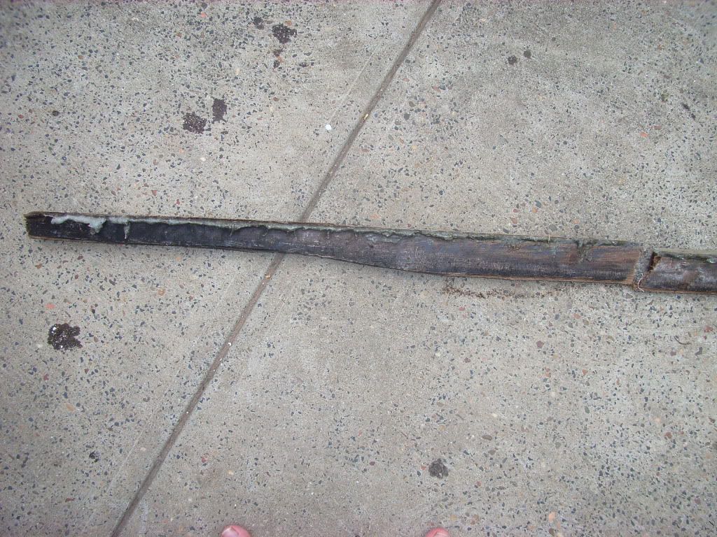

I have repaired the crack externally with fiberglass, but now that ive pulled the floor i will try and find the crack on the inside and repair.
It looks like the stringer is just sitting in there. Can be wobbled side to side. Looks like its rotted on the bottom, so i will be replacing.
This is how its looking so far.

Hi DCR.
Looks like you are doing a great job.
You will be much happier with a proper internal repair, than just an outside patch.
Surprising amount of room appears once those side thwarts are out.
With just a single central stringer, you will have an easy job of lifting your floor/sole up to give you more flat area.
Keep up the good work, mate.

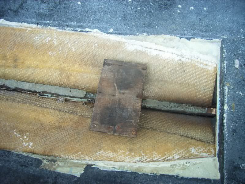

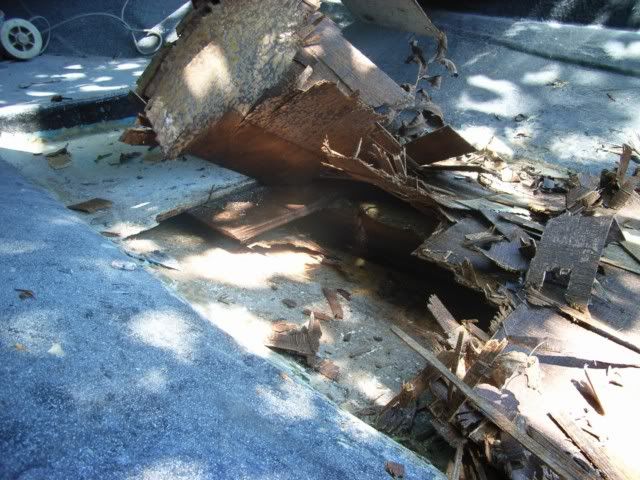

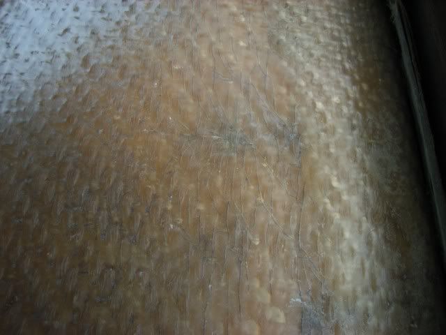

Havent been able to find the crack on the inside yet. Maybe its not cracked right through. Its something i have to have a better look at.
I wasnt really planning on lifting the floor. Its a pretty shallow boat as it is. Plus it makes my life harder. I think id be happy just to have a water tight hull once the floor is in and sealed. Id have to use heavier decking if i was to raise it using 1 stringer aswell.
Thanks for the thought though. I could change my mind on this with a bit more thought.

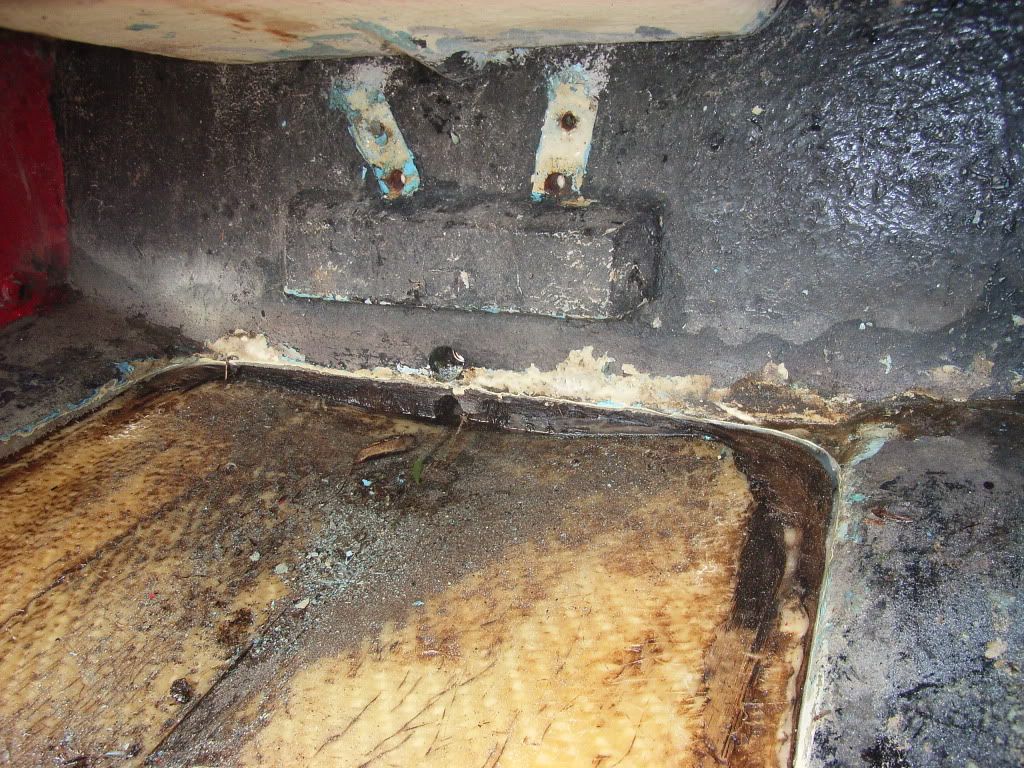

I cleaned up the hull edges a bit more with a 4inch angle grinder and flaper wheel, and got in under the splashwell which wasnt fun.

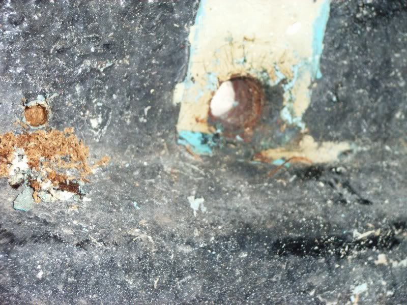

This allowed me to see the base of the transom which looks rotted. Im hoping this doesnt travel to far upwards. What are your opinions? I wont be replacing it, as that is way over my head at the moment. The transom feels and sounds fine otherwise. If the lower 1/3 is rotted, is that enough to mean it needs a full replacement? Or will it be fine?
I think ive decided to use external plywood for the deck. Not sure on resins and matting. Ive read that the fiberglass you buy from shops in plastic bags is usually 1.5oz. Is this the chopped strand mat i need or do i need thicker stuff? I realise i will have to buy this off a roll or in bulk form. 1.5oz csm is what i used for my external repairs, not really knowing if it would be strong enough.
Just say i cut my new floor and place it in the boat, and have a 5mm gap between floor and hull. Will 1.5oz be enough to place over the gap? The original floor seemed to be a very tight fit at the edges. Hope im making sense.

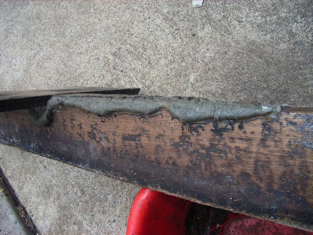

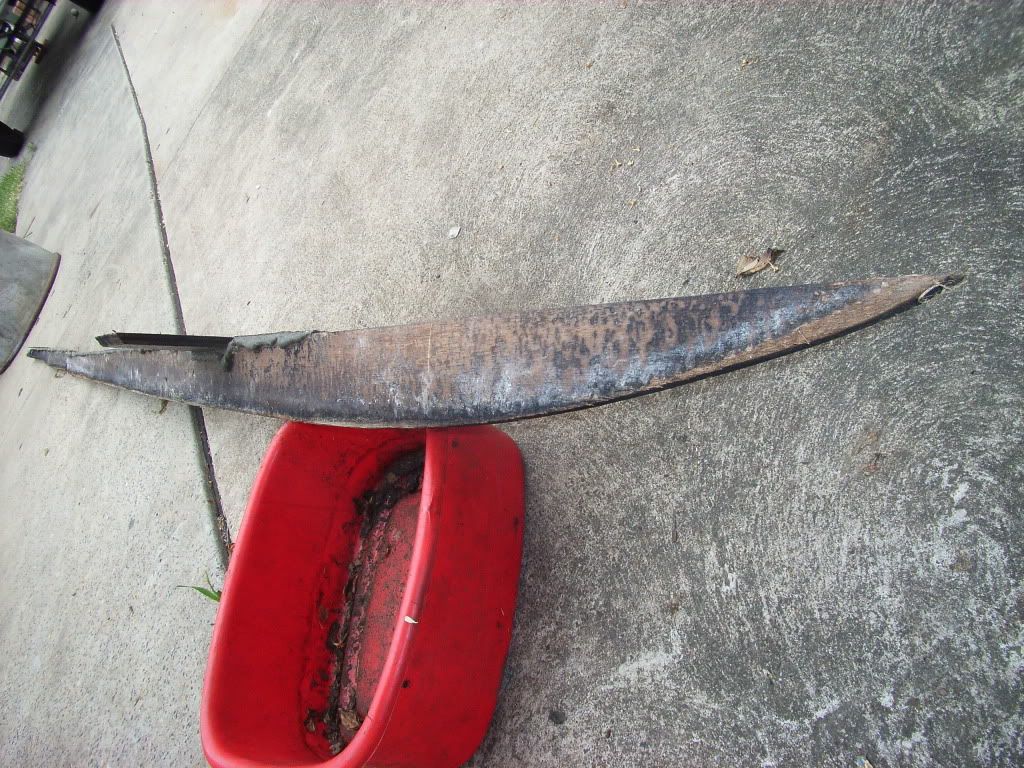

Heres some more pics so you can see whats going on.
Is this peanut butter that is often mentioned, that they have used between stringer and floor?
HOOKED.UP
Mar 11, 2010
52
Re: Savage Avalon
Hi DCR.
If the bottom of your transom is rotted there is a pretty good chance the rot, has spread right through the transom.
The first place water gets in is the bolt holes drilled for the engine bolts.
Then of course there are the lower drain plugs. These holes are never sealed by the factory or engine installers.
So, I guess what I am saying is, take the top off and do it properly.
The easy way of doing this, once you have let the gunwales go, is to get a few mates around and lift the top off.
Exterior ply is fine for this type of work, as long as it is good quality. Marine ply is better, but a bit more expensive.
As for your glass requirements. Go to a proper fibreglass supplier in your area and purchase your CSM and polyester resin from them. The CSM can be bought by the metre, the resin is sold by the Kilogramme.
They can also advise you as to cloth weight etc.
