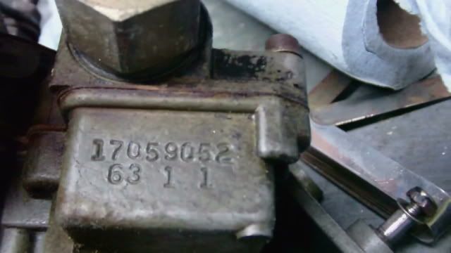

Now carb rebuild time. Going to splash mine last week of july or sooner. Thats when I go on vacation. GOt a question for ya, my carb's tag is gone I think we have the same one just curious what is your tag number on your carb. gotta find a rebuild kit. Man never noticed that lower unit before, what got a hold of it:eek:

If its a two barrel like mine use the numbers on the side. Go to napa & u can get a rebuild kit for this 2gc carbs. They offer the float seperately. Heres the link.
https://www.napaonline.com/Catalog/CatalogItemDetail.aspx?A=CRB25494A_0214455883&An=0
Good luck. :)

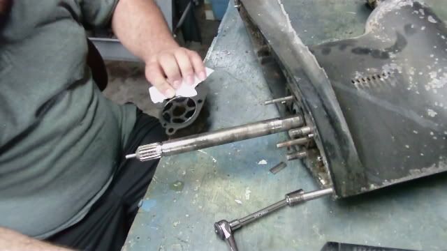

OK so for now it seems i need to go ahead & repair this drive and deal with it this year or until I can get a new or rebuilt one. So I went ahead and install the water pump. But have run into a little dilema wich has made me do some serious reading. If you notice the old impeller the vanes are facing as if the shaft was moving counter clock wise.
I was gonna install the impeller the same but for grins & giggles :rolleyes: I read on the correct way of installing or direction of the impellers blades. It seems it doesnt matter since they position themselfs to the drag (not to scrape) on the housing to the direction of the turn of the engine. Wich in this case is counterclockwise. Looking at the front of the engine it turns clockwise, looking at the flywheel it turns counterclockwise. You guys dig? So I turned the shaft same way of the flywheel and turned the blades to drag that direction. Ok so far except that when I compare it to the old impeller it sits opposite!
Ok,, no problem. According to reading it will be ok, right? Because it automatically straightens itself out. OK, so why does the old impeller facing as if it was scraping the housing instead of dragging???? :confused:
Woodonglass
Dec 29, 2009
25,930
Re: 1968 Holiday Restoration w/pics
Sometime they DON'T reverse themselves and WILL run in the housing in a scraping mode. Appears this happened to yours. Been Known to happen. I ALWAYS install em to DRAG!!
