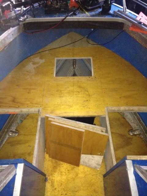

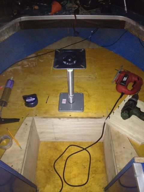

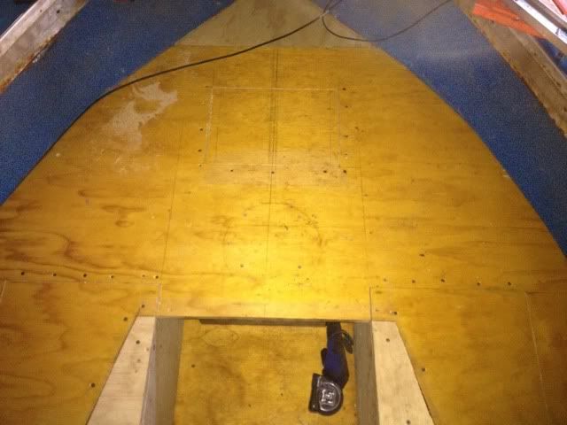

A bit more progress.....
I was able to replace the steering cable without having to remove the motor. Yay!
Also cut 3 hatches in the casting deck
Got the pedestals shortened on the main driving seats also.
Still plenty left to do though.

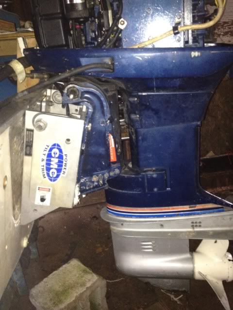

Huge update!
I put an ad on CL looking for a power trim unit for my 1977 75hp. Got a call about 30 mins ago from a guy that has a 1979 Stinger 75hp with CMC power trim. As long as I remove the motor from his boat....I can have both the motor and CMC power trim/tilt for $300 bucks!
He says the motor runs strong....but lower unit is busted. He just had motor tuned at end of last season. Seller is at his Florida home, so his son is going to give me a hand getting the motor. We're going to pick it up Easter morning.
I'm def pumped....been wanting power trim/tilt for awhile now. And now I'll have a spare motor also.

Re: 1975 Super Sport 16' boat requesting admission to the Starmada! (2nd Splash compl
Hey BA - that's a darn good price on the CMC even without the motor. They usually go for $350 and up. And you might get a nice chunk back if you decide to part the Stinger.

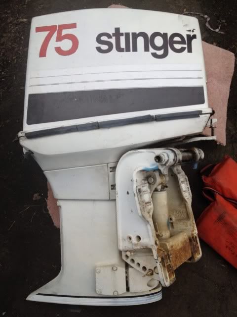

Drove out and got the Stinger this morning. Took me 90 mins to get the controls and motor off the darn boat. The seller's boat had a tangle of wiring I had to sort thru to get to the TNT and controls wiring. Ended up putting the motor on a plastic snow sled and slid the motor the 40yds to the car. It worked it very well.
Got the TNT installed on my boat pretty quickly. The pigtail that holds the 2 solenoids is a bit loose, so I'm probably going to have to buy a new pigtail.
Here's the motor that came with the TNT.

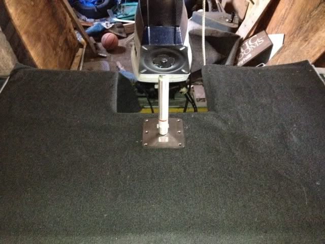

A little more progress tonight.
jbcurt00
Oct 25, 2011
25,238
Nice Stinger OB
Seat pedestal looks good too.....

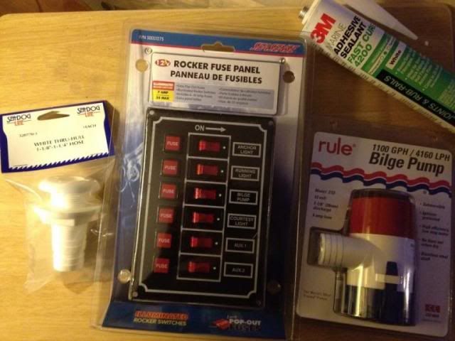

My iboats order arrived today. Going to have make another dash panel to accommodate the fuse panel....or mount it somewhere near the helm.

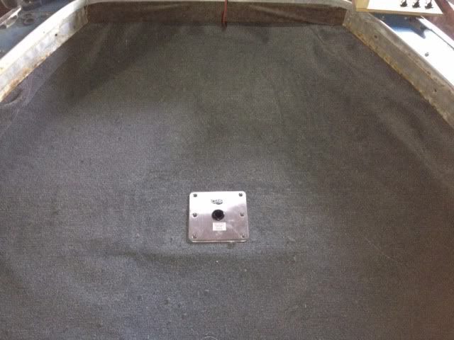

Carpet install started. I won't glue it down til later this week. ( It's about 25 degrees outside right now).
Rear casting deck
Bow casting deck (carpet just laid in place...not even tacked down)

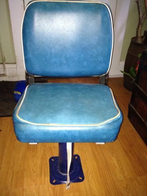

Ok...now I'm leaning toward these seats
Deluxe High-Back Fishing Seat - Gander Mountain
Not sure what color would look best with my boat(and carpet). The gray seats make me wonder if they would blend in too much with the gray carpet. Red would really "pop" , but Im worried that color might be a bit "too much"...if you know what I mean. Normally I would be gravitating to blue, but these are an odd shade of blue.
Any/all opinions welcome....
