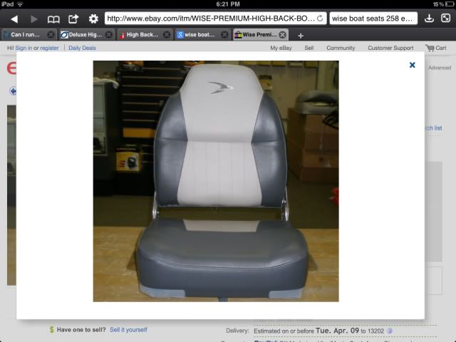

Those are nice seats. I like the gray or the blue. My boat has a cool grand worth a seats in it :eek:

i spent as much on ONE seat as the boat/motor/trailer cost me.......:rolleyes:
A thousand bucks on seats?? Yikes!
Here are a couple more realistic pics of the seats

I pulled the trigger on the gray/charcoal seats. $79.99 each with free shipping. I paid $8 bucks total to upgrade to 2-3 day shipping.
The seats are pretty much the last pieces of the puzzle to finish up my resto. Painting the hull may be a possibility later this summer.

Ezmobee...thanks for suggesting better quality seats. Didn't want to spend more money....but in the end, I'm sure I'll be glad I did.

I love spending your money :D
I like the gray. Good choice. I can't wait to hear how it performs with the CMC unit.

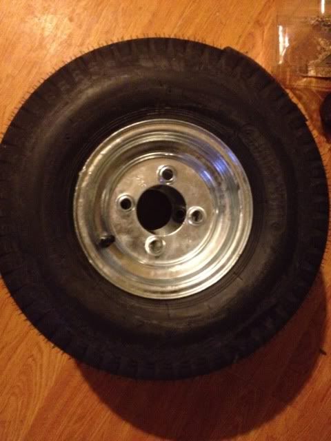

Tires arrived.
4 tires to support a 16' aluminum boat seems a bit excessive....but I'm not going to go to the trouble/expense to convert the trailer into a traditional single axle.
Here's a pic of the trailer for those who haven't seen it
Now, at least I'll have 4 tires of the same size on it. :)

Completely silly trailer you got there Bonair :p:p

BA - No one is gonna ask if the boat is too heavy for the trailer. The good thing with a light boat and four tires, is two flats won't slow you down as long as you keep the flats on the same axle.
What size are the tires? Or maybe, what size did you decide on?

Each tandem side pivots. For example one of the front tired goes flat...that rim will touch the road. So I don't think I can continue if a tire goes flat. I'm not sure though. It's a weird setup.
The tires are 5.70 X 8. They are rated for 715lbs each.

You could always put a strap on the side of the axle with the flat. Should hold the rim off the road.
And you have four spares now too.

. I bought 2 tires to replace the smaller tires in the front. The sidewalls are cracked, but I guess they would work in a pinch.

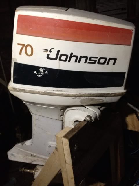

On a side note: I picked up a 1979 Johnson 70hp from CL. Seller said it hadn't run in 2years...but I took a chance on it for $200 bucks. I figured, worse case scenario; I would steal the LU for my '79 Stinger.
I checked spark......good
Compression- 120psi on all 3 cyls :)
Hooked up a set of controls and fuel tank.........she fired up in a about 5 secs.....and idled nicely. :) I've still got to clean up some of the cowling foam that mice tore off, but other than that she's in good shape.
I rolled it out front and put her up for sale for $650. I've got a guy coming to take a look tonight. I'm starting to take a liking to buying and flipping boats/motors.

just saw the pic of the trailer. tires by Mr. Donut...... ;)
with all the profit from the motors, do the single axle conversion. problem i have with little donut tires is how much faster the bearings are spinning compared to with larger tires. and with 4 of em, it seems like this thing is a bearing rebuild/replacement by the side of road waiting to happen. i'd sure be fanatic about lube if you keep em.

Single axle conversion would be a "next year" upgrade. My local lake is only about 10 miles away so I should be fine with what I have(knock on wood).

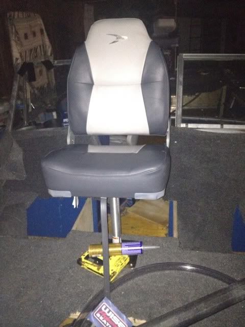

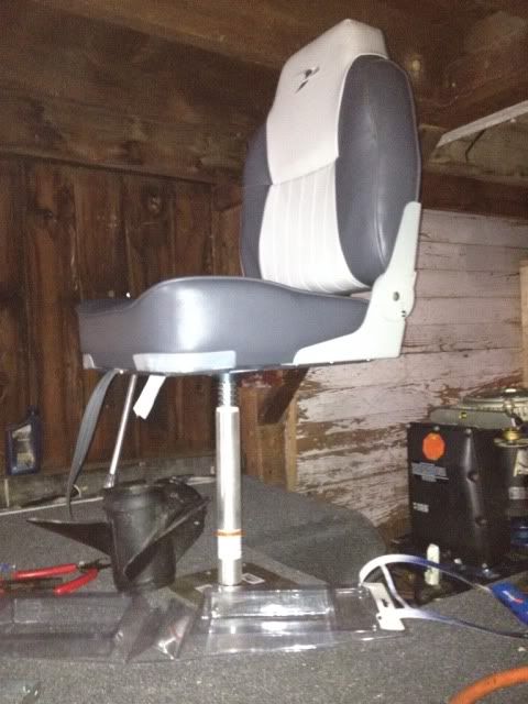

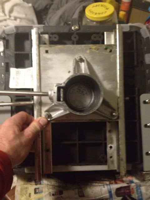

Seats arrived today. I mocked up the bow/stern seats...I haven't bolted the bases down yet
The sliding seat bases I stole from another set of seats I have....are too wide to fit the mounting holes on the new seats
So I'm going to have mount some plywood on the bottom of the seats...and then bolt the aluminum bases to the plywood.....unless someone can suggest a different way to get these bases mounted to the seats. I'll check HD and Lowes to see if they sell some kind of metal plate I can use instead of making ply bases.
I'm open to any suggestions on how to cheaply get these bases mounted to the seats.....

I'd look at maybe the cheapo cutting board material before putting ply or steel in.
If you could find a thick piece of alum at the salvage yard would be the other thought

BA - what is the gap between the mount and slider?
