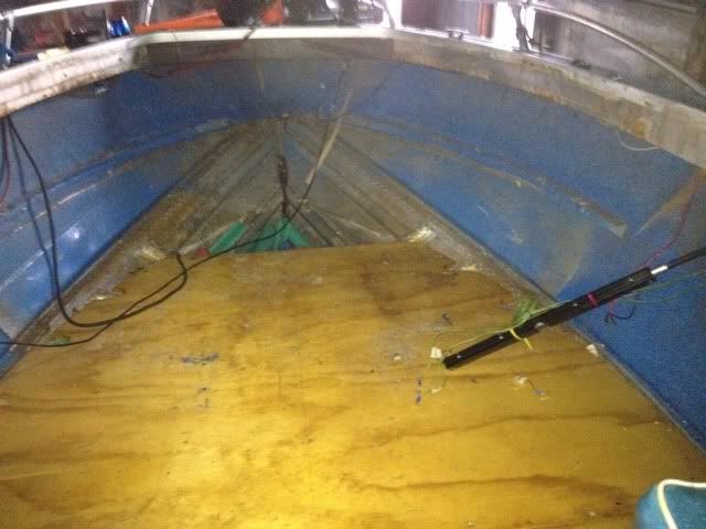

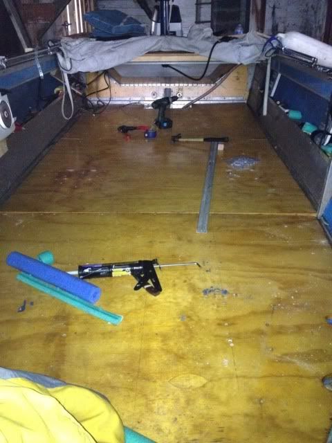

The de-construction continues...

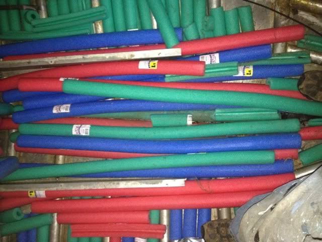

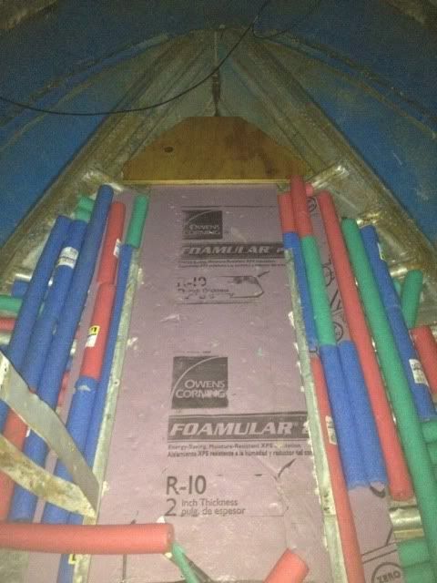

Now that the boat is somewhat stripped down, I can start putting in the pink foam board. Went to Home Depot and bought a couple sheets to get me started.....and somehow the lady only charged me $17 bucks a sheet!!! :) I'm going to use the noodles to fill in gaps etc.

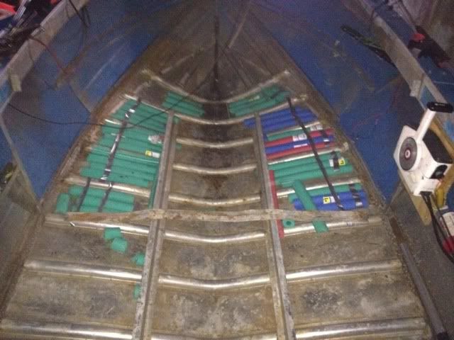

Got the front of of the boat fitted with foam/noodles
Now on to the back half. Hopefully, I'll have the rest of the foam finished by tomorrow night.

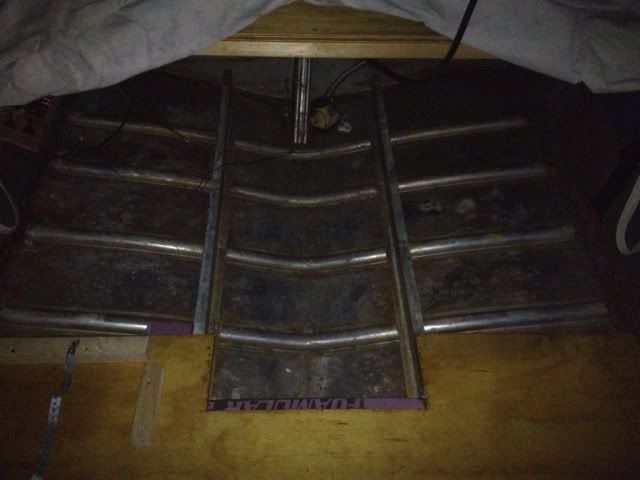

Re: 1975 Super Sport 16' boat requesting admission to the Starmada! (2nd Splash compl

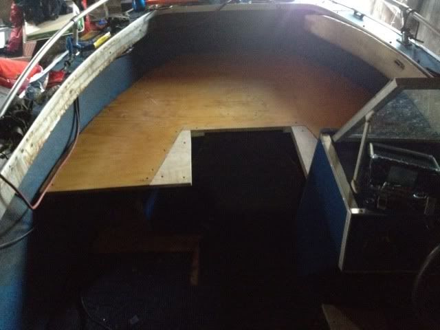

Finally finished fitting all of the foam and noodles under the floor. I was able to stuff (2) 2"x4'x8' sheets of foam....and 35 noodles under there.
The front and rear sections are riveted down. Once I get the pedestal mounts bolted down to the deck...I'll rivet the middle section of the deck to the stringers.
I'll probably re-install the consoles next....and then get cracking on the bow casting deck.

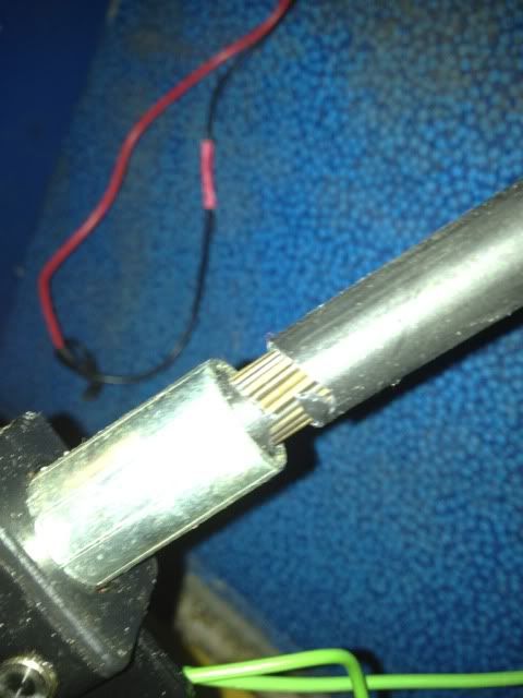

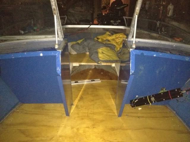

Got the consoles back in.
And then I noticed this :(
I have no idea how long it's been like this. According to Uflex website, it should have a 2 yr warranty...so hopefully they won't give me a hassle and simply send me a new cable.

Did your center window lie up OK, BA? Sometime a new floor throws the console height off a little.
How long have you had the Uflex? Sure hope they honor the 2 years.
