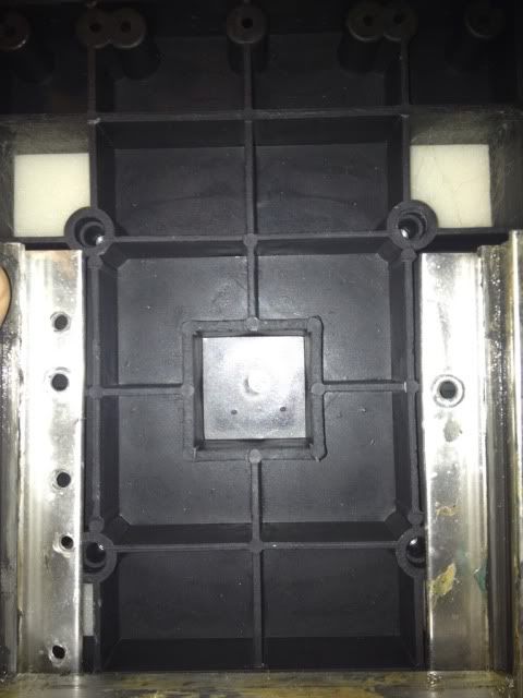

This is a better pic.
It's just a tad wider than the mounting holes

I was thinking you could get some AL strap at one of the big box stores and do something like this.
htt p://
Your second pic shows the four screw mount points better. Use strap that's the same thickness as the slider base. And some washers as spacers so the strap is even across the base. Might have to notch the base a little. I show the strap angled - that's so the base won't move around. If the strap is at right angles to the base it will tend to walk or slip. Hope this makes sense.

Seats look great. What a pain about the mounting. I'd much rather see you use some kind of metal plate as opposed to plywood.

GA, not sure about the metal strap idea.....seat mounting is a safety item and those mounts will be subjected to a lot of stress. i'd use a thick (3/8 would be plenty) hunk of aluminum, probably mild 6061.....easy to drill and countersink, strong, never corrodes, light.....hey, they should build boats out of it! oh......:embarassed:

OK - How about this? Weld some tabs or strips on the base, same thickness to widen it. I have plenty of ideas when I spend your money.

Solved the issue....found some flat bar stock the same thickness as the bracket. Mounted the flat stock to OEM mounting holes in the seat....and bolted the sliding seat bracket to the flat stock.

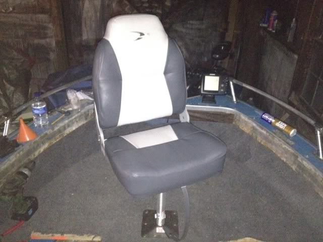

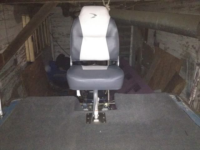

Got the bow and stern pedestal bases bolted down

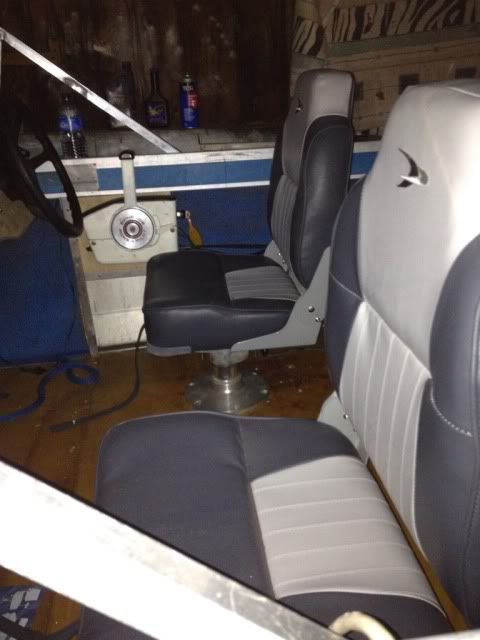

BA - Those are nice looking seats. I like the swooshes on the head rest. Kinda sets them apart. Did the mounting trick work out OK?

Yup. I only had to use the flat bar stock on one seat. The other sliding seat bracket was different...and I was able to bolt it on without much trouble.
Bilge pump and thru-hull fitting installed today. Sealed transom bolt holes with 3M 4200. Cut side panels(going to be carpeted).
Carpet glue will be here tomorrow. Should have all carpet done by end of weekend.
