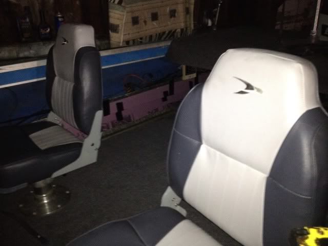

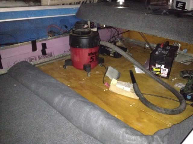

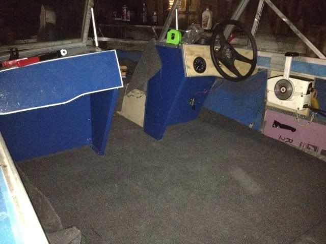

Lots of progress tonight.
Got the bow and stern casting decks glued down.....and 95% of the main floor.
The weldwood adhesive was easy to work with, although it tacks up quickly....so working small areas at a time is best.
This is from DAP website:
1. Lay out floor covering according to manufacturer’s instructions.
2. Apply adhesive evenly to clean floor using recommended trowel size.
3. “Legs” must develop before lowering the carpet into the adhesive. To determine if “legs” have developed,
place a scrap piece of material into the adhesive-then pull the scrap away. If strings or “legs” appear,
proceed to step 4. If no “legs” appear, wait 5 minutes and repeat this step.
4. Once “legs” develop, lay the floor covering into the adhesive. Roll in both directions with a 75 pound roller.
If installing foam or sponge backed carpet, use a cardboard carpet core to smooth out the carpet.
5. If bubbles occur, insert an awl in the center of the bubble to allow the vapor to escape, then smooth it out..
6. If necessary to make seams, follow the manufacturer’s instructions to seal the seams and complete the
installation.
7. Do not expose to heavy traffic for 24 hours.
I got the casting deck hatches glued also. A lot of trimming etc left,...but the finish line is def in sight.

Looking great!
Seats look great w/ the blue paint & gray carpet.
Did you use a notched trowel to put the adhesive down? If so, what size notch? How much working time would you say you had? Any other pointers? Thanks.
BonairII
Jun 7, 2011
2,727
Re: 1975 Super Sport 16' boat requesting admission to the Starmada! (2nd Splash compl
I used a 3/16ths v-notch trowel. Google the Weldwood stuff ...DAP has instructions posted on their website. Def wear gloves....it's a bit messy.
Put some of the adhesive in a separate container and reseal the gallon can....while your working an area.
Tonight I'm going to try and get the side panels carpeted.....the hatch panels trimmed and fitted...the tilt/trim switch attached to throttle handle...
I'm still debating whether to re-install the sliding doors, or possible make a hinged split panel(carpeted) to cover the area under the splash well.
My thinking with the split panels(vs the sliding doors) is that I can mount rod holders(or whatever) to the panels...thus utilizing wall space normally lost if sliding doors are there.
