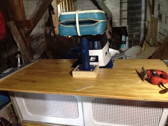

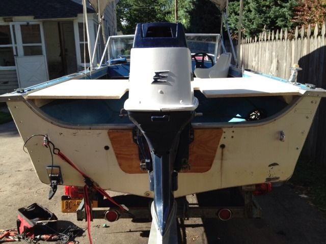

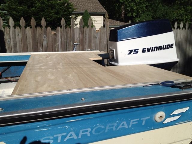

Casting deck cut and dry fitted....

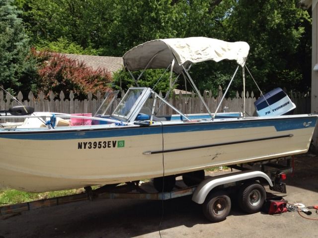

that is one weird trailer....tandem under a 16' tinnie that maybe weighs 600#?? and with either 8 or 12" wheels?
are you planning on making the casting deck removable?
Yeah...trailer is weird. I stole the "almost new" tires from my other trailer and mounted them on the tandem....so I have 2 diff sizes on it now. The trailer obviously tilts toward the van because the rear set of tires is larger than the front set. I'll be replacing the smaller tires soon.

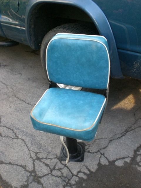

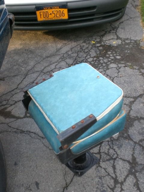

Scored 4 folding swivel pedestal seats off CL today for $10 bucks each. The bases need a little sanding/paint, but no tears or stains on any of the seats.
I'll eventually get better seats/pedestals.....but they'll work just fine for as long as I decided to keep them.

To be honest that casting deck looks a smidge precarious mounted all they way up top like that. I built mine down in the boat a bit: http://i176.photobucket.com/albums/w200/ezmobee/New Boat/IMG_0483.jpg
http://i176.photobucket.com/albums/w200/ezmobee/New Boat/IMG_0487.jpg
Do you have a service manual for your motor? They list the WOT RPM range. (if you don't have one, you should absolutely buy this NOW http://www.ebay.com/itm/REAL-OEM-FA...anuals_Literature&hash=item4ab81fabab&vxp=mtr)

...Haven't thought about making the rear casting deck removeable. Any ideas how to do that?...
I would double check the width of the cut out for the motor for steering radius and tilt when you are have the engine up. Looks like its a tight fit from the pic. You could use quick release ball lock pins to hold it in place, and easily remove the pins to remove the casting deck.
I've tested the fitment with motor up and down and turned in both directions....I made the opening "just right".
So far, I've just cut out the shape of the casting deck and haven't come up with a way to attach it to the boat yet. I've thought about bolting 90 channel on the inside of the gunwales....and letting the deck rest on it.
I'm open to any/all suggestions regarding bolting the deck to the boat (including making the deck removeable)
I'm also waffling on the final size of it. Currently, it's 36" deep which means it runs past the splashwell(toward the bow) by about a foot. If I leave it that way, it will give me more storage room under the splashwell area but will take up floor space in the boat. I'm going to mock up the deck with one of the swivel seats and see if I'll really need the deck to be that deep.

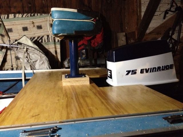

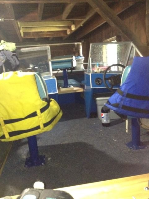

More progress today....
Painted the seat bases then installed them (will be painting the black brackets on the seats later on)
Installed the casting deck seat. Casting deck just needs the front edge supported to be complete.
Installing bow seat is next project. I'm going to have to relocate my fishfinder to the starboard side of the bow, so I can see the display from the helm.
