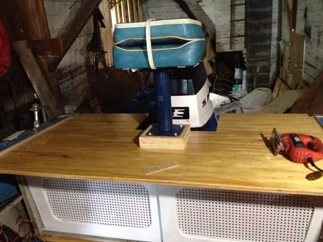

Took the boat out today and my son got a chance to try out the new casting deck. A couple minutes of fishing and BAM....the casting deck was christened....:D
One thing, I didn't figure in when designing the deck was the fact that the boat sits lower at the stern(battery/2 tanks of fuel/ and fisherman). The pedestal base should have been installed leaning a bit forward toward the bow to offset the lean angle.
I'm probably going to shim the wood pedestal base a tad to correct it.

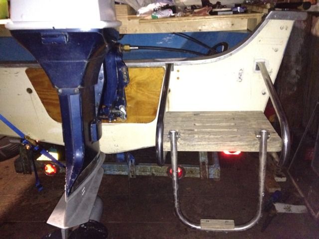

I finally hooked up my nav lights and bilge pump to switches(under the splashwell)
Relocated my fishfinder to the starboard side of the bow, so I can see if clearly from the helm through the windshield.
Found a swim platform on CL for $20 bucks and mounted it tonight. The bottom mounting holes are below the floor, so I've 2 options....cut a hole in the floor under the splashwell so I can reach in and tighten the nut. OR I'm going to have to pickup a couple toggle bolts so I can tighten them from the outside of the transom.
Swim platform will end up being painted white.

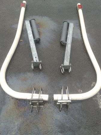

I found these and got the seller down to $65 bucks. I'll be picking them up in the morning.

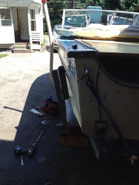

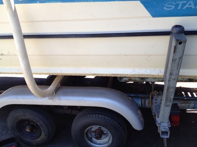

Picked up the guide-ons today. In reality, it's 2 sets of guide-ons. One set is metal with rollers....the other pair is a set of tall PVC rails.
The PVC rails are a bit short on the bottom so they don't fit well on the very back of my trailer(and the roller bunk bracket is in the way), so I'm going to mount them on the fender. Going to have to drill holes in the fender to mount them.
The roller guide-ons mounted fairly easily on the trailer frame. I had to shim the bracket so the roller came up on the correct angle to ride against the side rub rail and the strake(if that's the correct term).

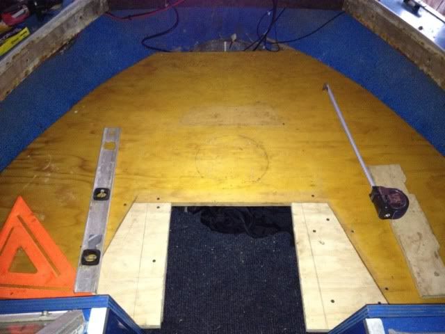

Spring is just around the corner, so it's time together working on the boat.
I pulled the casting deck so I can redesign it. I want to install hatches and mount the troller battery in the bow.
I want to square up the walk-thru opening in the casting deck, so I pieced in some wood rather than throwing the whole deck away and starting over.
Once I get the consoles out, I'm seriously considering raising them up a bit. I got the idea from the other active SS resto thread.
