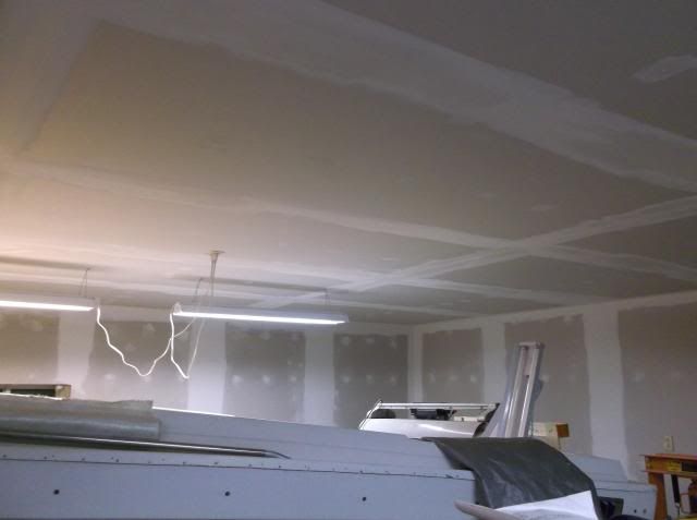

All the tape is up finally!
working on the garage door openers next...I had to relocate the opener track on the door side...so have to get the hamster spinning...but think I have a plan....
tomorrow I will do amlittle sanding and a little fairing....err I mean final smoothing of the taped seams...few screw holes need a second filling....it is almost complete!

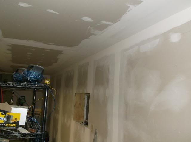

ALmost finished with the final layer of mud....
Still need to finish the windows, area around the circuit breaker box and behind the heater...maybe this weekend I can get all that done...
I tried my darndest to get the mud done tonight, but I can hardly hold my arms up over my head anymore tonight...my shoulder feels almost like it did when I tore my rotator cuff...I'll finish tomorrow...

Great looking D/W
You might want to wait a while to finish the window jambs. Depending on the quality of the window, all the new insulation & heating may cause the windows to sweat. Using wood or pre-mix D/W mud may not hold up as well as you'd like.... Might use quick set mix mud.
If you're quick w/ a mixer & the application of mud, you might try the 30min. But unless you're really good & fairly quick, I'd avoid the 15min... The quick set mix mud holds up MUCH better.
If you've got good windows & insulated the jambs, you likely won't get much if any window sweat...

Nothing like new drywall to cover up all the ugly . Makes the place seem much cleaner and brighter .. Nice job Troop ! Now let those shoulders rest ya still have to sand the ceiling .. Do you have a sand pole ? Get it all sanded and primed . Touch up , spot prime , and finish paint ...

JB, good point on the condensation...just single pane glass in there for now...maybe I'll chnge that if I run across a good deal...
SP....thanks for the reminder...more sanding lol... I do need to get a pole, will go much easier on me I'm sure...
