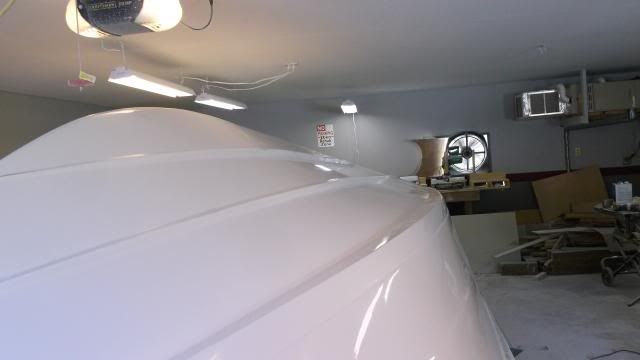

ok, 1:00 am here..I'm tired...but...I got one whole side of the boat finished sanded! first pass with rubbing compound as well..would post a pic but I am beat..

Still sanding at 1:00 am . Wow! I guess that rum had some "go go juice" in it !
They should remake the P/S song to "Still Sanding Away" just for you Troop ... :D

wooo hoo! 1 side down!
me too!
go go jiuce? more like go ahead it don't matter juice...lol...I can see where my acceptance of results in sanding was diminished!
Good rum!
Can't wait to see the results...:)
Woking on it GT...want to finish the buffing then I'll put up some pics...

Few lessons to be gleaned from this so far...
1. Should use marker between each grit on the sanding..
2. When the sander jumps momentarily to a finished spot...go over it with the remaining grits to fix it.
I can live with it. It has a few spots I will need to touch up and a few places I cut throug, especially on the corners of the chines/starkes...what ever they are called.

Man, I know that in person you are going to be your own worst critic and the tiniest little thing is gonna stick out like a sore thumb, but brother...I gotta tell you...
That hull looks absolutely fantastic!
Now that you are getting it all figured out, finish all of it, First...then go back and do your touch ups...
That way you will know exactly what and how to get them done...you will have acquired Master Jedi of Gel Coat by that time...;)
Positively beautiful!

^^^^ Agree with all of that !^^^^^
Persistence has paid off big time !! :clap2:

Have you even thought about what's next? Sometimes I find myself finishing a big part of a project with the feeling that the next phase would never come.....
Looks nice from here...

Troop have'nt chimmed in i a while but that is just pure determination! It looks great! A rig started in the south and finished in the north just remember you have all winter. One day @ a time.

Wow...it looks like just bought a brand new hull!
Bravo!

All I can say is WOW, What a great job you have done on the gel coat..:clap2:
All of your hard work is really paying off.. She is really shining now..

Many begin this journey of madness
Some manage to finish, if just barely
A few accomplish it w/ great success <<<--- You are most definitely going to be on this list :clap2:
Looking great!

Thank you Sir..that has been mybthoughts as well, grt it finished then do the touch ups...
Thanks Sam...folkslike you keep me persistant....
I have been trying to plan things, for ow I think I will do the otherside...j/k...once I finish the botom, flip her and start sanding the top ...got a surprise in store there....I been dropping some hits, doubt anyone has noticed though....and thanks for the compliment...
Thanks FF, has been a real trip for sure....hoping to get things ready to be put back in mid wint I'd say....we'll see...
Bravo!
thanks PMC...just trying to keep up with veryone elses standars....you all raise a high bar....
Haven't been posting much, I have been following along with you Trooper..
Have a great week..
Thanks Decker, noticed I hadn't seen you in awhile, hope things are well...starting see what you meant about making sure the previous grit marks are out before moving on...
Looking great!
Thanks JB...I can only hope to finish at this stage, but I am getting the worst behind me...
