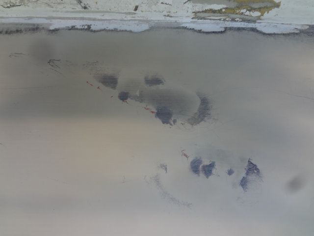

So...I tried hitting the patch with the air file..36 grit paper from HF..loaded in about .5 milliseconds...put on a second paper...added some water....fell apart in about .5 nanoseconds..gonna need some better paper...I recall from my tool maker days that Norton makes some real good sanding paper..will see if I can find some local...
Did manage to get the large areas roughed down on the one side of the boat...
Here is a spot that looks like the previuos repair missed the actual problem...
Insert another pic here...
You will notice a ghost smudge in lower right side of both pics...thought it was on the lens...nope..inside the camera..so...tore it apart to clean it...while watching a little TV...things were going fine..found the smudge cleaned it...then got a zap from a built in battery..dropped the camera and tore the ribbon cable that goes to the LCD....yikes...wife gonna kill me..Sony Camera no good anymore...

Just make sure you keep the camera away from the acetone !:rolleyes:
Sorry about the mishap hopefully you can still get us some pics somehow..

Sorry to hear about the camera mishap...
There are good grades of sandpaper, but clogging is gonna happen...sometimes the stuff that's used on the surface, has a gummy coating that forms as it cures...once it is removed, it goes better...sometimes it is just gummy till its gone...
Couple of tips...this one is a bit of a pain, but it will work as you get the hang of it...when you first put the sandpaper to the surface, with whatever you are using to back it up...whether it be a block, your hand or an air file...lightly set it on the the surface and hold the weight of it, don't let the full weight sit on the surface... run it for a second or two, stop, then flip it and use a wire brush to remove the build up...after you do this a few times, all or most of the stuff that gums up the paper, will be gone...just keep running it for a few seconds, flip, scrub with wire brush, and continue...you will get much longer life out of the sandpaper, and after a bit, you'll have nothing but happy dust coming off the surface...
Also, be warned, that this strange phenomenon can occur each time you change to a finer grit...
Hope this helps...

You will notice a ghost smudge in lower right side of both pics...thought it was on the lens...nope..inside the camera..so...tore it apart to clean it...while watching a little TV...things were going fine..found the smudge cleaned it...then got a zap from a built in battery..dropped the camera and tore the ribbon cable that goes to the LCD....yikes...wife gonna kill me..Sony Camera no good anymore... Happy hump day all...
Uh, ya home-built taser-ed yourself :facepalm: That needs to go on the never again list.
Wed is now in the bag, so hopefully you'll get some time Thurs & Fri to try GT's paper cleaning tip.
I've used Norton's before, it was great paper. But I've never used it wet. Don't hold me to it, but I suspect that an AirFile needs to have robust backing for the sandpaper, wet or dry. Specific for an AirFile maybe.... The last W/D paper I bought was green, had an unusual paper backing and was GREAT. I don't recall who's or where I got it. I'll look as I head out in a bit.
Good luck heading to the weekend.

No acetone..but then again, no camera...till I get a replacement could use the ipad or phone...
Couple of tips...
Hope this helps...
GT1M... I have been meaning to tell you I have been using the wirebrush tip and it works great...I was not aware that the gummies struck every time you change grit....fun....
JBC...Yes I did tazer the carp out of myself with that thing...like 15 times...lol...I was reading up on the paper..seems there are different types of backings...denoted with a Letter in front or behind the grit in most cases...found some that should be imposssible to tear...more tomorrow...
