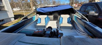

With your interior being in as good a shape as it was, I'm not surprised to see you keeping more or less the same color scheme with the carpet.
Blue is my fave color, but since my interior was completely shot AND had been partially redone, I have no idea what colors anything is going to be.
I'm actually adding more than what was there originally, but with everything sealed up, I'm not worried about rot.
I could have tried different colors or patterns, perhaps, but I'm an old-school sucker for originality.
I need to thank @todhunter for the suggestion on carpet.

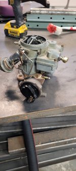

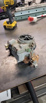

I ended up using white vinegar and only let it soak for 15 minutes. I scrubbed with a toothbrush, rinsed thourghly dried with compressed air.
I previously tried Grez-off, letting it soak for days, but it really didn't do what I had hoped. We use it at work as a parts cleaner(environmentally safe).
I'm very happy with the results and will rebuild it..🤞
Thanks everyone for your input.
Well it's rebuilt and came out better than expected and will give it some paint when it warms up.

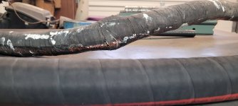

I wanted to bring up a subject and evidence that if you have an older boat, don't neglect your fuel hoses. I gave each one the flex test as I hope you can see the old one was horrible; even the wire reinforcement was rusted badly.

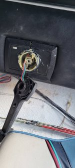

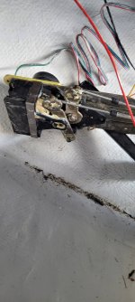

I figured out how the controller comes out, much simpler than expected. I greased all the wear points, hopefully extending its life because the plastic bushing under the lever is very worn.

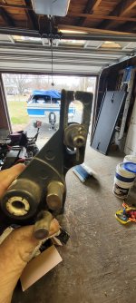

Today didn't turn out as well, as I hoped.
I was working on the shift cable that continually had play in it, so I was repeatedly trying different things and low and behold the arm broke because the nut locked up.
I used the tools at the belcrank and up by the ESA but still had play which I am thinking it's from the worn our controller plus when in gear I get alot of back and forth on the propeller which from the videos I've watched they didn't have.
I found out my anti-siphon valve was gutted.
With all of this happening, I resorted to rewiring this birdsnest of wiring for the sending unit, blower, and bilge pump.
