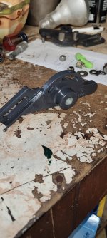

Well......after calming down, I got to work ordering what I needed.
I found the lever(good price) and the pin(expensive), but all needed, so I was able to get them at least being OMG.

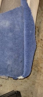

The carpet arrived today and the color match is exact with my bad eyes ๐Ÿ˜‰ but the weight has to be no less than double the original.
I also received the shift levers (gave me 2). The other items should be here Mondayish.
I also have my eyes on a couple units for the sterndrive, hopefully news upcoming.
If anyone is interested in my carpet source please PM me, this is thanks to the @todhunter .
I hope to remove the drive this weekend in preparation for the other parts.

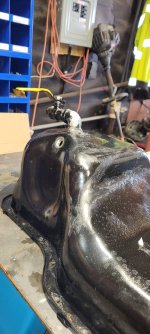

Well since I had to pull the drive to replace the lower cable I thought well I might as well install my oil drain, believe me I really didn't feel like taking these steps backwards but oh well.
I will end up putting a lock on the valve so it doesn't open accidentally and a 3/8" barb so I run a hose out the drin into a catch can.
I also wanted to mention that with a lined up drive it slides right out with no binding so if you have trouble you know it's misaligned and you know what needs to be done ๐Ÿ˜Š

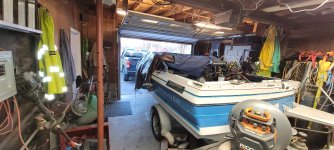

Just give an idea how small my garage is! I need a go fund me for a bigger garage! ๐Ÿ˜‰

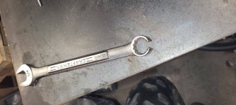

88 Capri (2022 SOTY)
Master Chief Petty Officer
Aug 25, 2019
850

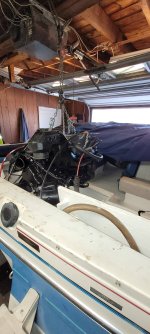

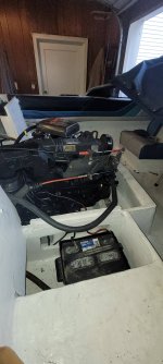

I installed the new lower cable, shift arm and pin which really made shifting smooth and easy. I did find that the other new cable had something wrong internally which was causing alot of my adjusting issues, it still took alot of time and patience due to the slop in the controller and lower unit but I am satisfied with the results. I had one setback while doing this, I had to pull the engine again because with the bend the cable has to make due to the engine it wouldn't make the bend in the hose it runs through.
I had to sacrifice one of my wrenches to get at the fitting for the lower cable by the bellows.
I am going to take a guess that the wear on the controller and probably lower unit are due to a long overdue lower shift cable replacement.

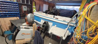

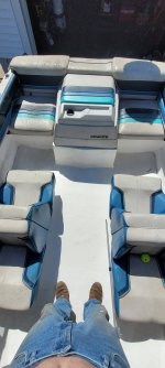

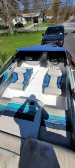

What a beautiful day, long time in coming!

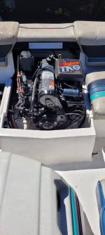

All mechanicals and wiring are finished, still need to go over the trailer but should be minor compared to everything else ๐Ÿ˜†.
I may or may not start the templates today, just satisfying to be at this point.
