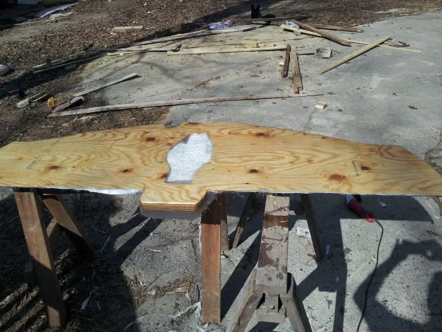

Haven't covered it yet, but I did 'putty' it with pb. Its curing now, will cut out keyhole and seal with csm mon

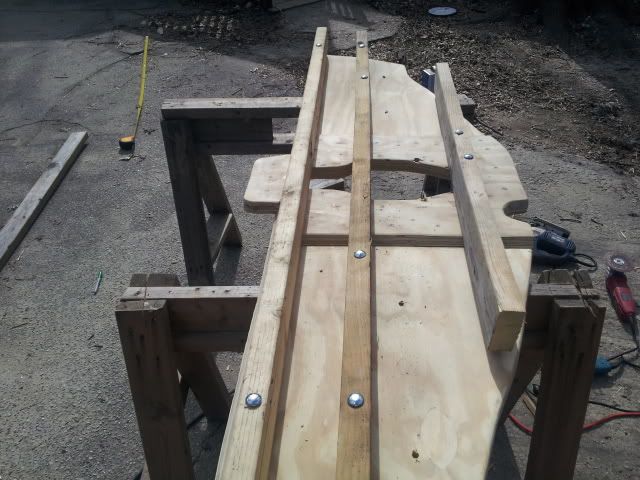

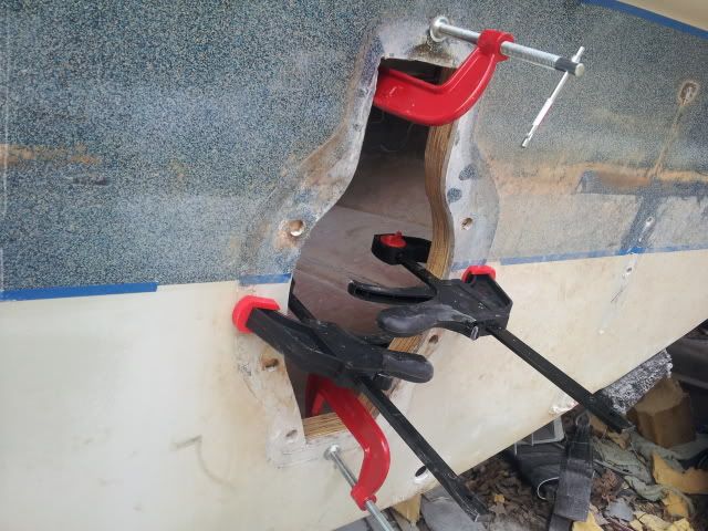

Woo hoo! I cut out the keyhole first. Got it clamped in place with that matching up, now I'm about to drill out the holes for the brackets to the swim steps I had on there. These will be perfect for installing my clamps while the transom glue is setting. Once I get that all mocked up I'm going to coat the transom, let that tack, then put a layer of csm!
Two questions. About how long will it take to tack up at 1%, and how much resin do you all suggest I mix at a time? I don't mind having to stop and mix more, I just don't want any waste. I would love for the 20 gals I bought to do it all!

3-4 qts of PB to glue it in and make your fillets. I'd recommend having a Helper so you can be in then boat applying the PB and when you get close to being done with one they can mix up the next and hand it to you. You have at the most 20 mins to have it spread and in place and clamped up. Also make sure and do a couple of DRY RUNS first so you have the actions all down on how everything is going to go. Since you are cutting the key hole and bolt holes first it MUST align perfectly when you clamp it home or you will be doing it over. 20 mins goes by fast when you are under stress. Plan Plan Plan!!!!

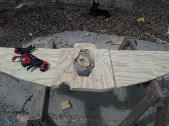

I would have loved to cut and drill after it was in, but I see no way I could have done that. I cut the key hole and lined it up, then clamped that in place. Then I drilled my bolt holes from the outside. Set everything on my sawhorses and cut the clamp pieces to fit, then drilled the holes in them to match the holes in the transom. I had to drill them a little oversized because my holes are not perfectly square so they were working against one another. Now it all fits up fairly well. I will have to rush to get it all troweled on and clamped in time!
I had to apply some more pb because some of my thru holes splintered the transom. So I will try to do a layer or csm tomorrow!
