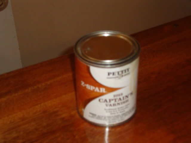

The wife left me a list to do BEFORE I work on the boat. Wash the vertical blinds, wax the floor.... no mention of spar varnish anywhere. Maybe she forgot??? I'm not going to push my luck, she's been realy busy and I need to man up. Gotta run there's a bottle of future wax with my name on it.
P.S. Seats have 2 coats of spar on them, got pics too. I'll share them in a minute. They look spiffy, not perfect but nice, you have to get right down on them to see the imperfections.

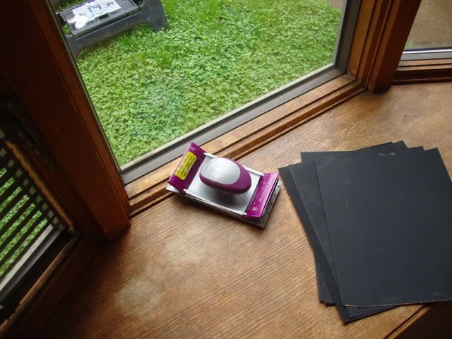

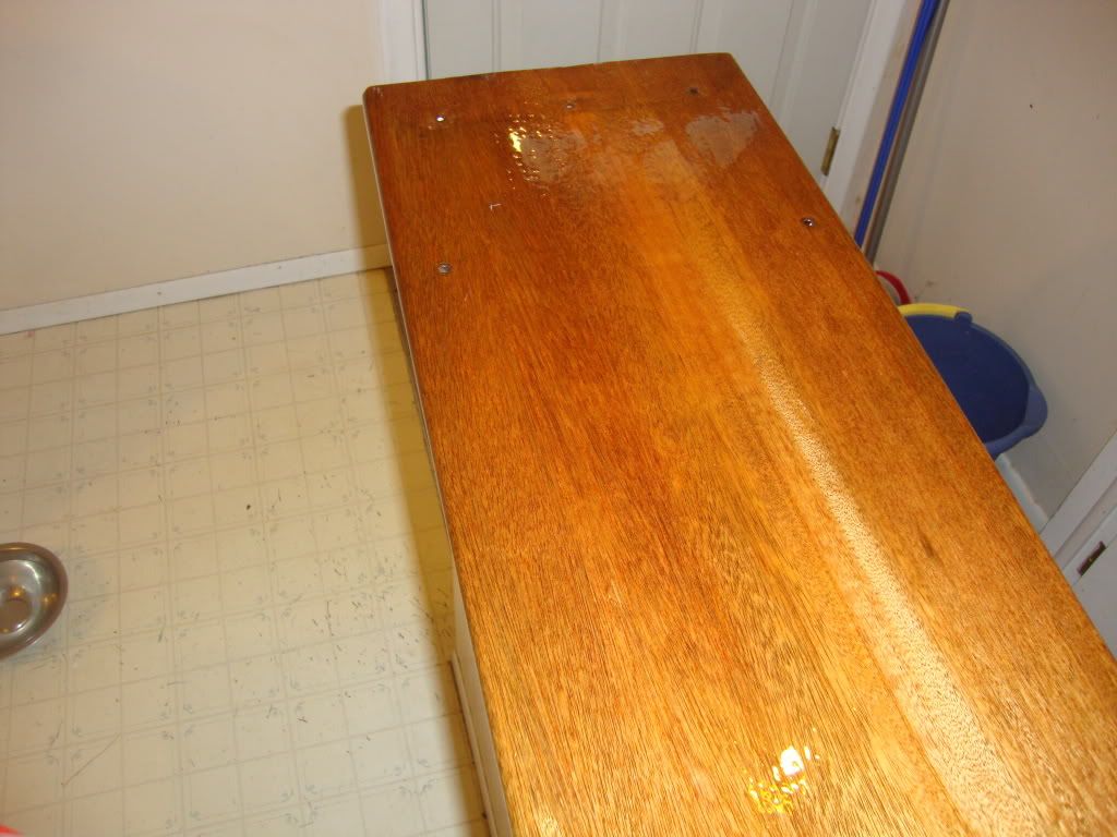

Bought this sanding block. It works really good, a couple of minutes I can wet sand a bench down.
3 coats of epoxy and 3 coats of spar.
There are the pics guys. All varnishing is done! It looks pretty good, not perfect but really nice.

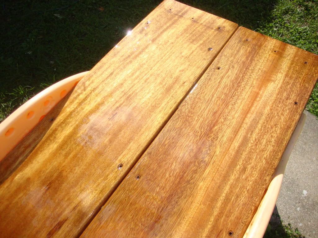

Sorry no updates in a while. Karate, Cubscouts and homework have taken their toll on the Sea Scamp. I did manage to hang the lights on a bracket I made in the shop. One less problem anyway.
Re-varnished the seats, for the last time. They look pretty good, not perfect but really nice. The last coat I used a foam brush on them. That's the way to go, cheap brstle brushes leave a streaky finish and always drop hairs in the finished product.

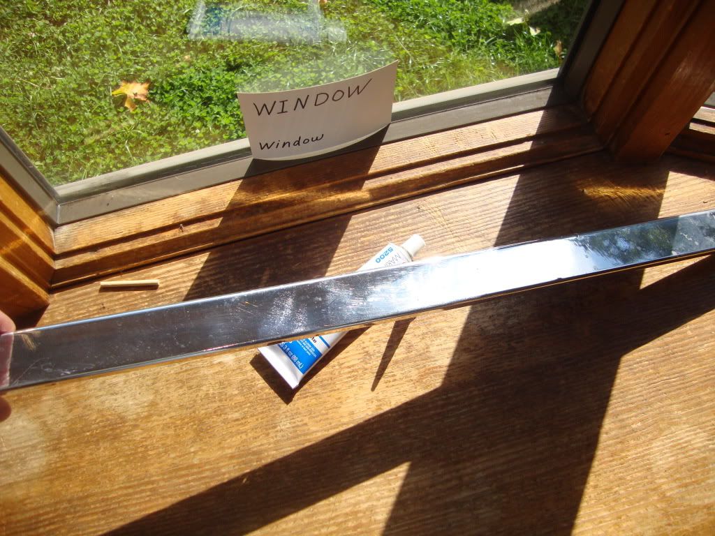

Polished up the piece that goes over the transom. Took it into the shop and had my buddy hit it on a wheel with some rouge.

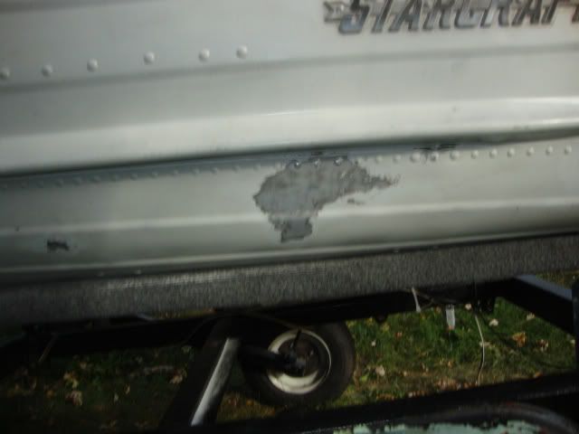

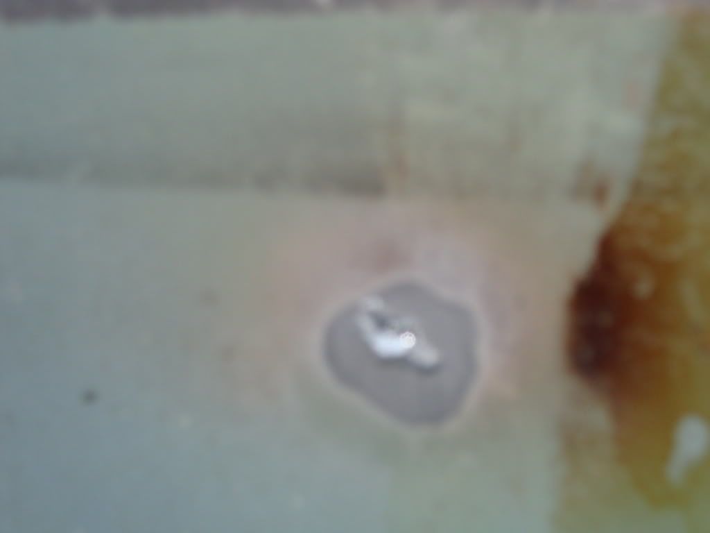

The previous owner had put a funky partial transom in and drilled 4 new holes in the boat. Two below the water line!
Bought me some HTS-2000, aluminum brazing rod. Attempted to fill in the holes, using a propane torch and the rods. I couldn't get it to stick. It looks so easy in the videos on their website.
http://www.aluminumrepair.com/video_new.asp
After some research I figured the propane wasn't hot enough. I got a map cannister instead. It worked. The key is to get the base metal really hot, 750 degrees Fahrenheit. Then melt the rod on the base metal and apply a Little heat to the rod too. Everything needs to be hot or it won't work. It takes some practice.
Inside shot:
looks OK. I need to file or sand it down. After cleaning it up I'll give a full assessment.

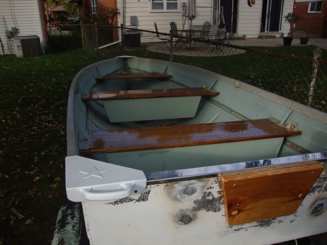

Thanks for letting me vent heyyou. You've been there so you can understand. Now onto the Sea Scamp:
It's ready for the water. Not pretty on the outside but fishing is on the agenda for Saturday morning!!! Zach saw my down vest on the the other day, he asked a bunch of questions and decided he'll need one for fall fishing. I plan on using the boat until mid November.
Seats installed and fully functional.
