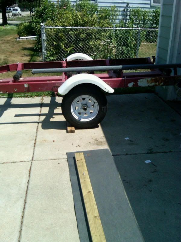

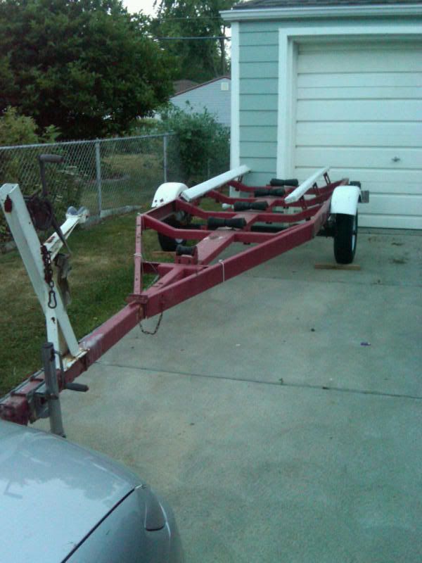

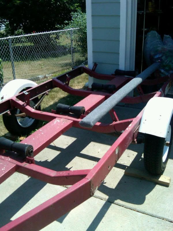

Finally found a buyer for the 18' pos fiberglass boat that was on my new trailer! I sold it for $100 if you can believe it! So with it gone I finally had a chance today to replace the bunks, bearings, wheels and tires. I think I have all my measurements right??? We will find out when I make the trip to the ramp tomorrow to swap trailers. I decided to set the bunks to the outside of the strakes rather then the inside so the boat might be easier to load and trailer more stable. Like I said before, we will see when it comes time to swap them.
Here are a few picks

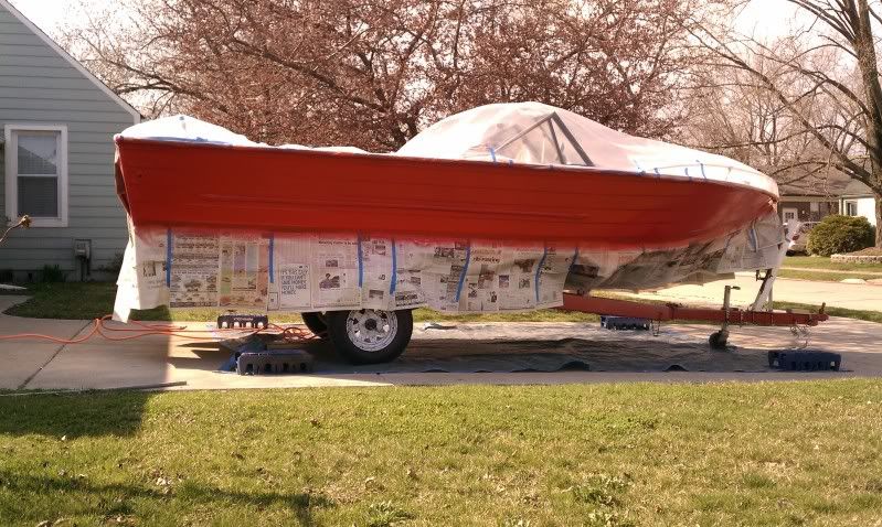

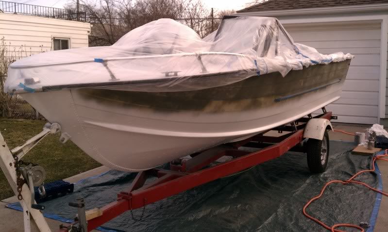

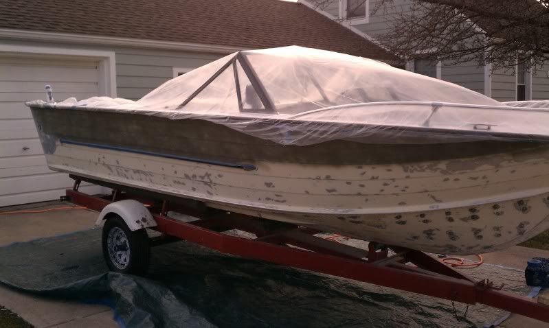

Hey guys, haven't check into the site in some time and just thought I'd update everyone with some photos. We've had some incredible weather this spring in Detroit, so I decided to get a jump start on repainting the hull of the SS. I decided to go with a red and white two tone and I really think it turned out well.
Here are a few progress pics.
