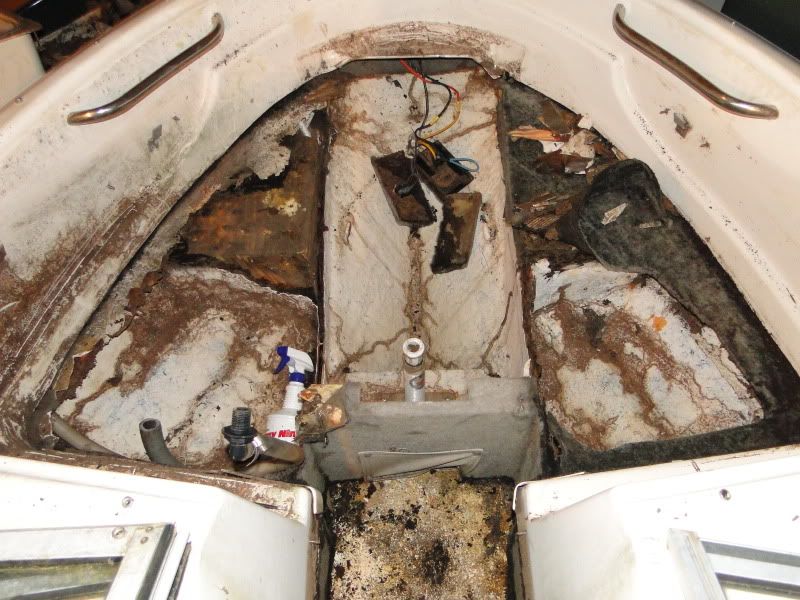

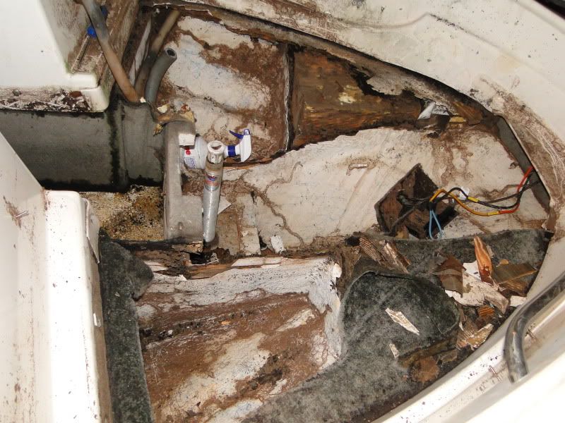

I don't know if this will help or not... I'm just starting a 95 17ft capri project. Here is the bow portion of my boat without much ripped out. Mine had a live well in the bow section. I don't know if yours did or not. Either way, you might be able to get an idea of where the stringers go.
Hope this helps! Great job on your boat. I'm going to be referring to your posts a lot in my project.
