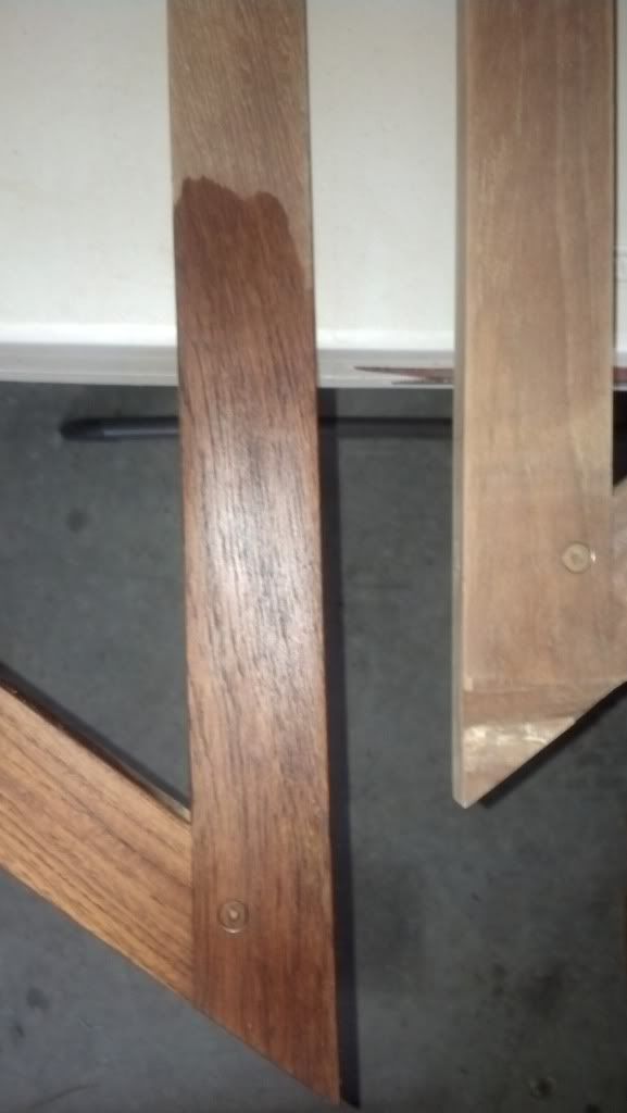

mineral spirits after the sanding
I'm leaning towards just oil. Never has had any finish on it why start now?

Try this and see what you think. Tablespoon of Boiled Linseed Oil (Or Tung Oil), 2 Tablespoons of Mineral Spirits, Tablespoon of the Varnish of your choice. Mix well and rub on. I think you'll be amazed. This will seal and protect the wood LONG TERM.

thanks i might test that if I do decide to finish. It's been unfinished for 35 years so may decide not to.

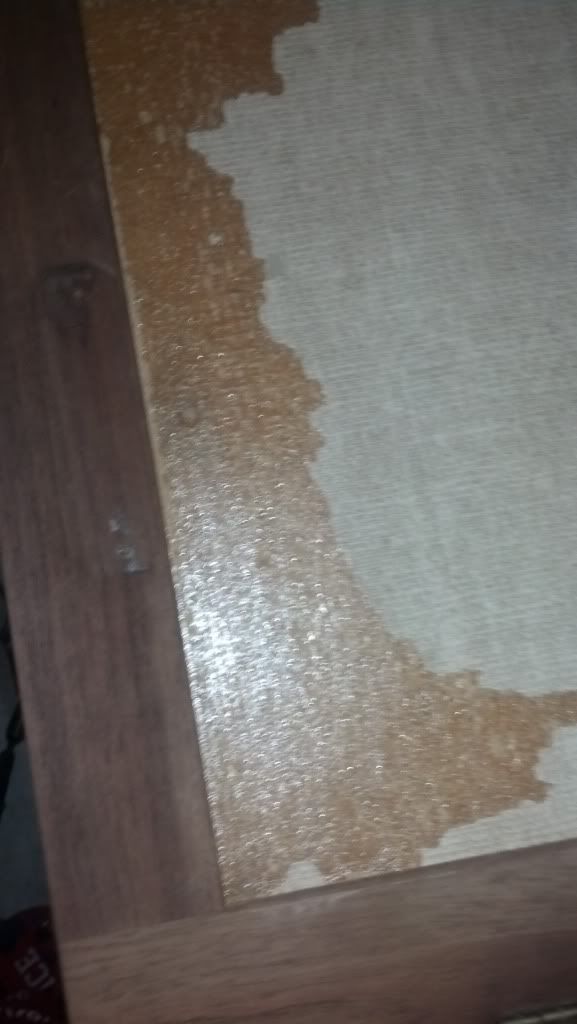

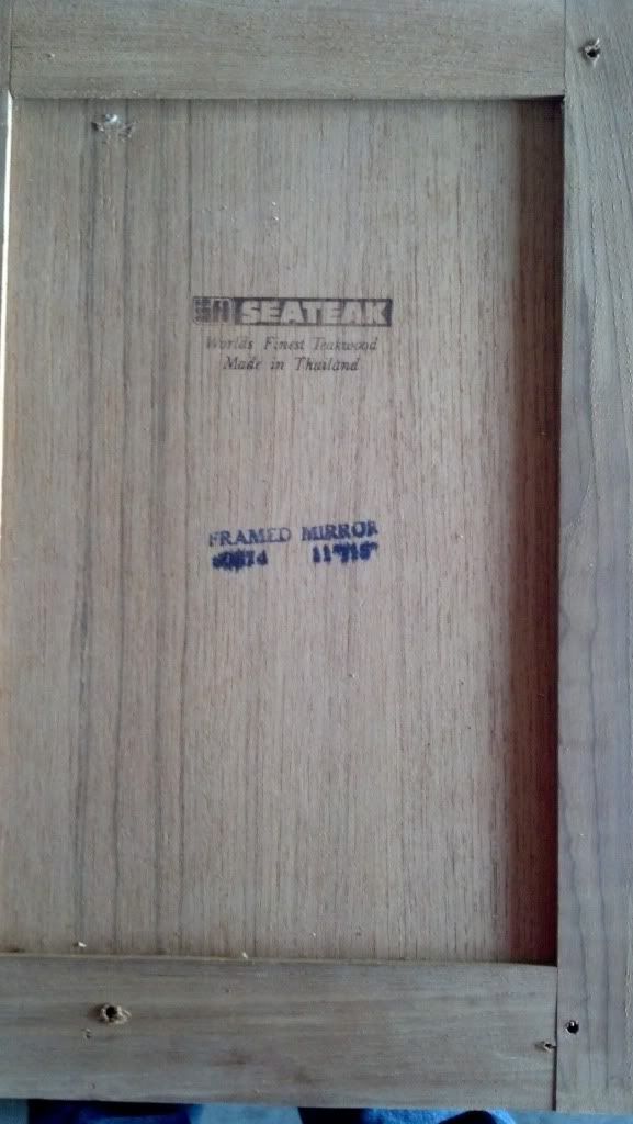

ok - the 'wallpaper' on the head door that had turned loose came of easy. The rest of it...
Thinking - not sure I want to put a mirror on and of course no good looking wood underneath even if I felt like trying to remove the rest. What about a piece of luan (floor underlayment) glued to the panel, stained to match the rest of the wood?

well 15 minutes with the wife's hairdryer and all off.
images
still need to decide on what to cover with

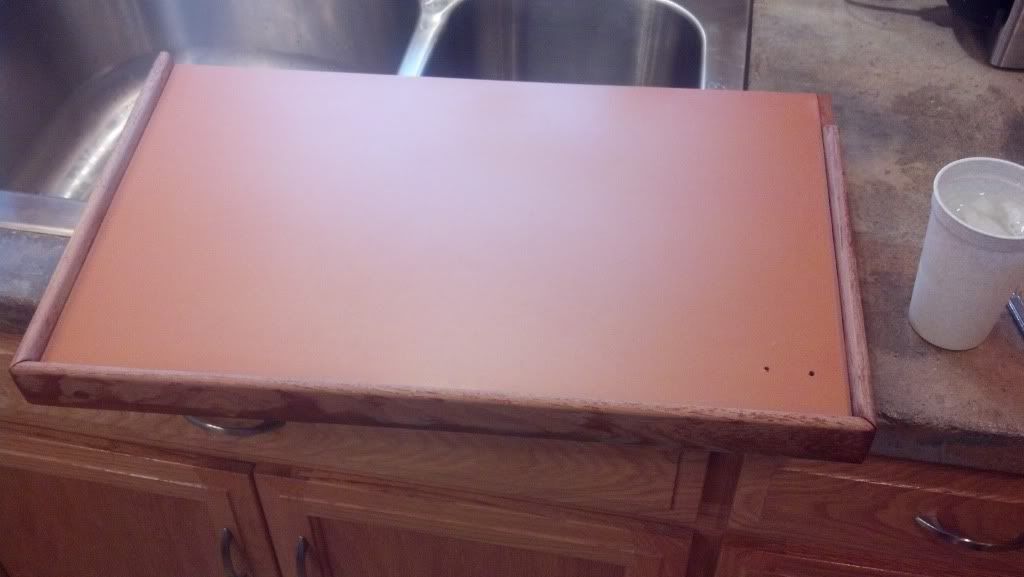

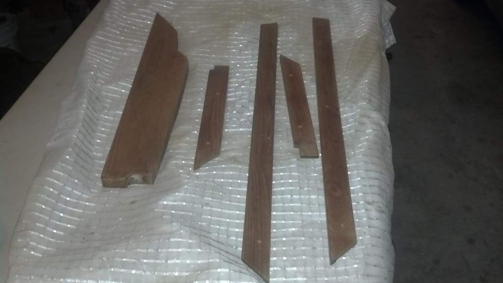

I really thought I was going to have to replace these they were so nasty. 30 minutes with paint thinner and some glass top stove cleaner they look almost brand new.

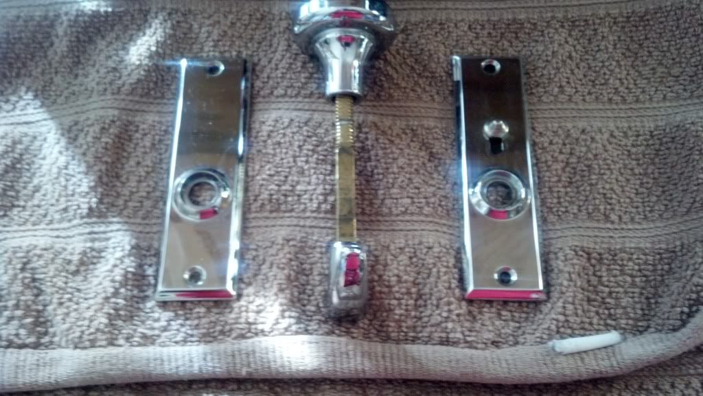

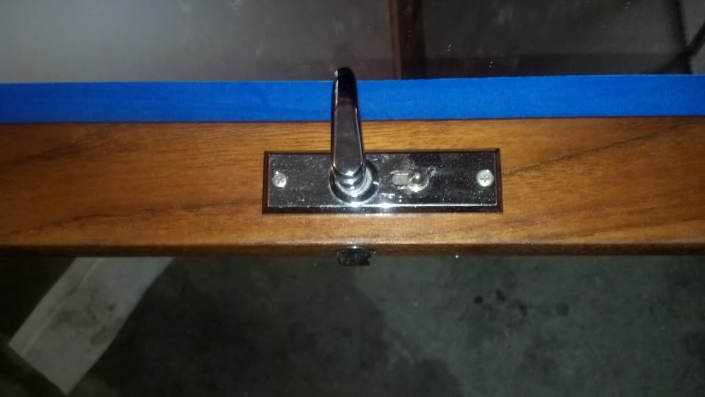

the head door is complete; hardware back on

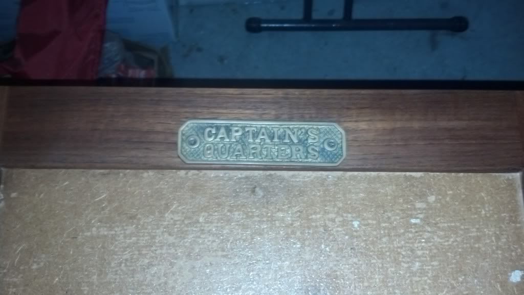

and the 'entry label'. Didn't polish it up - I like the old brass look.

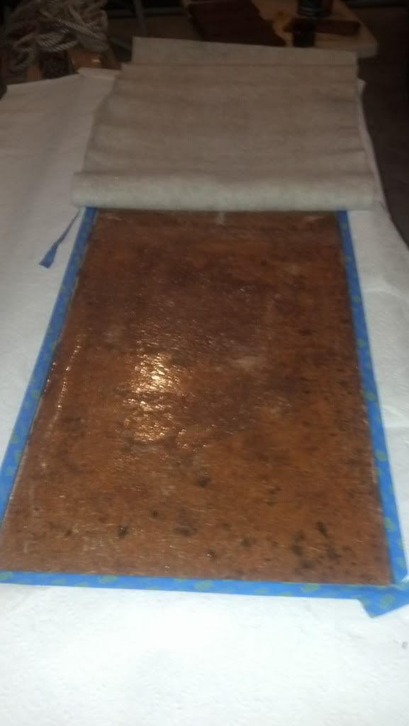

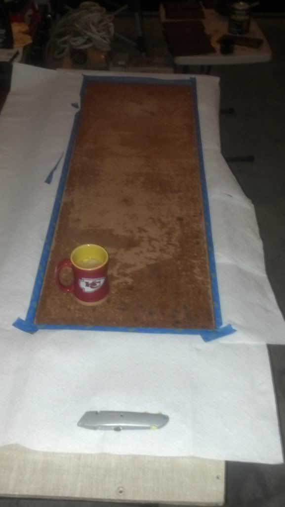

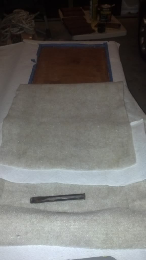

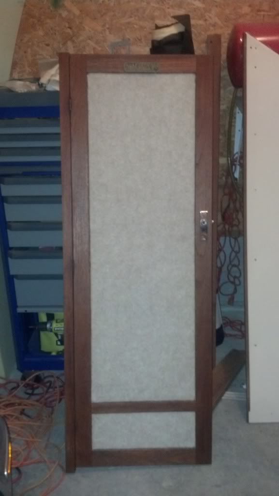

On the door to the head, I pulled off the 'wallpaper' and have been thinking on what to replace. Didn't want any mirror - there is already one on the other side of the door in the head. So i decide to put on the same headliner material as the new headliner.
redneck joe
Mar 18, 2009
14,979
Re: Carver 2357 Montego
one side of the glue getting tacky
redneck joe
Mar 18, 2009
14,979
the other side getting tacky (and my drink needed a re-fill)
redneck joe
Mar 18, 2009
14,979

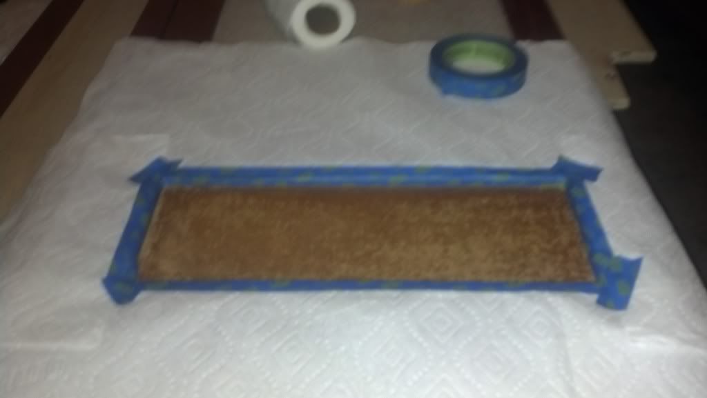

paper towel/blue tape is to cover the adhesive over-spray
redneck joe
Mar 18, 2009
14,979
and the final product.
my first time but it was a lot like cutting in window screen which i have much practice at.
