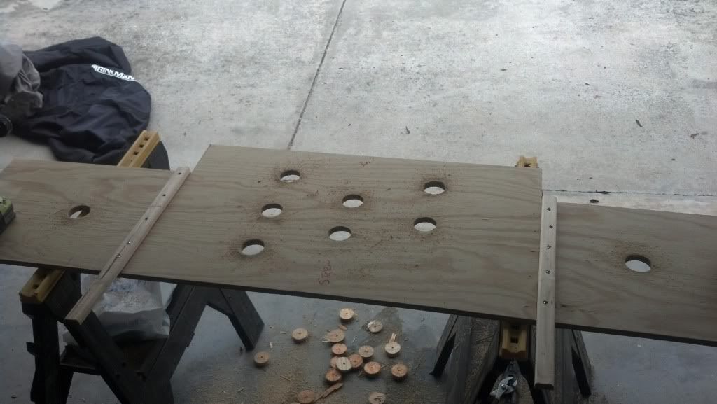

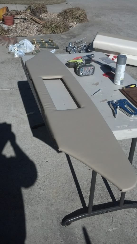

and the seat bottom
re:holes
(very) nominal weight reduction mostly air passage for moisture control..
I'll be putting mesh on the backside to finish them off so you wont see them.

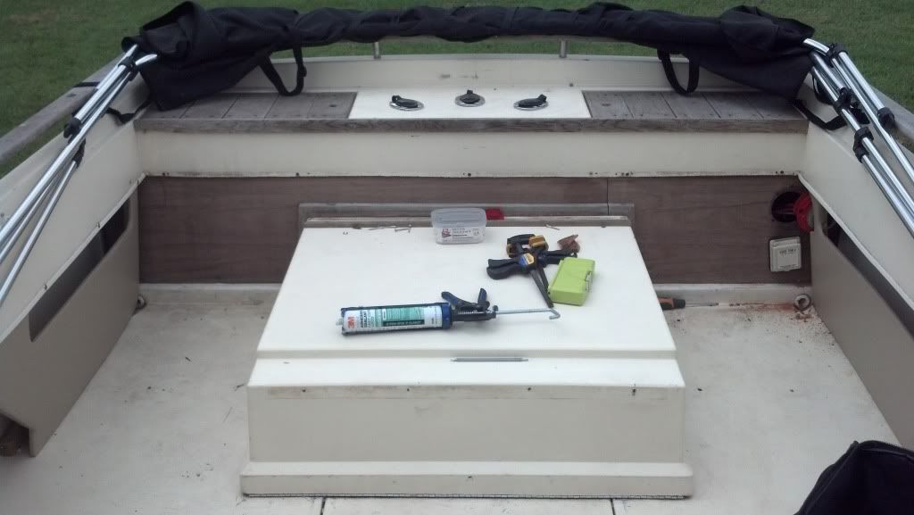

the fishing will occur here (without the rolled up bimini and the tools
oh and one thing that doesn't show very well in the pic - notice the two new side panels with the pockets in them. That is where the bench seat will rest but also i have them at a 30 or so degree angle - basically you have a toe kick so when the big un's hook you have a better stance.

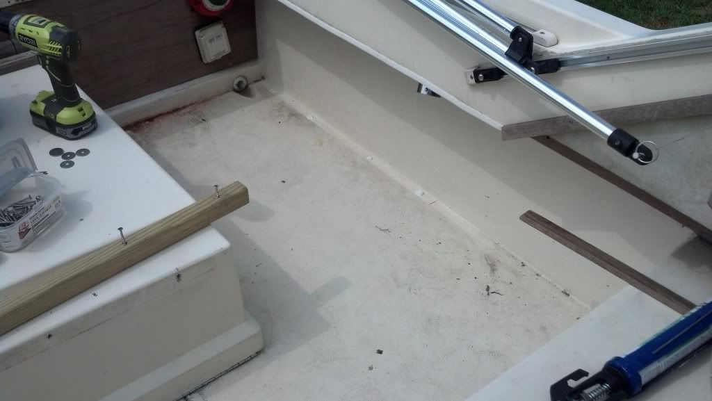

every deck screw got some 4200 love.
and not a great pic but the new side panels are screwed to a treated balluster - but even though treated I put 4200 donw, then 4 washers to raise the wood off the floor for drainage then screwed tight.

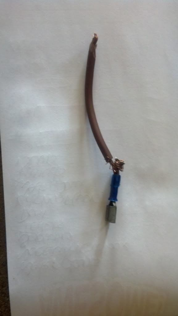

so how is this quality?
fun to find this stuff...
note the end that looks like where i cut it off was actually where someone had taken a knife and trimmed the sheathing and tapped in another wire; the accessory switch was powered off this one. This was the wire to the anchor light
never ceases to amaze me.

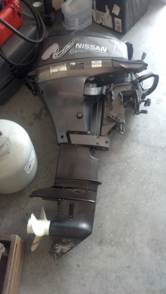

did the deal on the 15hp. $650.

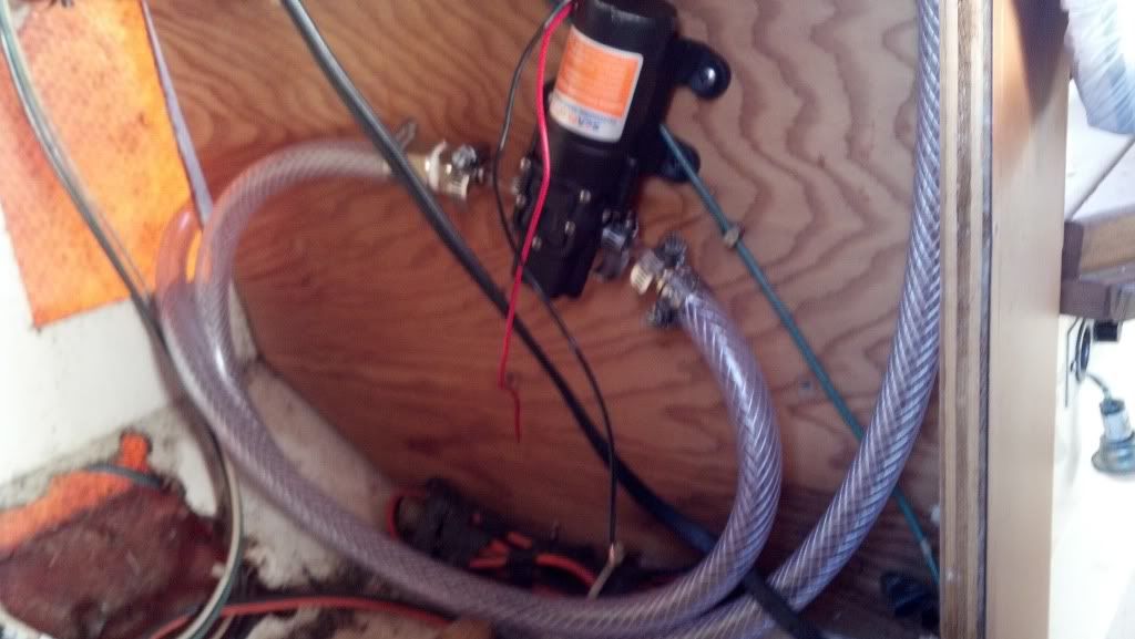

got the water tank all hooked up going to leak test today (headed to the lake taking a day off) and also got the water pump in. I put the pump behind the fridge just under the sink. Don't think it ever had one; the faucet is a pump style so not sure how it will work with the pump. Now going to pull wire to the fuse panel and get it running.

apparently the old one has a lid that was too small for the thread to engage (think pumping out when they find the right size nipple) so they 'sealed' it off with what appears to be plumbers putty

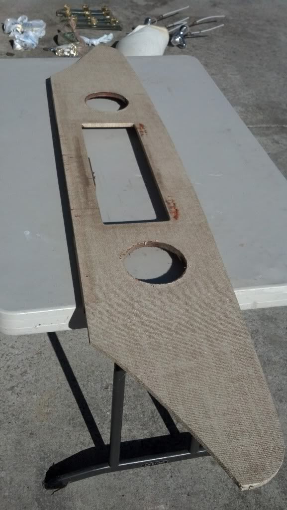

the faucet is in such poor shape it won't completely shut off so i ordered:
cool this morning. Long sleeves, pants goggles and respirator...
got most of the 34 year old glue off; ab out 1/4 more. I wonder whats in that ****.
New headliner getting closer.
85% of the cabin has been cleared of old glue. Need to get to the big boat to get some supplies need to replace two small port windows to get water tight in the sleeping tubes.

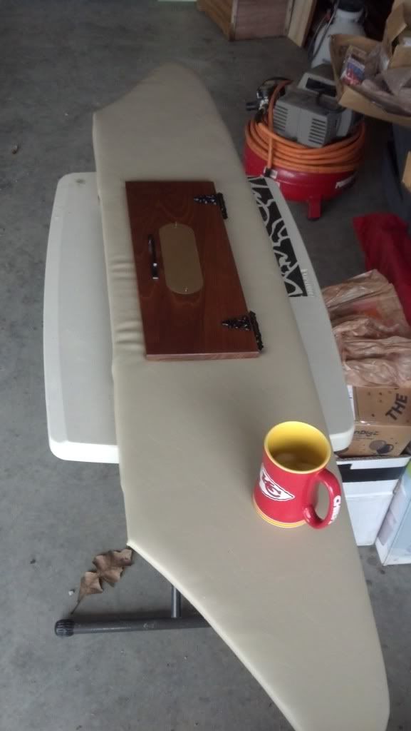

the old
the new (wrinkles at the bottom have been fixed)
the door for the opening i've sanded and am up to 6 coats should be done with that today. (its the bulkhead at the v-berth.

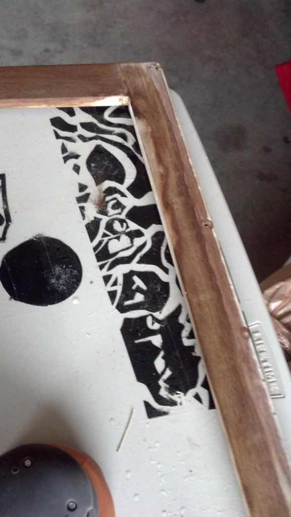

the four window frames have some light staining and calcium build up from the leaks. I'm sanding them.
Should I use some helmsman or just oil them up? Right now the only other thing with helmsman on it is the hatch to the anchor and the entryway outside.
